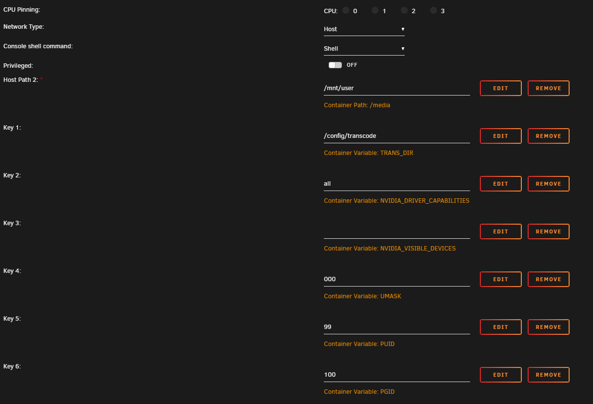

I am pretty new to Unraid and basically I wanted just a Plexserver. Since I had an old, but working MSI Geforce GTX960 I put it in my server.
I have the plex docker up and running. I also installed the nvidia drivers, the card shows in my dashboard. I heard that I could use the nvidia card to transcode in order to not push it all through the cpu. But plex does not use the card.
If I am right under Container Variable: NVIDIA_VISIBLE_DEVICES I should select my GPU, but it is blank. Am I missing something here?
I appreciate any help I can get on this.
Thanks.
First, click on 'Plugins' tab, then click on 'Nvidia Driver'
In there you should see 'Installed GPU(s):', one of those in the list should look like 'GPU-xxxxxxxx-xxxx-xxxx-xxxx-xxxxxxxxxxxx', copy this line into 'Nvidia Visible Devices'.
Once you do this, the GPU should be usable in the container.
Thank you for replying. Any need to restart? it doesn´t seem to change anything.
As long as Hardware transcoding is enabled in PLEX and you pressed 'Apply' once you pasted the GPU GUID in the NVIDIA_VISIBLE_DEVICES, it should work.
