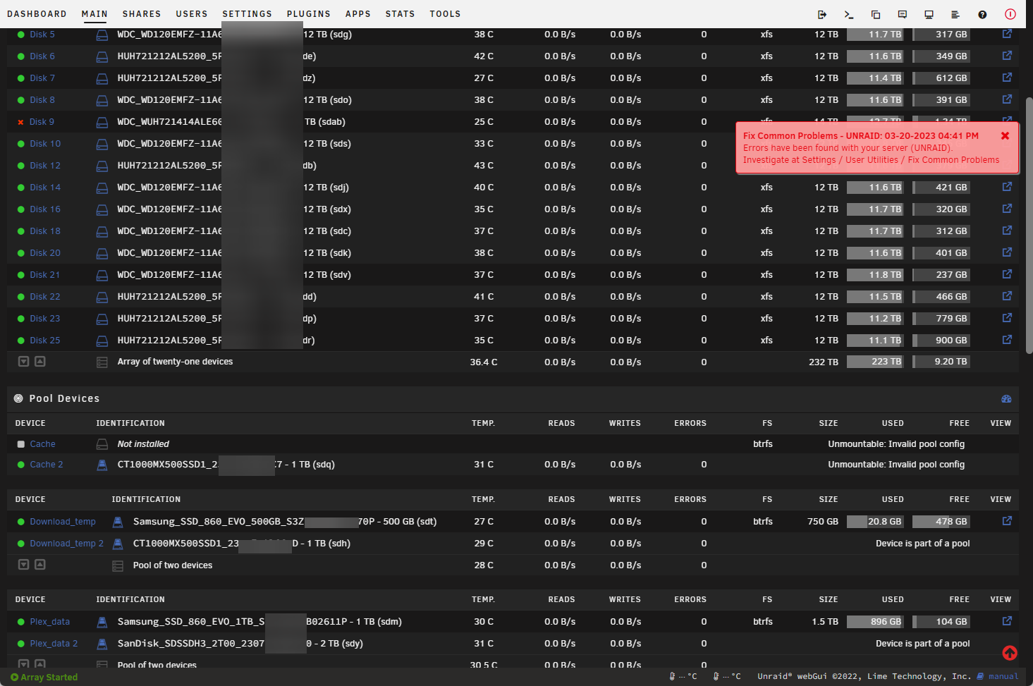

One of my cache drives (2 total) is failing. So I went to replace it now I'm getting
"Unmountable: Invalid pool config"
I've tried setting the failed disk to not installed, start and stop the array but doesn't seem to matter what I do I can't get this to start again.
Any ideas?

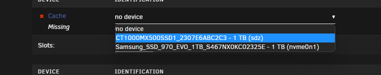

So if I remove the cache pool and create a new one with a single drive, it works fine. As soon as I add a new 2nd drive I get the same error. Even tried formatting the new ssd before adding it to the cache.

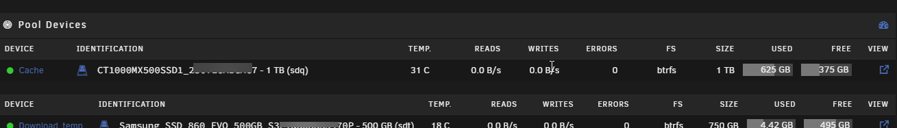

Here you can see the cache pool is working with the single disk (sdq)

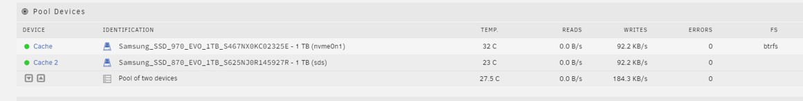

This was the original pool:
I replaced the 870 EVO (sds) with the CT1000MX500SSD1 (sdq) about a week ago. Everything went well.
