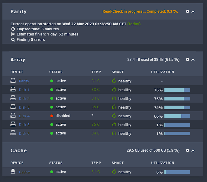

Hi have one disk with a Device is Disabled, content emulated.

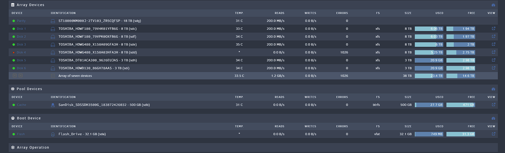

The were some errors that made the UDMA_CRC_Error_Count went up to 5 but it also reported 1026 write errors. I've read this is likely due to sata cable rather than the disk itself.
I run an extended SMART test and it came back reporting no errors (attached to the post) so I stoped the array, removed the disk, rebooted and readded the disk and started the array.

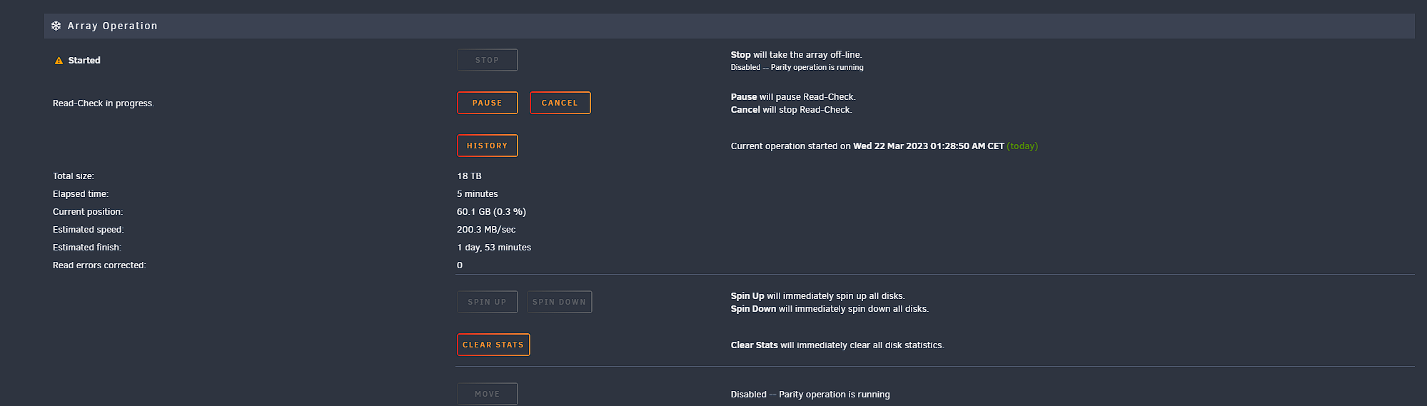

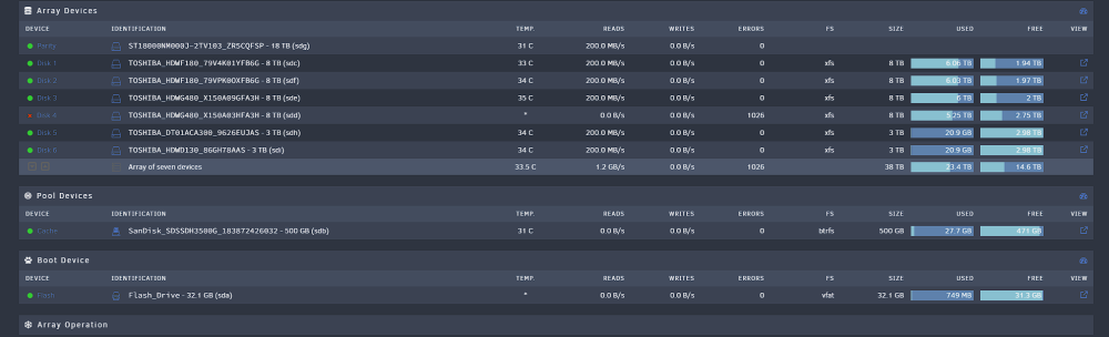

At this point I was expecting the disk to be rebuilt. Unfortunately upon starting the array again the disk went straight to "disabled, contents emulated", attributes and capabilities on the disk now appear empty and the array seems to have gone into a "Read Check". I'm not able to stop the array and I'm not clear on what's going on.
Any recommendation on what to do? I assume I must let the read check finish and then ... will the disk be reconstructed from parity? Should I just go ahead and replace the disk immediately or will the system recover after the "read check"? Can someone advise on the result of the test?

Disk dropped offline, but it looks healthy, and there are UDMA CRC errors logged, so replace the SATA cable and try again.
Thanks a lot @JorgeB
Can I stop the read check or should I let it complete? It's still another 20 hours to go :)
You can stop.
