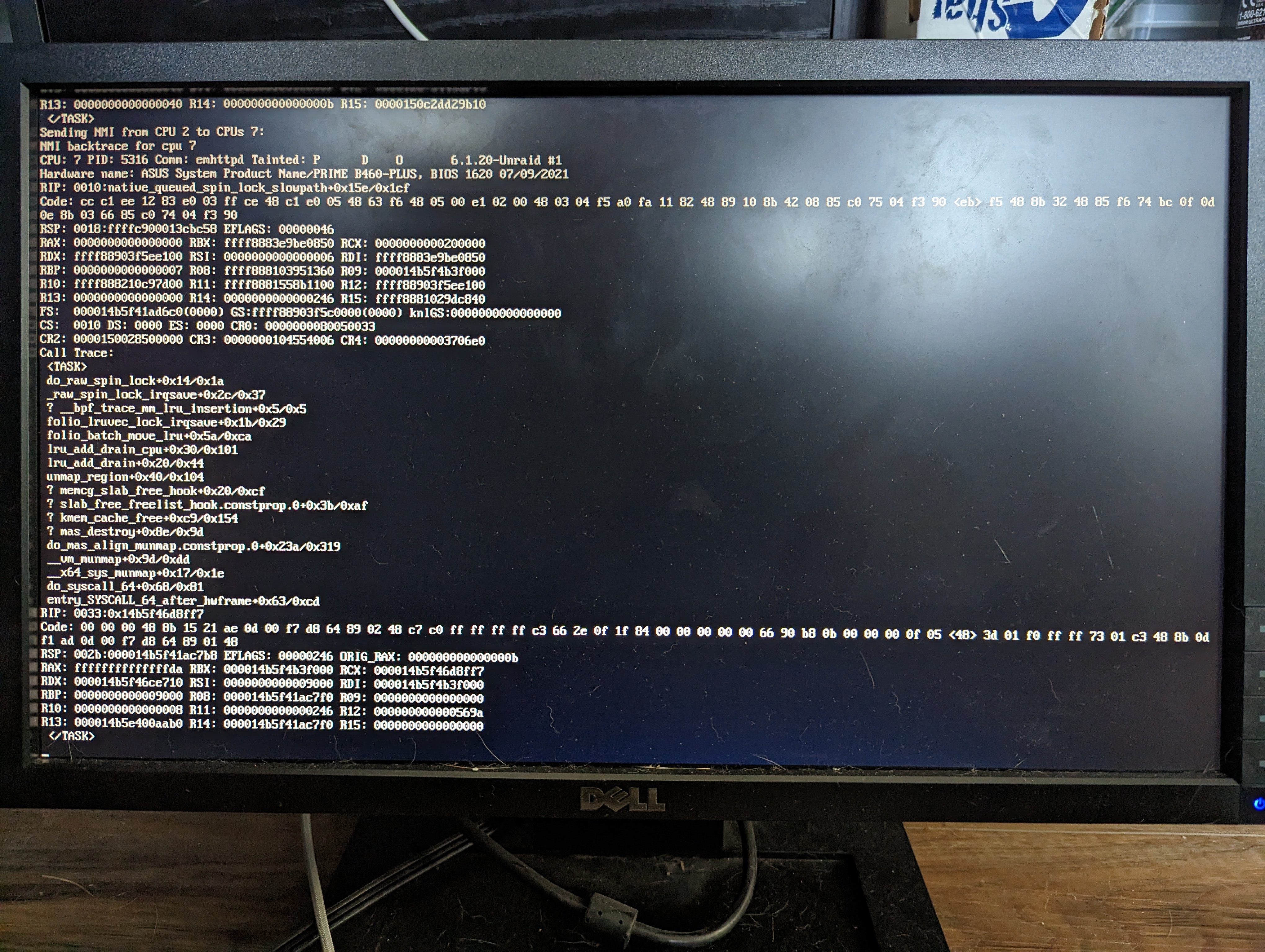

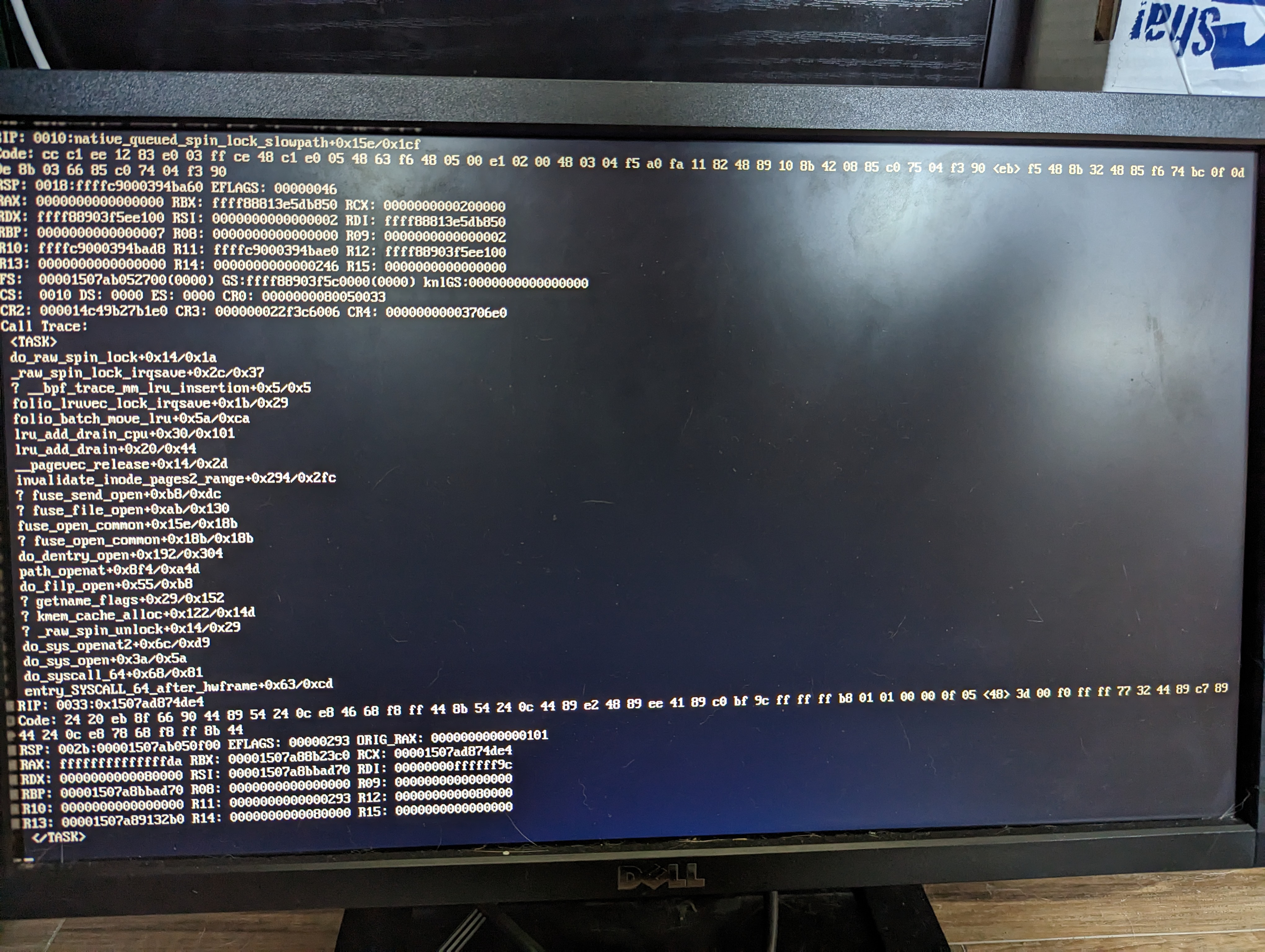

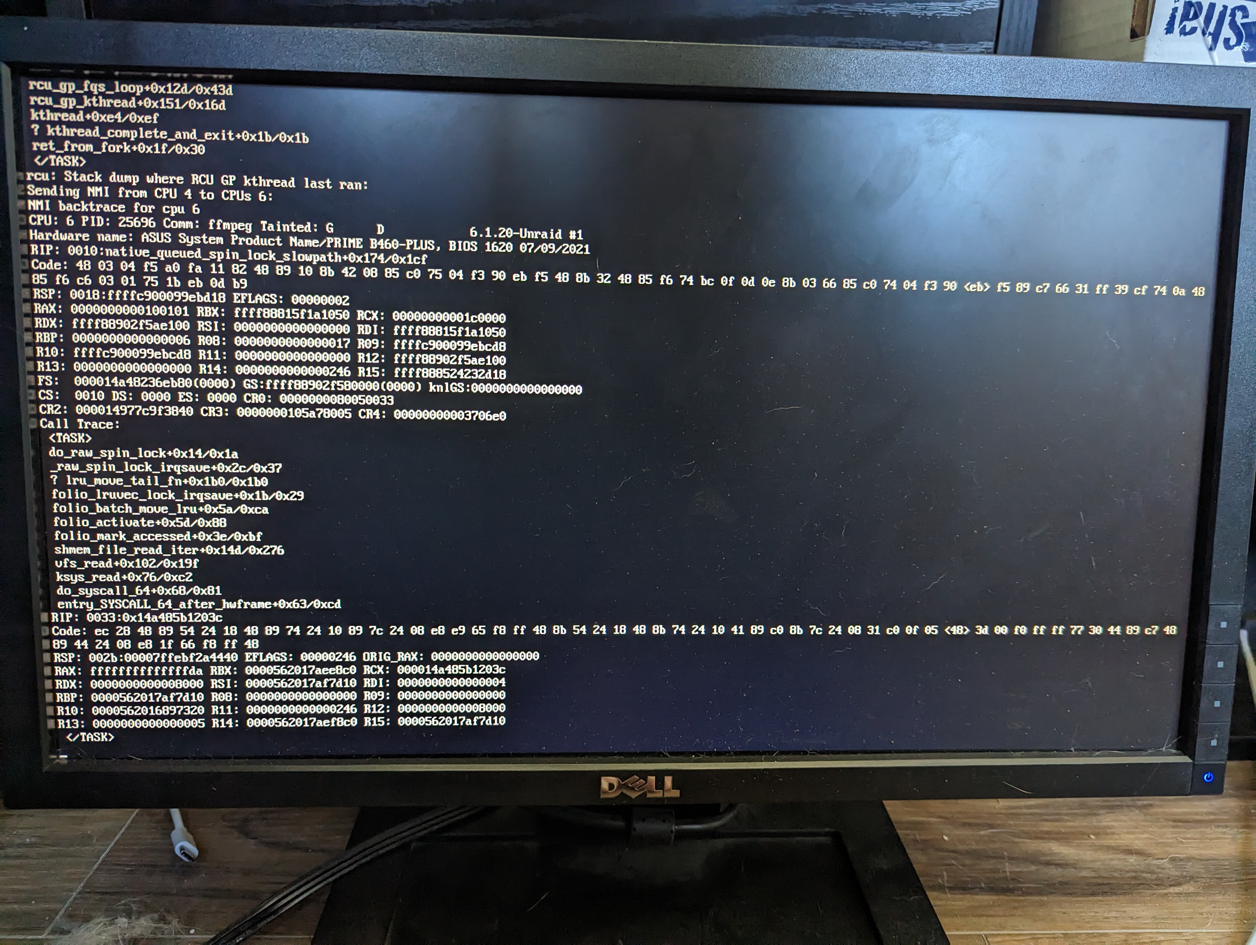

I have syslog running, but cant really see anything in the syslog after a crash. I have taken a few pictures of the screen output during a crash, but am unsure if that is helpful at all.

There's nothing relevant I can see logged, this usually points to a hardware problem, one thing you can try is to boot the server in safe mode with all docker/VMs disabled, let it run as a basic NAS for a few days, if it still crashes it's likely a hardware problem, if it doesn't start turning on the other services one by one.
