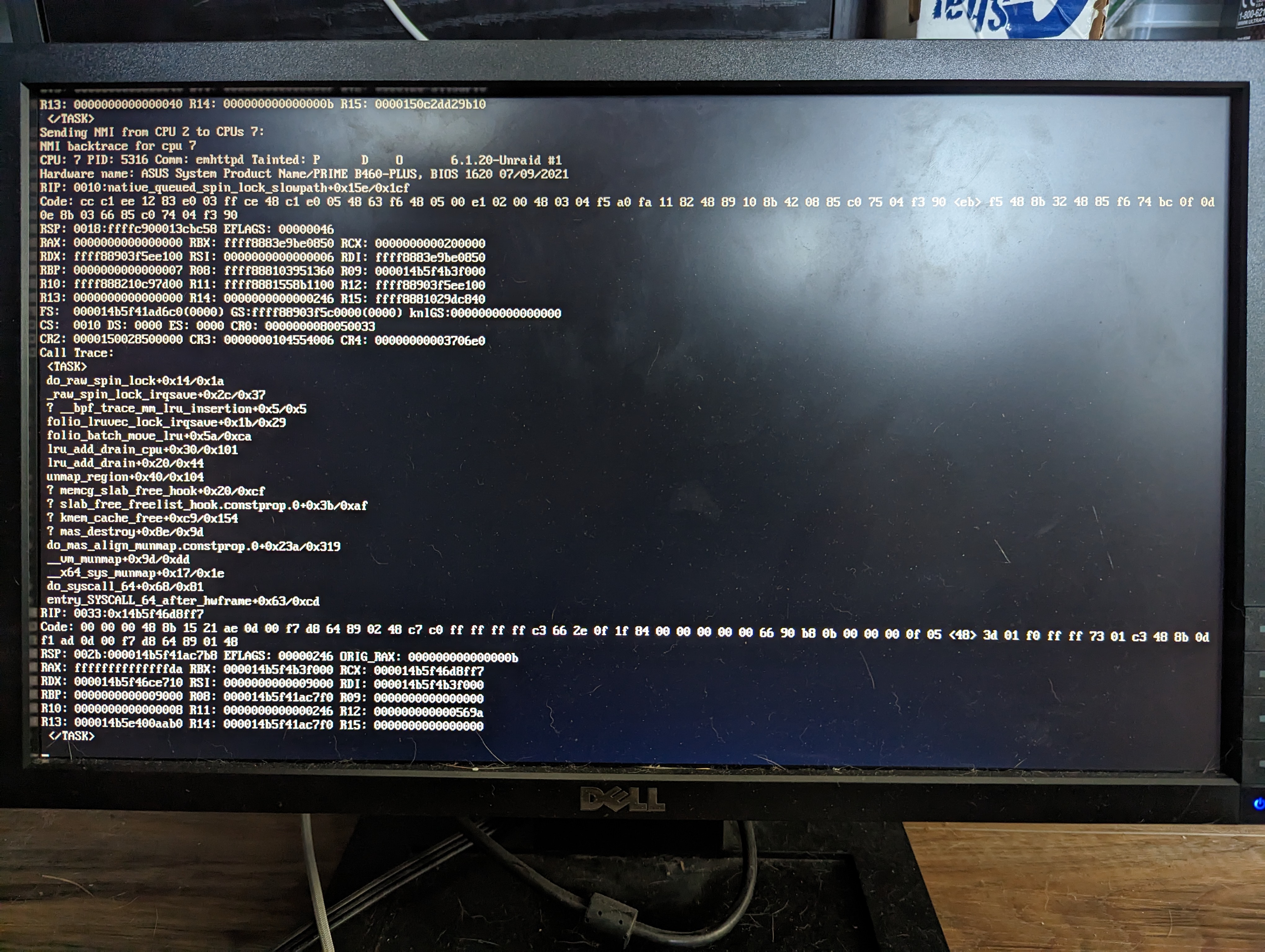

  12. Okay, so I finally got a crash to happen while I had a screen attached and this is the output that I can see: Obviously this isnt the whole crash, but does this give any info into whats going on?
