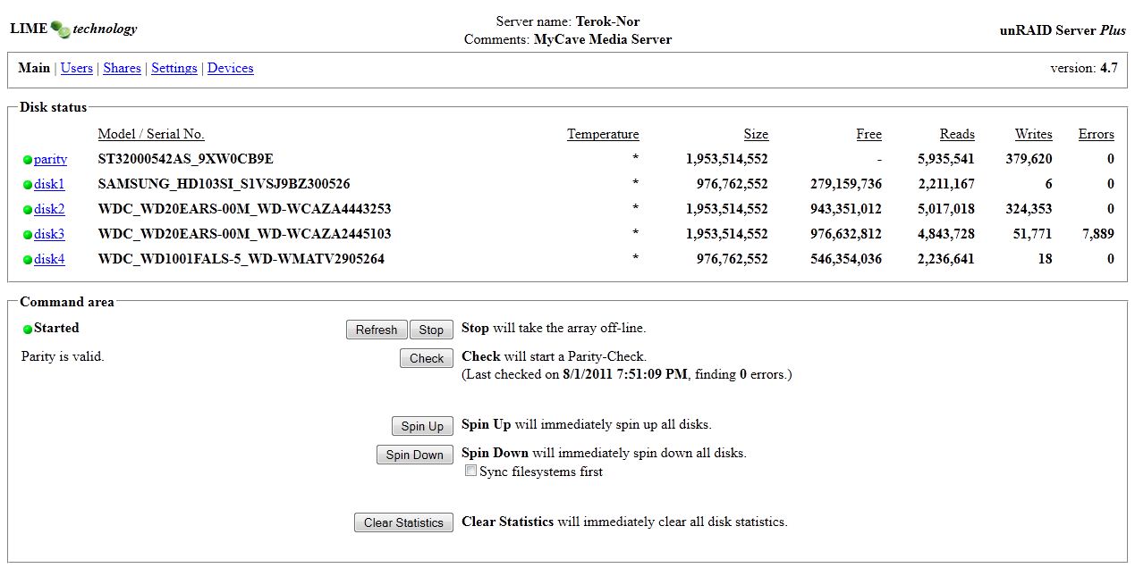

My server has run a monthly parity check and then this has happened, is there someone who can please try make me understand what has caused these errors.
i have attached a screenshot of the web page.
i have attached a syslog of the parity check
i have attached a short smart check of the mentioned disk (i know about the 44 temperature it has always done that on that slot even with a different disk)
i am thinking after reading what i can understand, i think i might have a bad sata cable or a faulty power supply as i did run the disk through 3 preclears i am not sure if it can be faulty?

There is a problem reading disk3. Reseat the cables. Try new cables and a different port. Attach a known working drive to the cables and port used by disk3. If disk3 continues to have problems it should be replaced.
Back up you config directory. No cookie cutter solution on this one. Back up you config directory.  Try reseating cables (data and power as has been suggested). Try to pull a smart report on that drive right after rebooting and post results.
