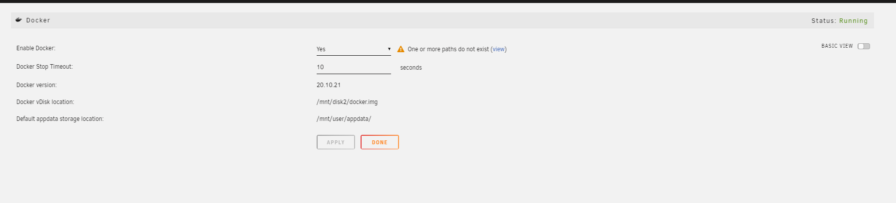

Last 31st my scheduled parity check was performed. During this parity check all my docker containers stopped. Which normally doesn't happen. Now it seems that my docker image is "gone". In the docker settings I get the message that the path to the docker image is incorrect.

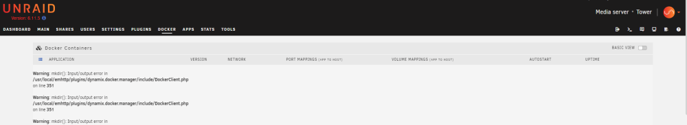

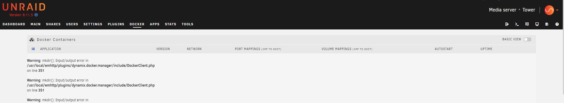

This is the error i get when i open the Docker tap:

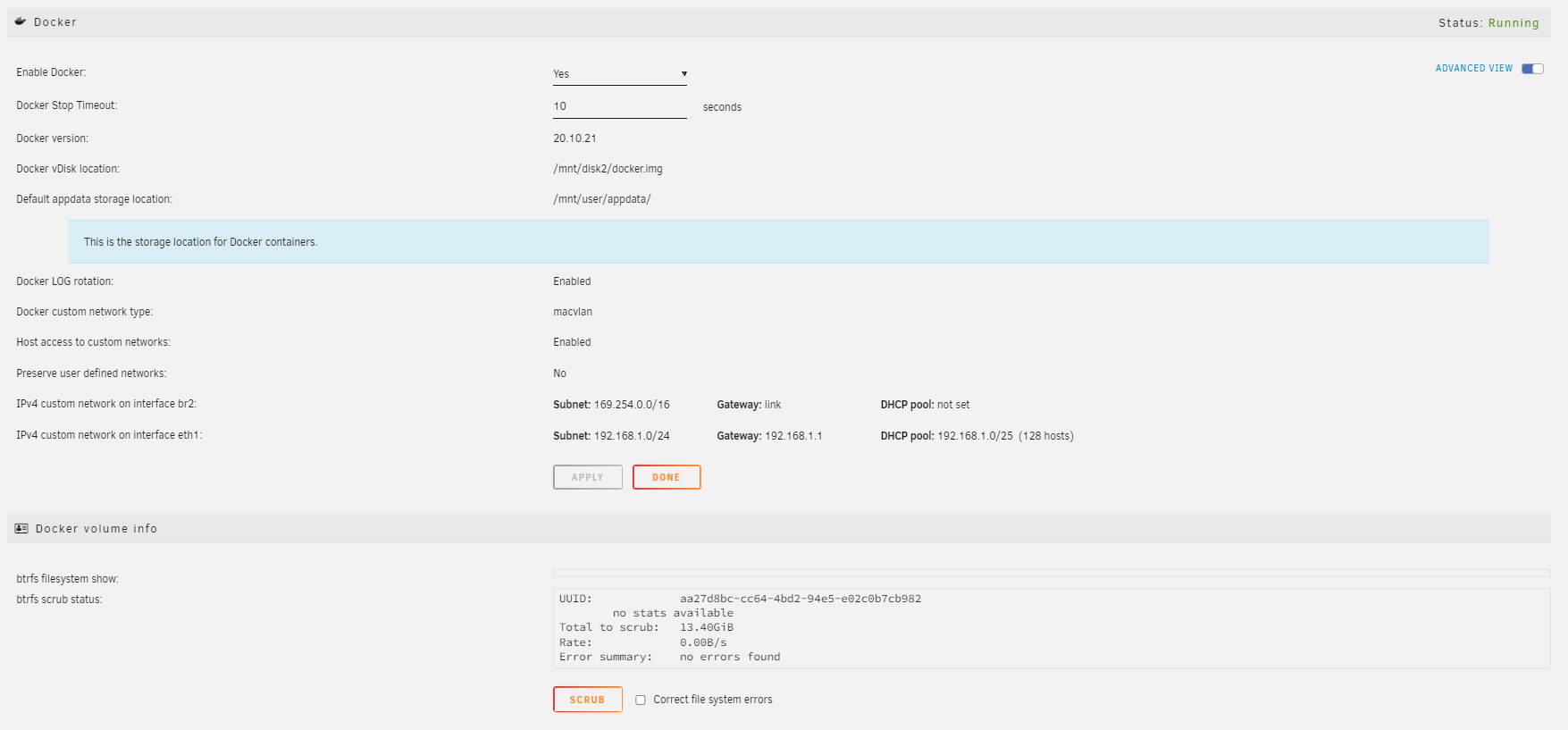

This is the Error in the Docker settings:
the path to which the Doncker refers:

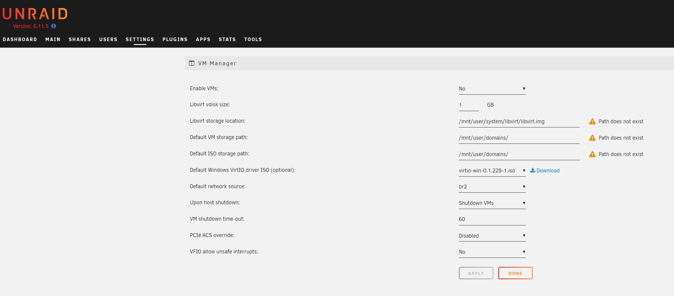

VM:

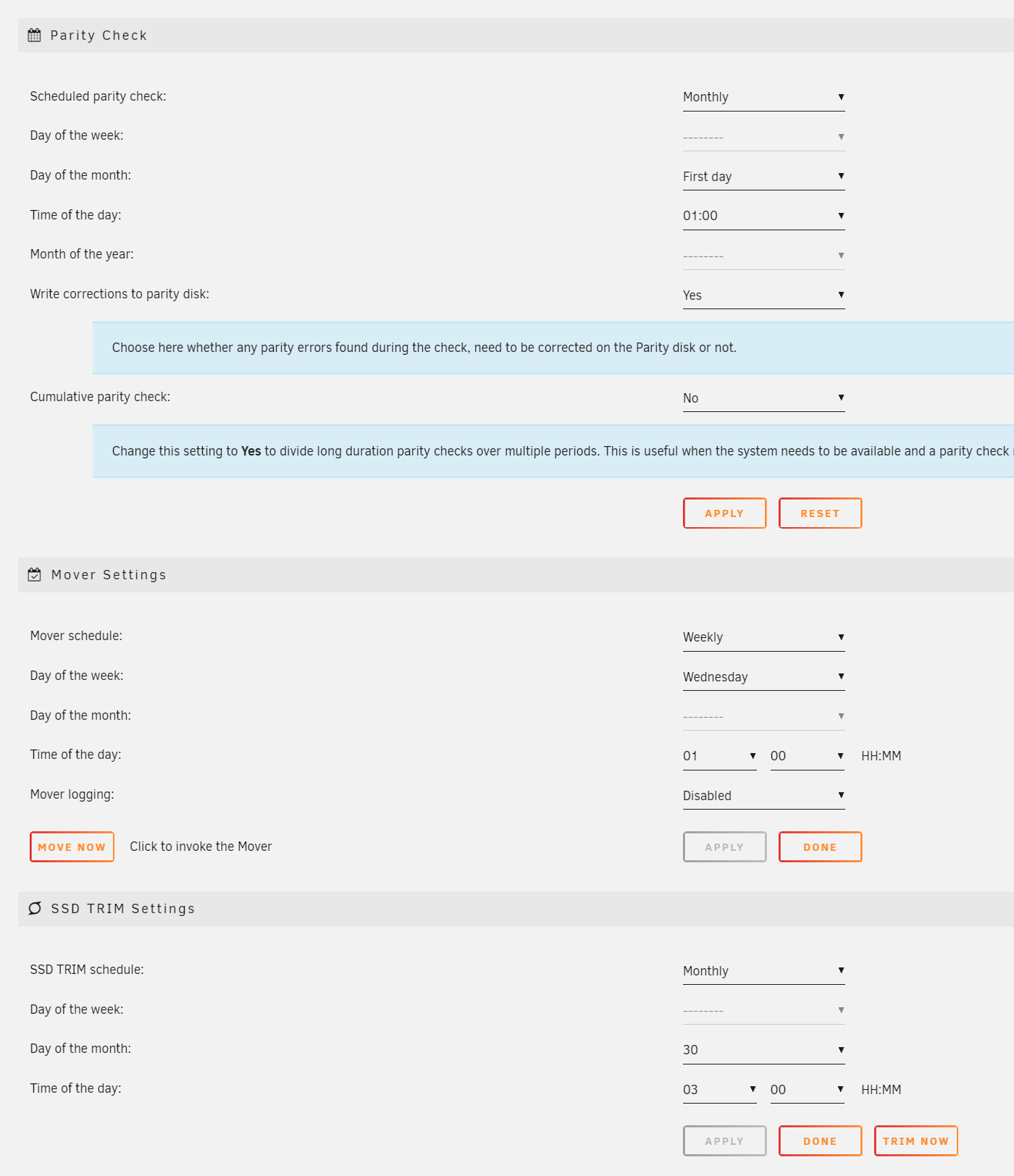

Parity Check settings:
Edited by Marcez
Added VM/Shares & Parity Check settings

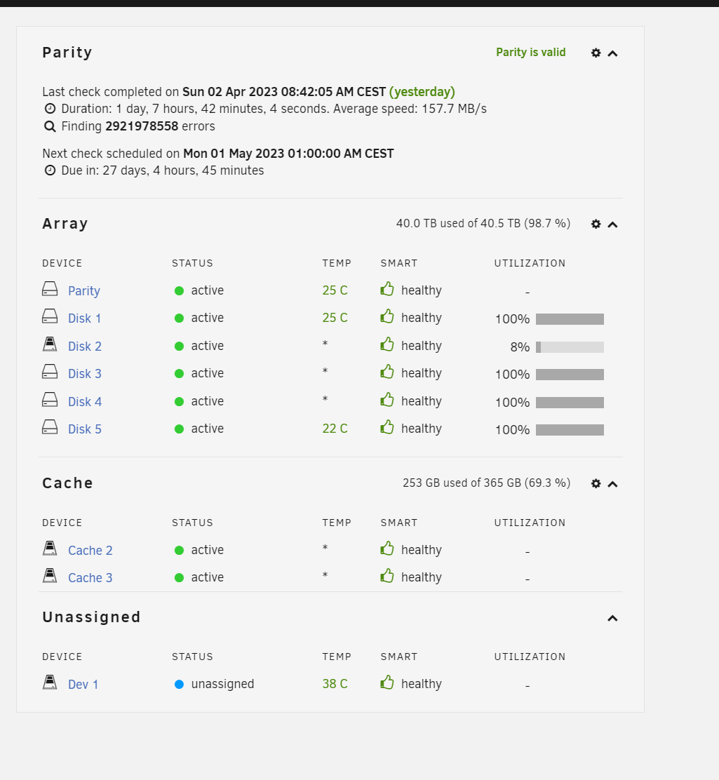

It looks as though a lot of the drives dropped offline as there is no SMART information for them in the diagnostics.    It might be worth power-cycling the server to see if that brings them back.   Also carefully check any power cabling, and anything else common to multiple drives.   Post new diagnostics after that so we can see what (if anything) has changed.
I Did a reboot of the server and these are the results i added the log.

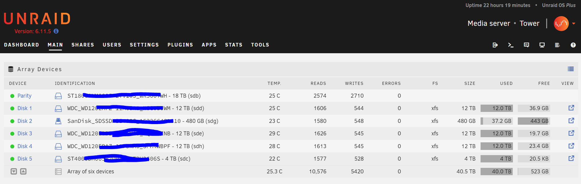

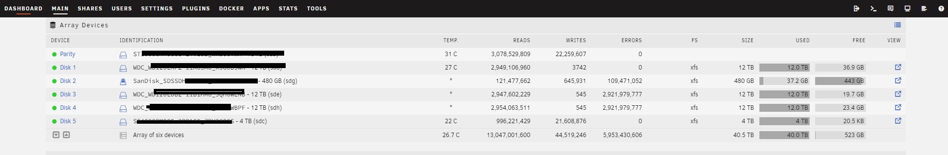

This the overview before the restart, I have Smart data..

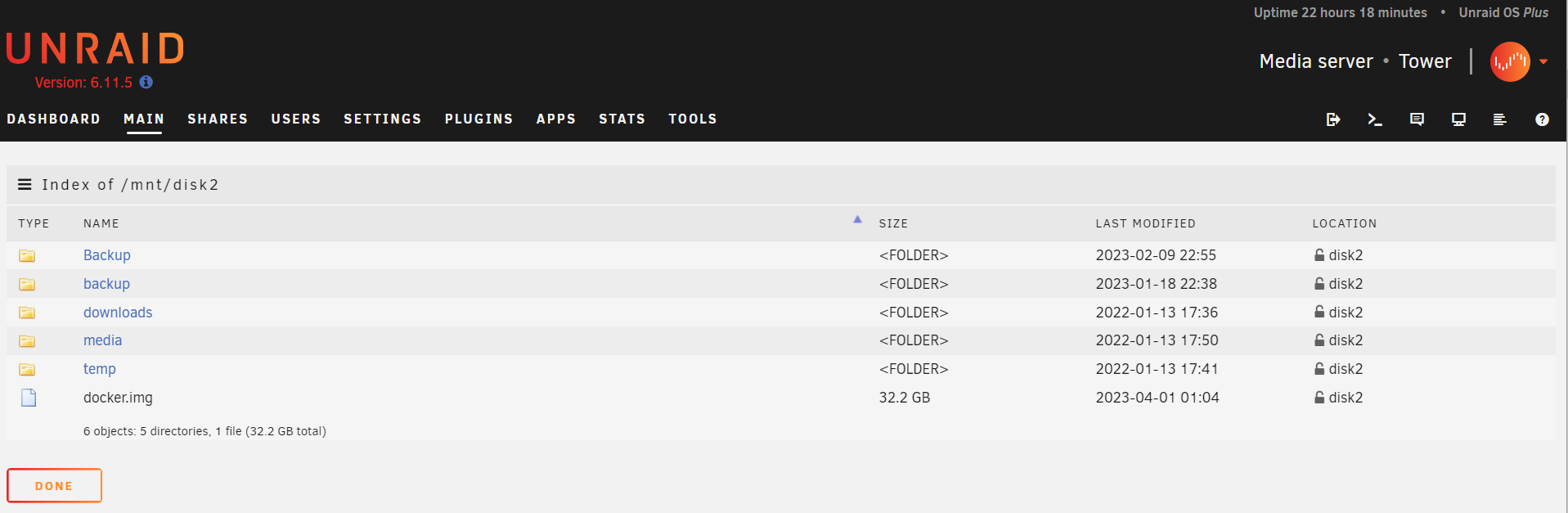

Now suddenly my shares are back & and my docker.img/ VM locations work again.

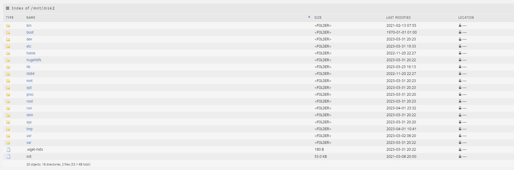

If i take a look at /mtn/disk2/ there are now different files as in the other example.
As seen in this screenshot this is how my /mnt/disk2/ should be.
