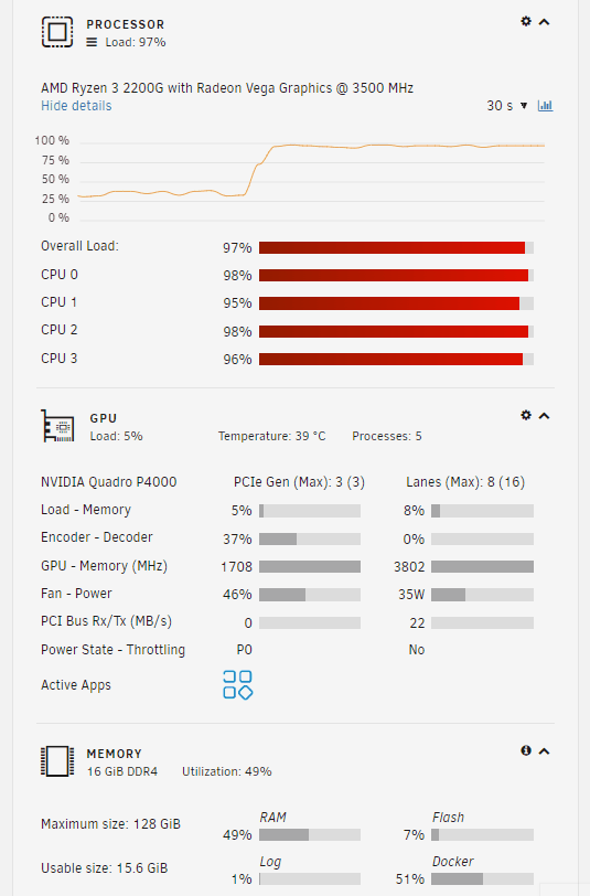

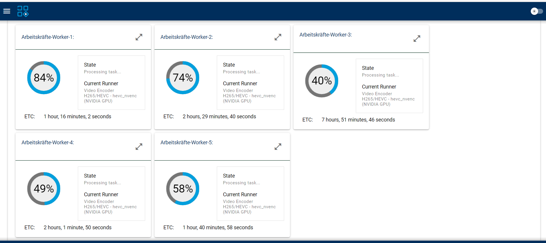

  1. Hi, I just installed an nvidia P4000 and the unmanic docker. Everything seems to be working however when I look at my stats of my GPU & CPU my GPU seems to be throttling and my CPU is doing the hard work. For example, I look at my Load - Memory which drops back to 0 every time, Encoder - Decoder and PCI Bus Rx/Tx (MB/s). When I have 4 workers running, shouldn't my GPU work harder? _ tower-diagnostics-20230406-1900.zip Thanks,

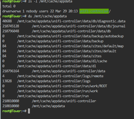

  5. Oke, Cool thanks for the info !

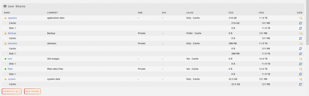

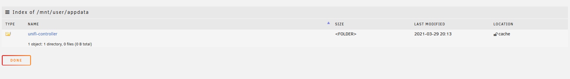

  6. Hi, The problems was the unifi folder. After deleting it i have now 216 GB free at the cache dir. The unifi controller stopped working after a error within unifi. I think it did get corrupted and made big mess out of the DB. Thank for the help !
  7. I see that the problem comes form the unifi directory, I deleted the controller a while back. Can u just delete the folder from the command line or will i corrupt something ?

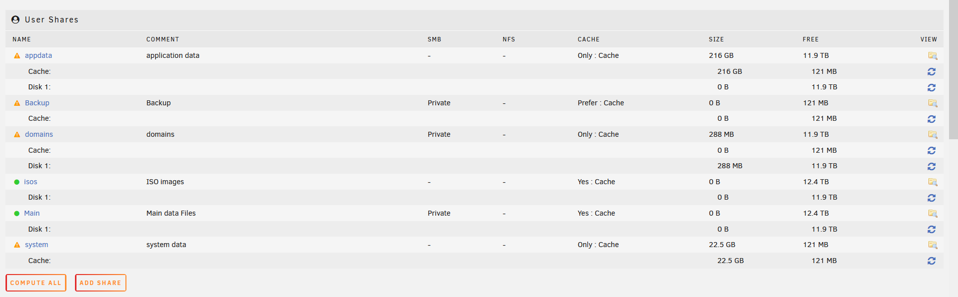

  8. Okay, So i there are other settings for my shares that will work better ? "Click Compute All button at the bottom of User Shares and wait for the results. If you don't get results after several minutes refresh the page. Then post a screenshot."

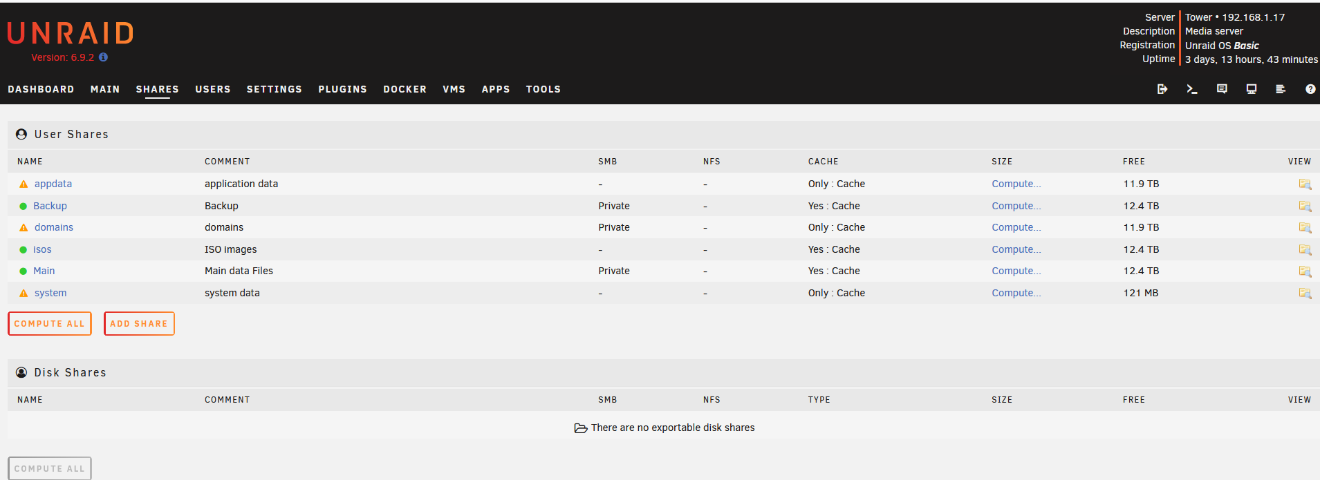

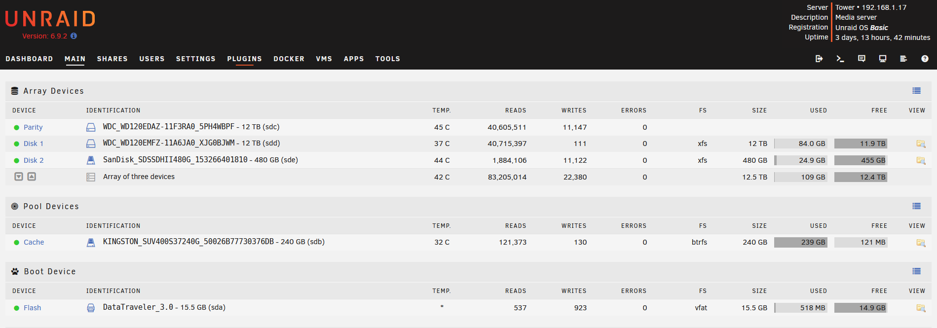

  11. Hi, Now the upload work, It didn't with firefox edge works beter so it seems. The Main share will be used for files that are more often used like excel/Word files. Isos is just a storage location that will be lest just than even back-up's. The back-ups will run every 3 days. Do you guy's recommend a other setup ? What for sizes is often used for the cache drive ? is 250GB enough ? Thanks for the info. tower-diagnostics-20210828-1427.zip
  12. Hi, I think i got it setup alright. When uploading the log i get error... "Sorry, an unknown server error occurred when uploading this file. (Error code: -200) " For now i put it here that seems to work. https://we.tl/t-QJEeiUE8Qo I have a setup with shares: Only : Cache Appdata Domains System Yes : Cache Backup isos Main
  13. Hello Lads, I am new here on the forum and with unraid, First of all i wish you all a good weekend in advance. I had a question about my setup i am struggling with my full-cache. And can't get it working. When i use the mover it wound move files. Do i miss something clear ? tower-syslog-20210828-0806.zip Greetingss
