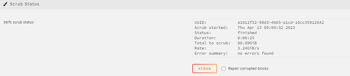

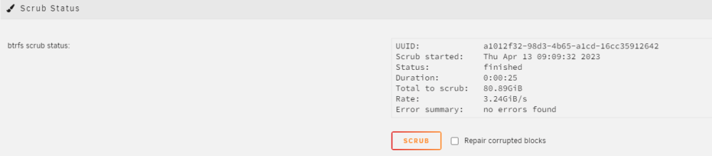

Run a correcting scrub on the pool and post the output.
The scrub results show no errors found.
That's good, keep monitoring the pool with this.

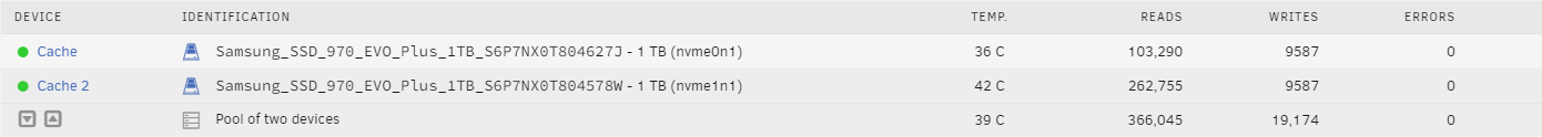

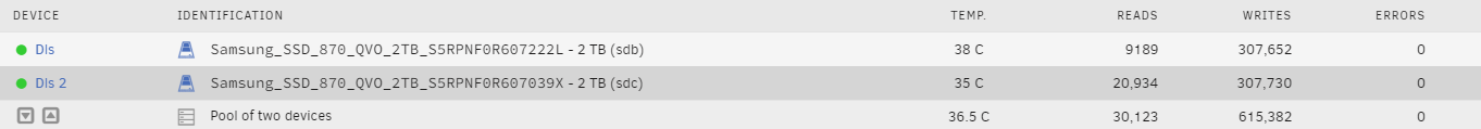

Out of curiosity are the read/writes of the pool drives meant to remain being the identical number as they are setup as raid 1.
They always start out being the same from reboot but get out of sync.
It's normal, since btrfs will alternate reads from both devices, and some process can have much more reads than others.
