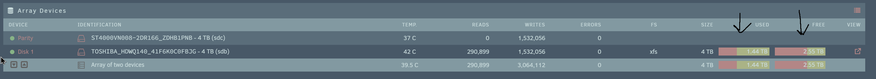

On the dashboard - main
why doesnt it shows used and free space for the parity?
Because parity doesn't have a filesystem.
also why it doesnt show any disk share. i still have access to folders on users created. i thought its suppose to show here
