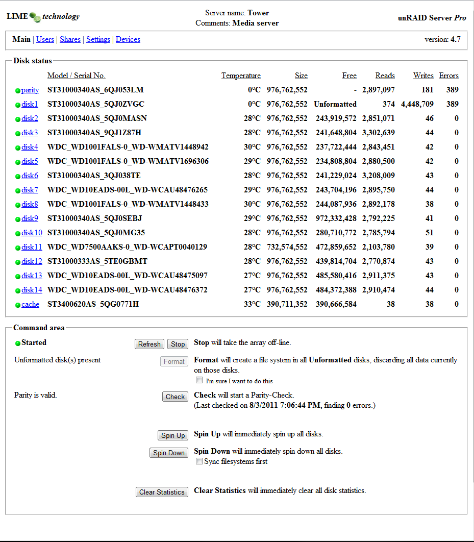

August 5, 201115 yr Disk 1 and my parity disk show a temperature of 0°C. Also, disk 1 is registering as 'Unformatted'(Screenshot attached). I recently successfully replaced disk 1 in my UnRAID server. I ran the WD tools on the disk I replaced, and it was not bad. The attached syslog shows temp errors and read errors. I probably have heat issues. I'm unsure how to proceed to preserve data integrity. syslog.zip
August 5, 201115 yr I've looked at this and while the temp errors may be the cause I cannot say what the correct steps would be to make sure that DISK1 is ok. Disk1 appears to have had errors first from what I can tell from the log. Then parity had problems, so parity is almost certainly bad (not the drive the bits). We (I am working with egnever) would like to power it down to check fans, etc. But we are not sure that a power down would not cause problems. We e-mailed support@ as well. Thanks.
August 5, 201115 yr Does parity and disk1 share a controller or power splitter? It's odd that they have the same number of errors. Power down will not cause problems.
August 5, 201115 yr They are in the same removable cage. It's all heat or POWER related. Just not sure what to do now.
August 5, 201115 yr They are in the same removable cage. It's all heat or POWER related. Just not sure what to do now. What kind of cage? Can you move them to another cage?
August 5, 201115 yr Possibly, but that is not really the problem at the moment. The problem is what to do to preserve the data. We want to ensure the correct actions and then we can shutdown and evaluate the hardware.
