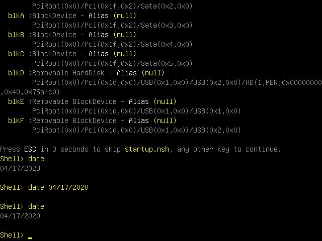

That's a BIOS bug, I still haven't updated some of mine, just boot to the UEFI command line, set the date to earlier and reboot to the BIOS, that always works for me.

I just type exit on the UEFI shell and reboot, if you remove the CMOS battery date should also be reset.

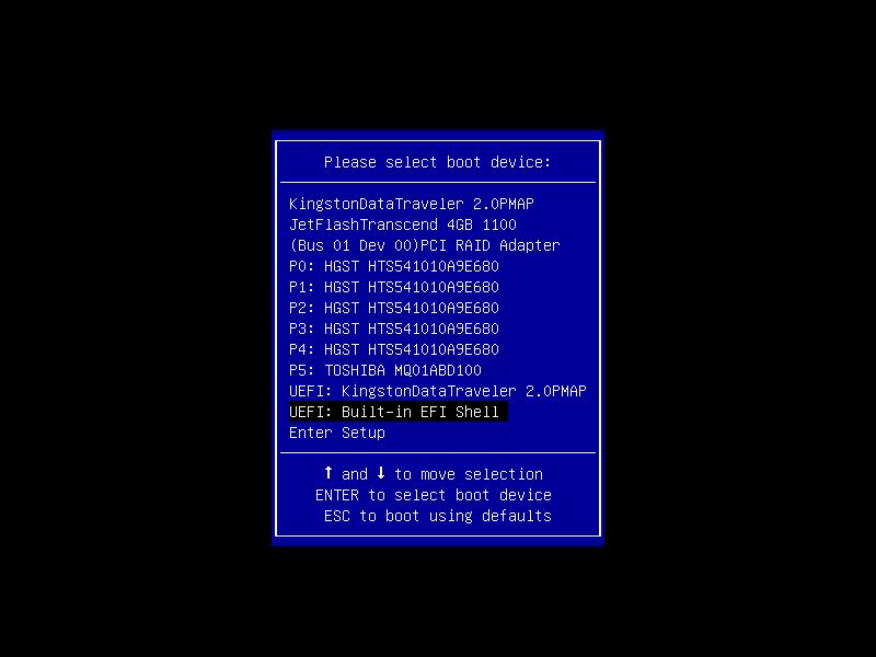

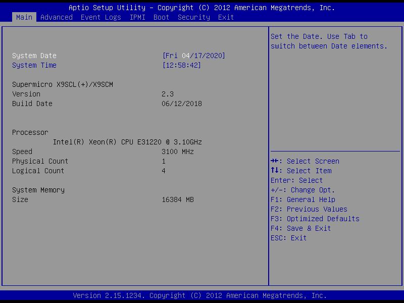

This is what I do:
BIOS before changing the date (since I didn't update it yet)
Boot to UEFI shell
Change date
Reboot and enter the BIOS again
