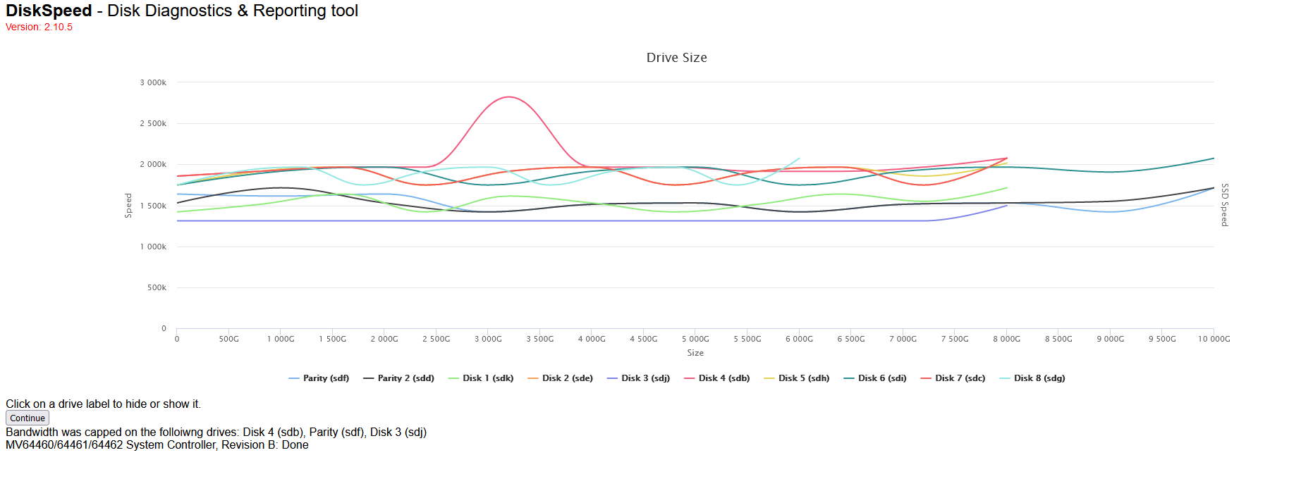

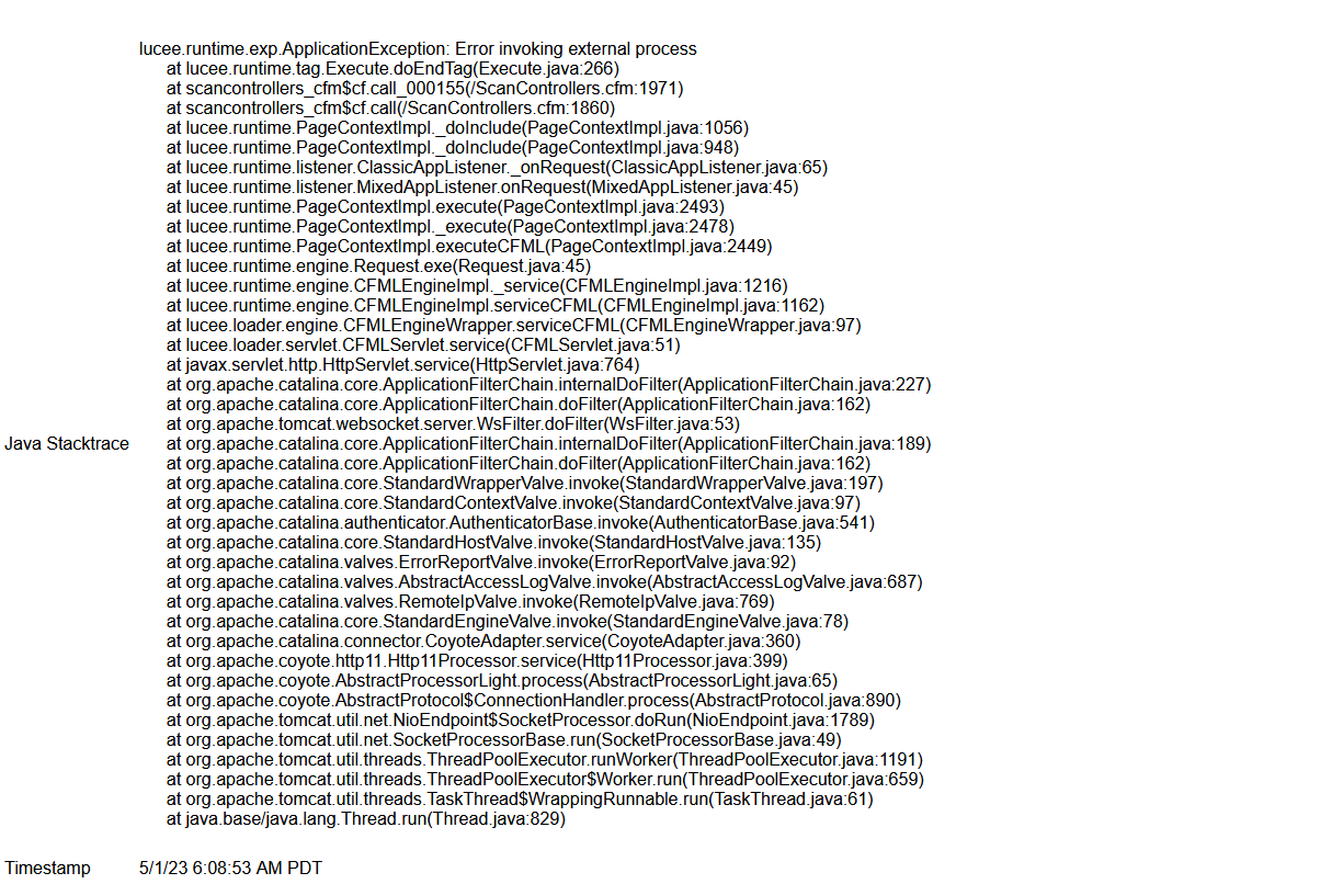

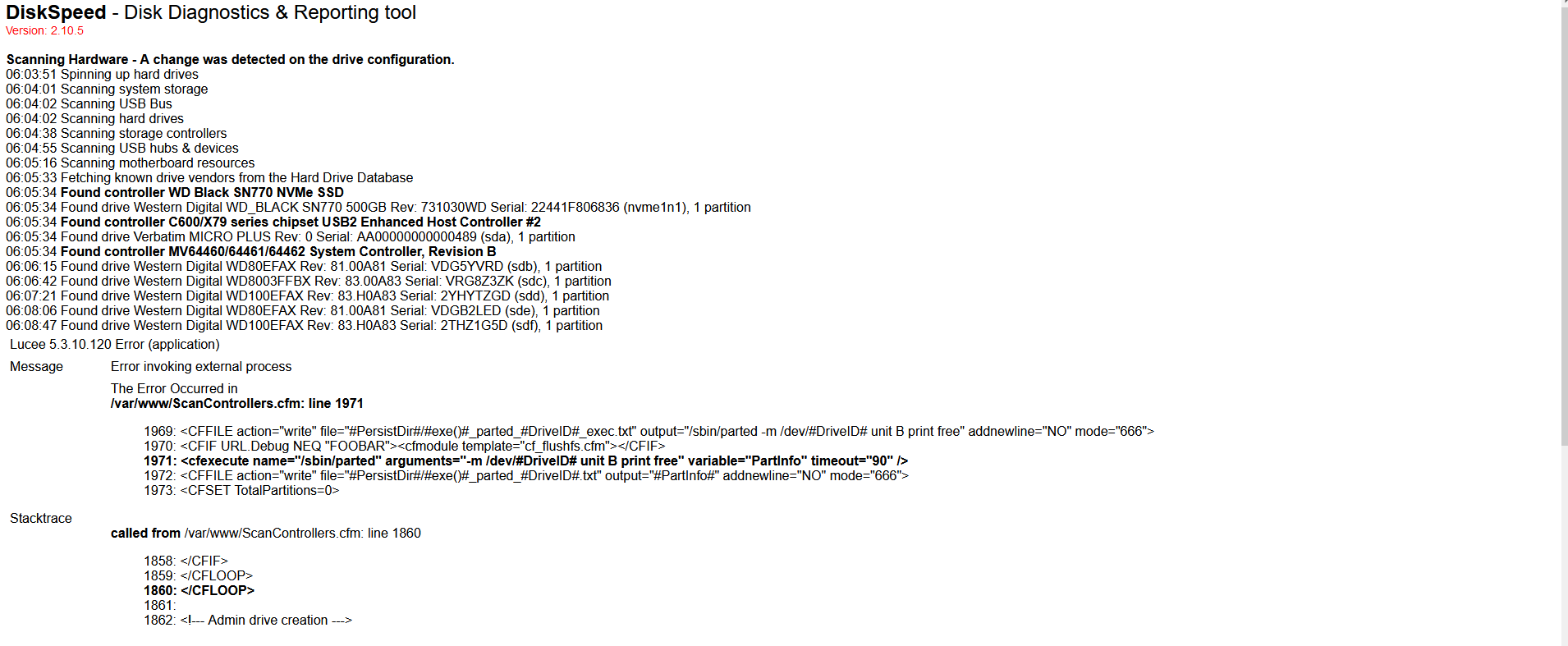

    Ran it see attached screen shots, there is an error but not knowing the docker, I'm not sure what it all means.
Thanks!
If the test is not running you should post in the docker support thread.

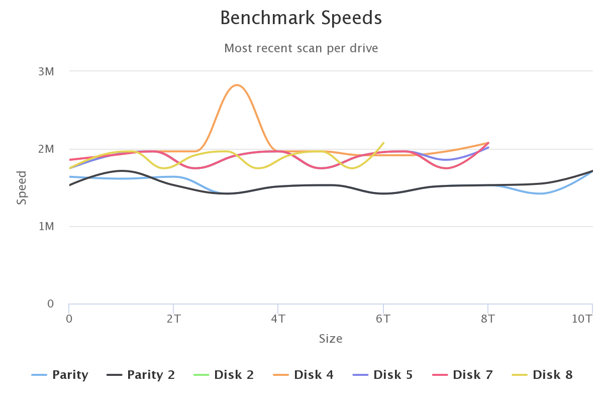

   Apologies, attached the results.  All drives are around 1.5 - 2MB/s. Not sure why, could it be a driver thing since on 6.7.5 it is significantly faster?
Thanks!

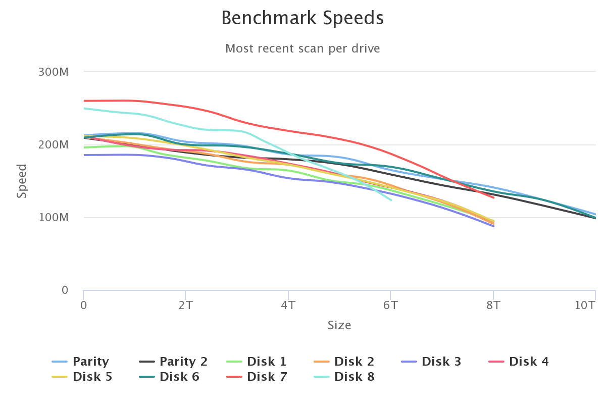

    Just for reference here is Disk Speed running on 7.5.2.
Thanks!

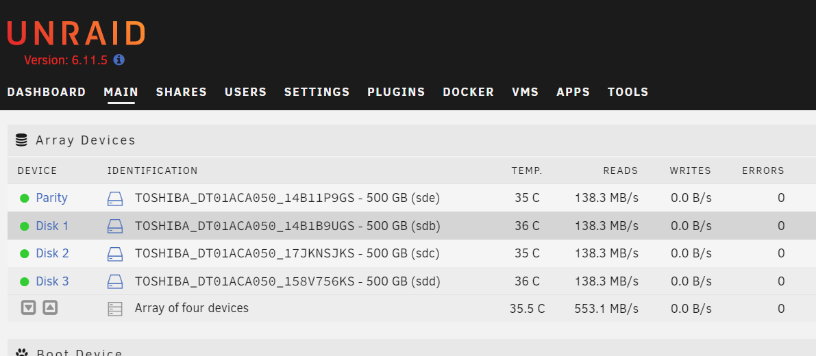

It's not just a driver problem, you are using a SASLP correct? There are other models that look similar on lspci and use the same driver.
This is with a SASLP and v6.11.5, the max speed is still being limited by the controller, but it's not far from the controller max usable bandwidth with older Unraid releases, around 640MB/s
