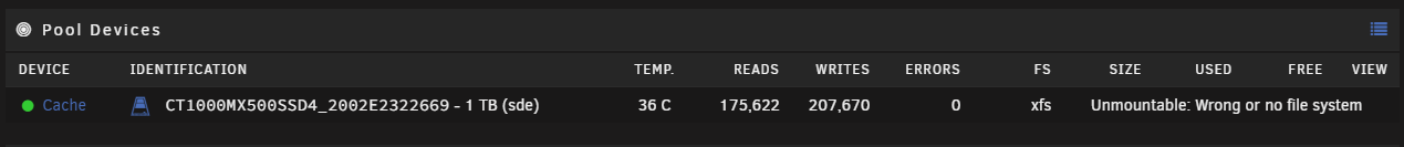

Hello everyone! Hopefully someone can offer me some advice . . .
I was on a mission today to remove a 1TB SSD from Array Devices and add it to my cache pool alongside a 1 TB NVMe. I roughly followed this video from @SpaceInvaderOne to "safely shrink" my array. He offers two methods in the video and I opted for the latter method despite not even having any parity discs. Don't ask me why...I don't know lol.
  • I shut down Docker and VM
  • I used unBalance to export the data to the others disks and then a script he provided via link to zero out that SSD.
  • I stopped the array, ran New Config with "Preserve current assignments" set to "All".
  • Unassigned that SSD.
  • Started the array.
This is where I deviated from the steps in his video . . . The SSD was now an unassigned device and instead of shutting down the server to pull the drive, I figured it was now safe to add it to the cache pool.
At first, both SSDs in the cache pool said they couldn't be mounted because they had no uuid. I stopped the array once again, unassigned that 1TB SSD and started the array. My thought here was that at least my original cache drive would mount and I could carry on with a working server, surviving another day to try adding that second SSD to the cache at a later time. Wrong!
The original cache disk was still saying it didn't have a uuid. Instead of realizing that I had to change the cache slots back to 1, I changed the file system from btrfs to auto (I thought I had seen that somewhere once). That didn't work so I changed it back to btrfs . Now I'm noticing that the drive is saying "Unmountable: Wrong or no file system". Despite saying that the drive is unmountable, it still appear in my cache pool instead of under unassigned devices.
I briefly read through the documentation for handling Unmountable Disks and saw that is is recommended to scrub rather than repair a btrfs drive, but I can't. Even with the array started, UnRaid tells me that "Scrub is only available when the array is Started". I'm going to wait for some feedback before proceeding to screw anything else up.
void-diagnostics-20230416-0157.zip
Edited by RS7588
Solved by JorgeB

15 hours ago, RS7588 said:
/dev/sde1: UUID="0a83b1a8-338d-4de9-a744-8c5cbb7a28d0" BLOCK_SIZE="512" TYPE="xfs"
Assuming this was the original cache it's xfs, set pool slots to 1 and fs to xfs.
The issue persists.
Apr 17 18:44:34 void  emhttpd: shcmd (11484): mount -t btrfs -o noatime,space_cache=v2 /dev/sde1 /mnt/cache
Last boot attempt was still with btrfs, did you start the array after changing cache to xfs?
Yes, I did.
For kicks and giggles . . . I will stop the array, make sure the drive is set to xfs and start the array again.
void-diagnostics-20230418-0726.zip
Apr 18 07:24:57 void  emhttpd: shcmd (13188): mount -t xfs -o noatime,nouuid /dev/sde1 /mnt/cache
Apr 18 07:24:57 void kernel: XFS (sde1): Invalid superblock magic number
