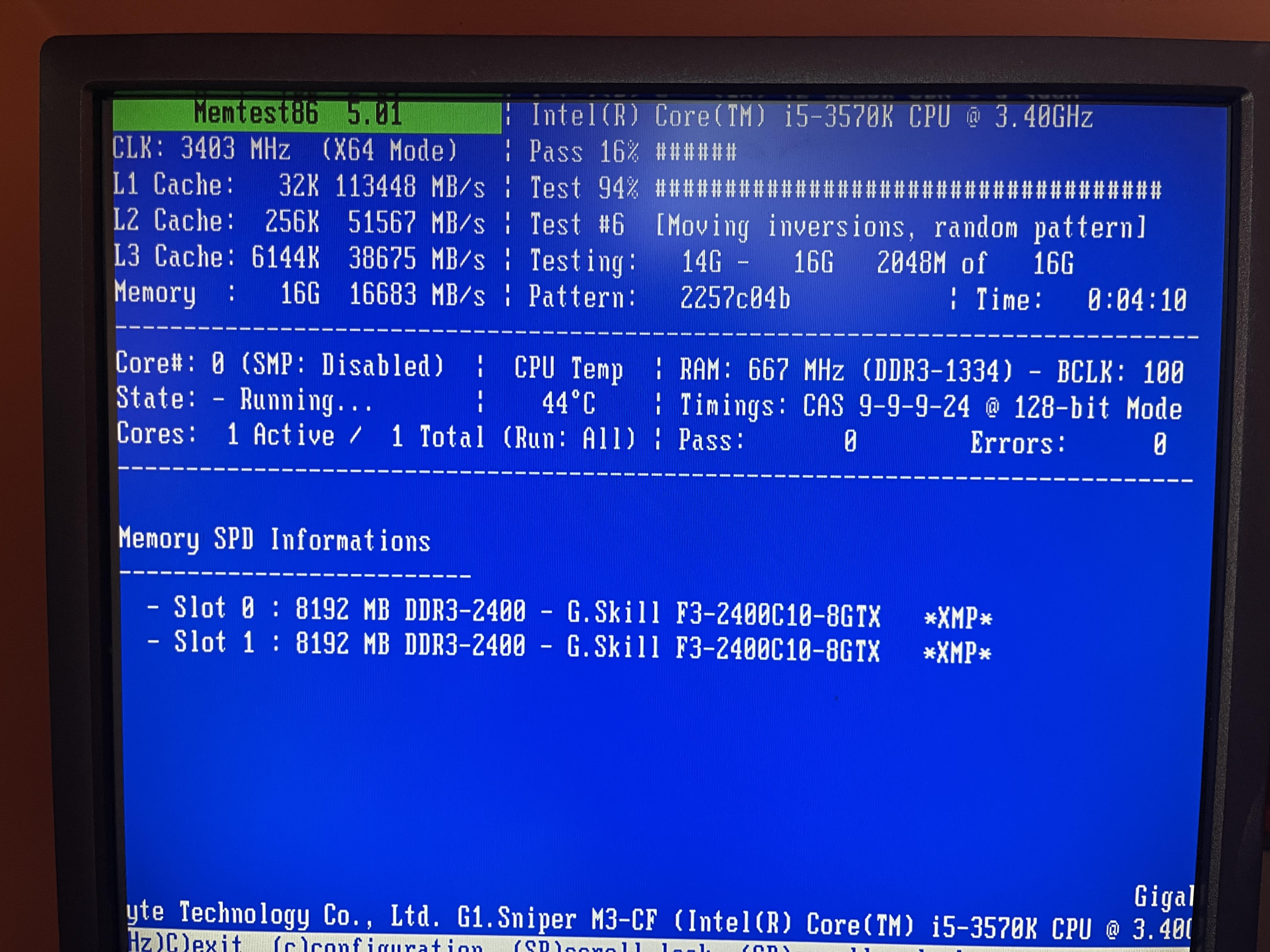

I have been unable to keep my "new" server running for more than a 11% new drive parity copy/rebuild on a new drive. It just occurred to me that I should run a memory test and see what happens with that. I was in the middle of running the memory test available on start up where you can choose Unraid with or without GUI, with or without plugins, etc., and probably 5-10 minutes into it the computer crashed. What can I rule out, and is there any way to figure out why it crashed? Does it mean the memory is bad, or should it report an error and not crash if it is memory? Are there reports somewhere, etc. Attached I have a screenshot about a minute before it crashed. Note:when it crashes, it just shuts down and I typically will need to turn the power supply off and unplug it for a while before it will boot again. This is a new power supply that I purchased to try to rule it out from being the issue. Help would be appreciated. Thank you

Try with just one of sticks at a time, if it still crashes with either it's likely not a RAM problem.
Thanks. I have 4 sticks of it so I’ll try all those, and then pull a stick from my main computer and check that for the sake of it.
Tried 4 sticks of ram and every usb port on the computer with the unraid/memtest on it, they all crash during the memtest. What else could this be? I am about to try the ram on a "clone" - same motherboard, and CPU and see if the ram runs on that.
