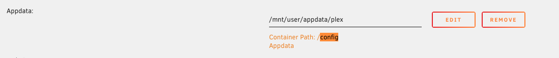

  4. How would I find out what is being written and where? Any idea what set of logs? Also, I added a shot of the confit file for Plex above, is that the one you were referring to? Thank you Sent from my iPhone using Tapatalk

  6. This one? /mnt/user/appdata/plex (image attached)

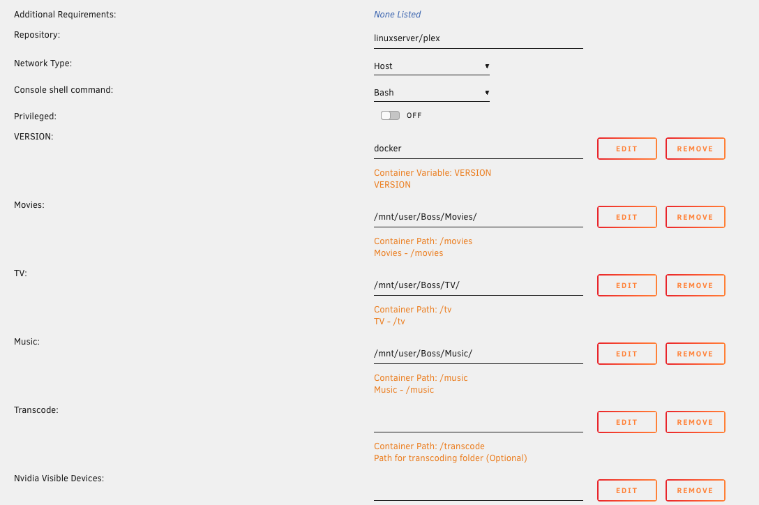

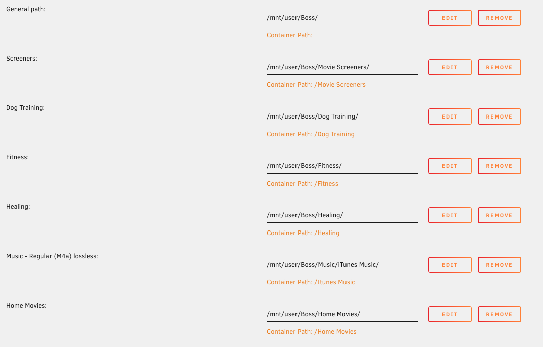

  8. While my docker container is on the smaller side, 15GB, I have recently run into an issue of it getting full multiple times a day. These events happen at 12:23am, 10:19am, 12:28pm and they do not happen when I stop the Plex docker container. I believe this started when I enabled the Sonic feature for music in Plex. I have attached the paths I have in hopes that someone can tell me what I have set wrong, or where I need to look in order to fix this issue, maybe a path in the Plex docker itself? I posted about this before, but lacked adding some extra detail. I get the alert emails: Event: Docker high image disk utilization Subject: Warning [TOWER] - Docker image disk utilization of 75% (then a few other full warnings within a couple of minutes - 87%90%/100%) Description: Docker utilization of image file /mnt/cache/docker.img Importance: warning Event: Docker image disk utilization Subject: Notice [TOWER] - Docker image disk utilization returned to normal level Description: Docker utilization of image file /mnt/cache/docker.img Importance: normal Thank you in advance. Please help me set my paths
  9. Anyone able to help me figure out what path is not mapped properly? Diagnostic file attached. Thank you in advance for your assistance tower-diagnostics-20230607-0817.zip
  10. So unmapped paths are stored in the docket instead of the array? Why would this just start all of a sudden? Hmm, actually I set up the audio imprint sonic thing fairly recently, maybe that’s it. Sent from my iPhone using Tapatalk
