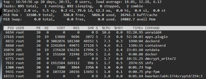

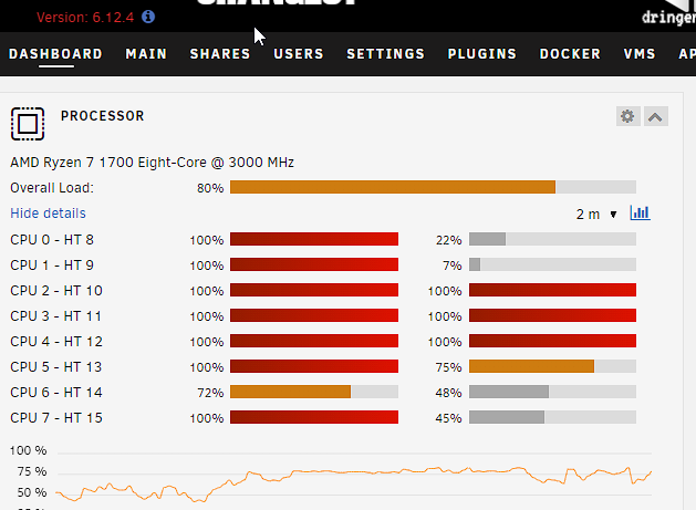

pappaq Posted April 19, 2023 Share Posted April 19, 2023 Hey, my server is currently having the issue of "getting stuck" every few seconds. Three CPU cores go up to 100%, file transfers are stuck and continue after the CPU usage return back to normal. This repeats every few seconds. This has an impact on other services as well but data transfer is impacted the most. top returns high shfs usage on one core. Could someone have a look at my logs and help me? Thanks in advance! dringenet-ms-diagnostics-20230419-1717.zip Quote Link to comment

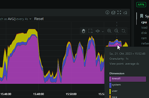

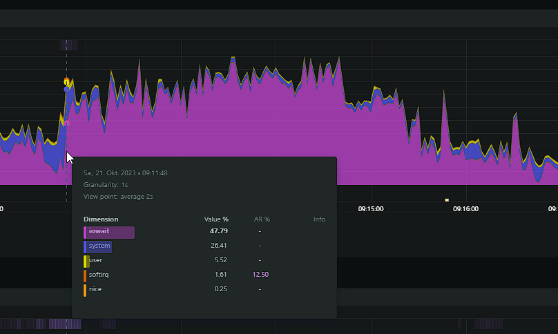

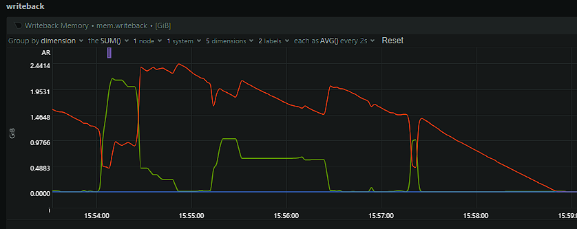

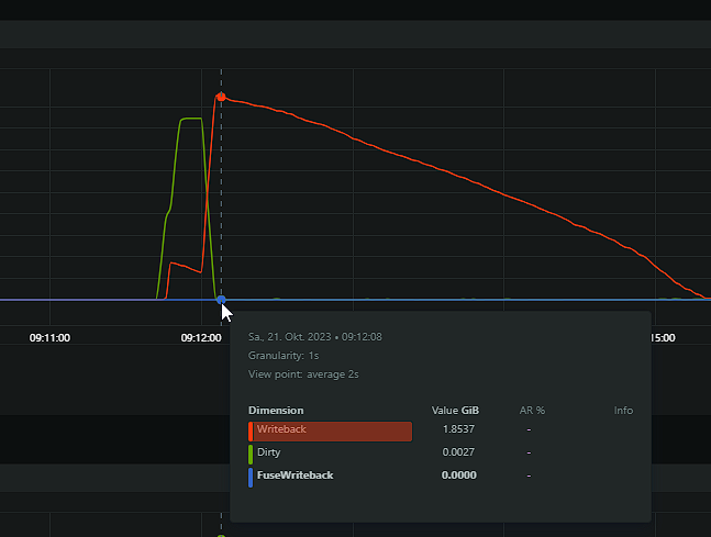

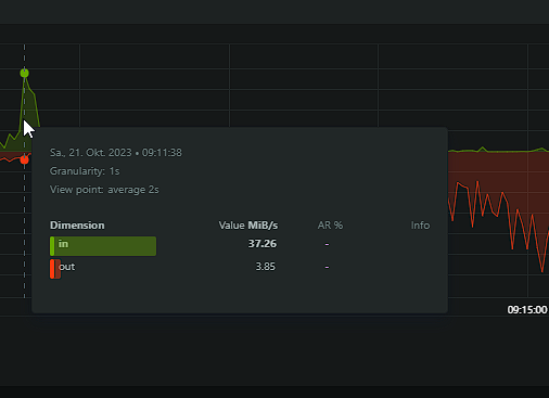

pappaq Posted October 21, 2023 Author Share Posted October 21, 2023 (edited) My problem has returned, worse than ever. The system is pretty much locked up when the iowait issue occures. Seems like memory writeback is the issue. Is there something I can do? I've found many threads about it but never a solution for it. Here some screenshots from my netdata and the diagnostics. dringenet-ms-diagnostics-20231021-1038.zip Edited October 21, 2023 by pappaq Quote Link to comment
JorgeB Posted October 21, 2023 Share Posted October 21, 2023 If possible use disk shares (or exclusive shares) and see if that helps. Quote Link to comment

pappaq Posted October 21, 2023 Author Share Posted October 21, 2023 (edited) I've update unraid to 6.12.4, changed all possible shares to exclusive shares and updates everything I could. The same problem persists. I've even changed the transcoding of emby to the RAM. It seems like it is randomly doing memory writeback and that's causing the iowait to lock up the system. But I can't pin down what is causing this. Any ideas? dringenet-ms-diagnostics-20231021-1605.zip Edited October 21, 2023 by pappaq Quote Link to comment
