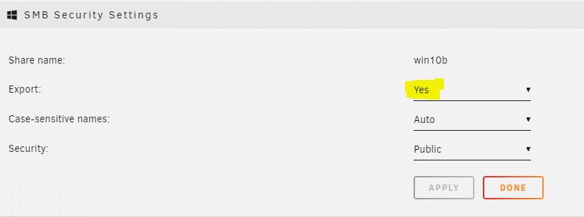

Go to the share(s) and make sure it's being exported, default is no.
That did it.  I can't tell you how many tutorials I've watched over the last few days that either didn't mention that or I guess I somehow overlooked it.
