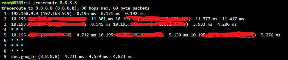

Doesn't like DNS / docker service issue. Your traceroute only have one line and timeout, it indicate you lost access to router.
The 1st line should be your router 10.10.12.1 not 10.10.12.18.
If router accessible just not internet, then traceroute will be below
Try review all setting, stop Swag docker or stop all docker one by one until rule-out which docker cause problem.
