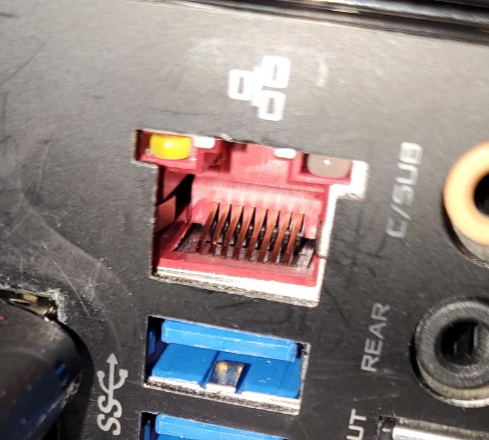

Look into the RJ-45 socket on the MB and make sure that none of the pins looked bent
Thanks Frank, I double checked the port and the pins look fine to me:
I did notice the two pins on the left looked like they may have had something on them (hard to see in this photo sadly) so I cleaned them with alcohol and I'm still getting 100Mbps.  The difference now is it's advertising 1000baseT/Full where it previously didn't (baby steps?):
