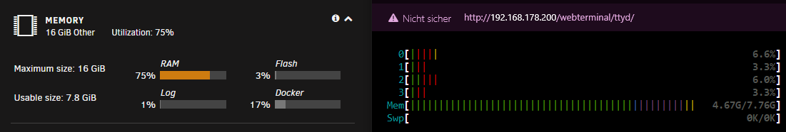

if upgraded my ram on my Unraid Server. I now use 16gb of ram instead of 8gb. Unraid shows on the Dashboard that 16gb of Ram are installed but wont use it. When i use htop in the Unraid console it shows me that "xy" gb amount out of 8gb ram are used.
Is there a way i can fix this?
When my MoBo detects the 16gb and it shows them in the Dashboard why wont Unraid use the full 16gb ?

This is usually a hardware isssue (bad/dirty contact, poorly seated stick) that results in the identification chip being read but data transfers to fail resulting in the stick getting disabled.

but i still find it a bit odd that exactly 2 out of 4 sticks ar not working.

Then probably a whole channel isn't working, could also be CPU-side contact issues.
Move sticks around to see what the problem follows, if it's sticks or slots, and which one(s).

Found the Problem. There was a bend pin on on the CPU after puting it back in to the right place it works Perfectly fine now.
