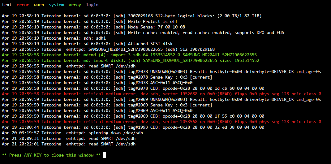

Hi - I had a couple of power cuts around a week ago. Unraid has done 2 full parity checks since it came online and has both times had 379 errors show:

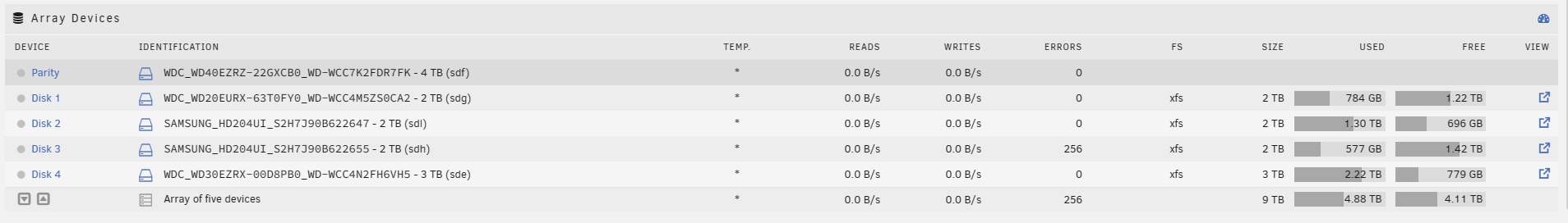

Disk 3 is showing 256 read errors:
Log from shortly after the power came back on:
But SMART check and diagnostics don't really show anything too bad as far as I can see (attached).

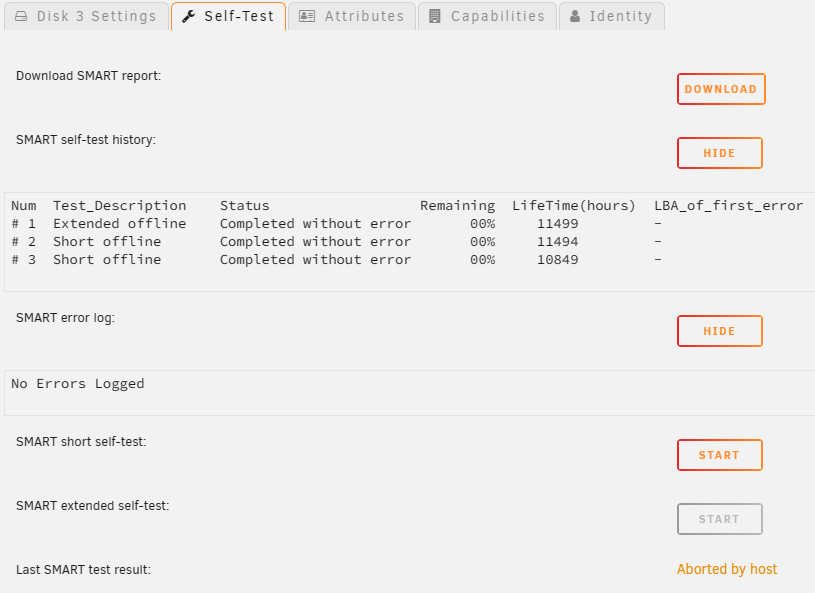

Last check was correct so the sync errors should be fixed, as for the disk, it's logged as a disk problem so run en extended SMART test.
Yeah, did the extended test, it came back with no errors, as far as I can tell. I thought I had attached it to the first post... Will check shortly.

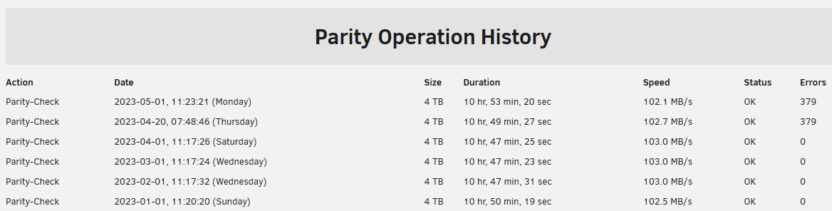

I'm a little confused by the parity check results (my lack of understanding)! The status is "OK", but it shows 379 errors - exactly the same as the previous parity check after the power failure. How can the parity be OK if there is a read error?
Diags don't show the first one but I assume it was no correct, so it's normal for the 2nd one to find the same errors, when there's a read error Unraid will write that sector back to disk using parity plus the remaining disks, if there's a write error the disk will be disabled, if there isn't the data will be correct, at least as reported by the disk.
As for the disk since it passed the extended test is OK for now, replace/swap cables with a different disk to rule that out, any more read errors after that I would replace it, a lot of hours and SMART doesn't look that great.

I've acknowledged the UDMA error which was there after the restart, and tried to "clear stats" from the main page, but can't get rid of those 256 read errors on Disk 3. Do I need to restart the server for that?
Try re-starting the array, IIRC that will do it, if it doesn't reboot.
Restarting the array didn't reset the read errors, but restarting the server did. Thank you for all your help. 👍
