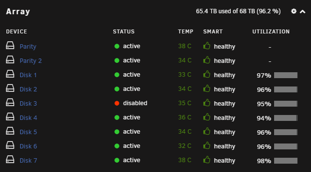

I keep having issues with read/write errors on certain disks and it seems to occur during parity checks most of the time. I was getting some UDMA CRC errors on a couple of disks but it doesn't seem to have occurred in a while and not sure if it's related.

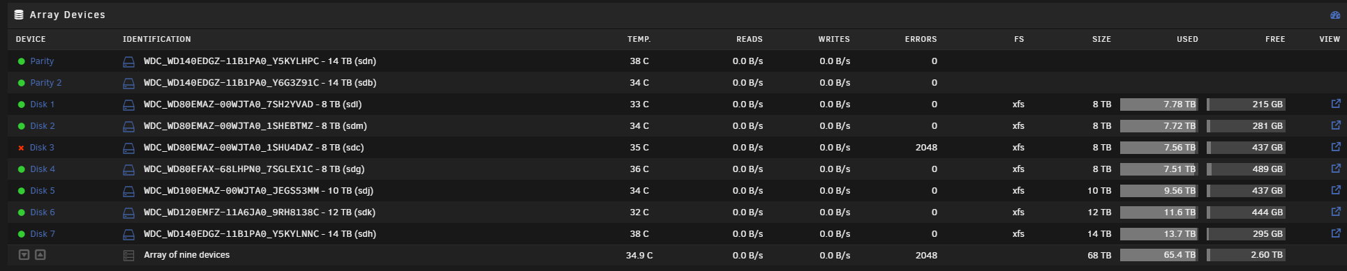

Disk 3 in specific seems to keep getting disabled even though SMART data looks fine other than the UDMA CRC errors. It does have about 5 years of power on time but other than that I don't see anything out of the ordinary.
Disk 1 is the oldest of the array with over 5 years power on time, but has a ton of UDMA CRC errors. I'm not sure where these errors come from, I've checked cable connections and everything seems fine.
I have also connected the server to UPS to prevent any unclean shutdowns during a power outage, I've had a couple instances of the server shutting down uncleanly during power outages.
I have attached diagnostics for reference. I'm also runnnig an extended SMART test on it as we speak and it's about 50% done.
And yes, I'm aware the disks are very full. I've ordered two 14TB drives to add to the array but not sure if I'm just going to have to replace disk 1 and 3 (i would rather not assuming there is no actual issue).

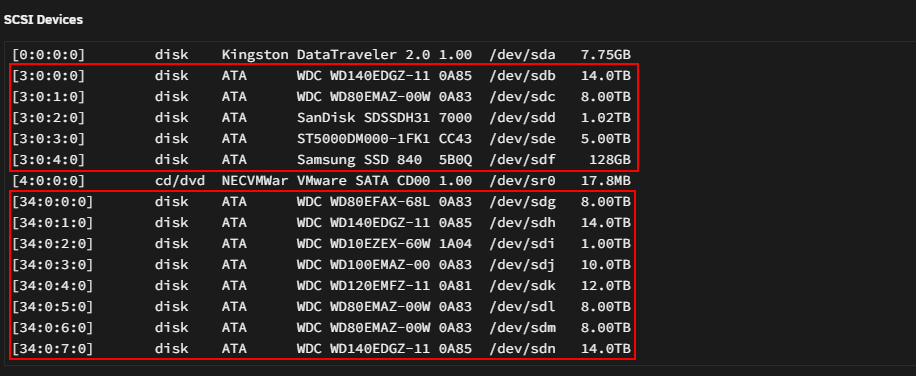

Is there a way to see what disks are connected to which HBA through the unRaid console?
Tools -> System devices, then assuming no hardware changed since last diags:
0b:00.0 -> HBA1 (cm0)
13:00.0 -> HBA2 (cm1)
So am i correct in assuming that the ones highlighted on the top are on HBA1 and the bottom ones are on HBA2?
