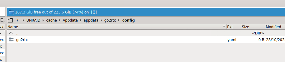

October 28, 20242 yr Ah, I think maybe I did not explain it well enough. Go to where the file/dir /config/go2rtc.yaml is created. In the Appdata folder. Delete the go2rtc dir. Create the go2rtc.yaml file. The restart docker. Should work after that. It's in the creation of the first run it messes up. Once mamually fixed it works.

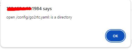

October 29, 20242 yr i tired that a few times, but still keep getting that error in the gui edit: just rebooted and still getting the error edit2: got it!! thanks i forgot to change back to config config to point to the yaml file Edited October 29, 20242 yr by ToXIc
