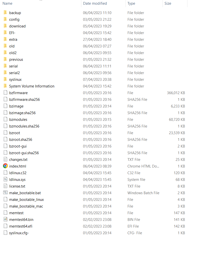

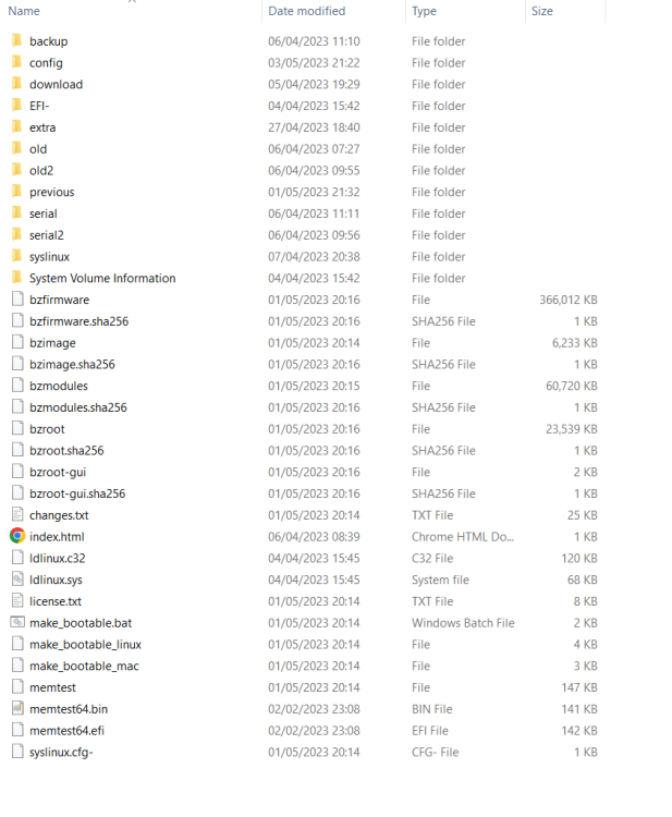

Does the efi dir have a - in the name if so remove the -

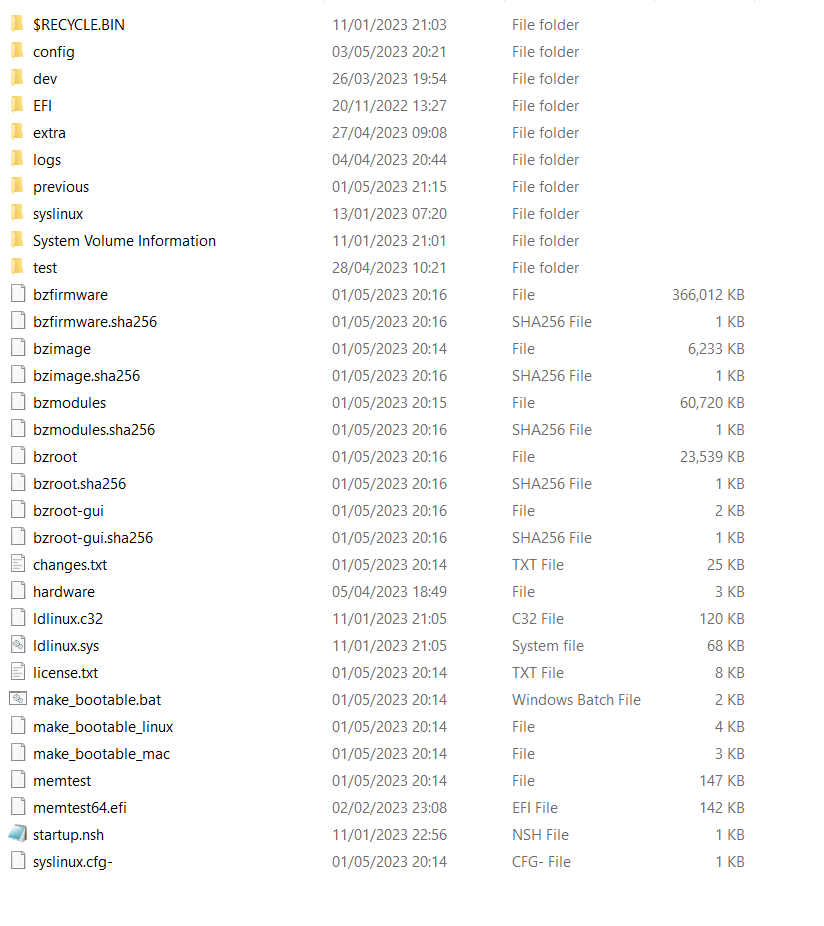

The flash drive should look similar to this. You may not have all the same dirs as me but should be EFI
