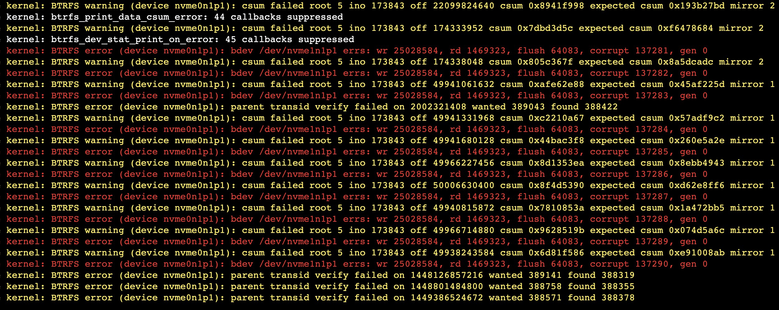

I have two 2TB nvme drives in a RAID1 btrfs and am getting errors.
I've tried doing a scrub but it seems to immediately be aborted.

This shows that one of the NVMe devices dropped offline in the past
May  6 09:47:03 Sunshine kernel: BTRFS info (device nvme0n1p1): bdev /dev/nvme1n1p1 errs: wr 25028584, rd 1469323, flush 64083, corrupt 119757, gen 0
A scrub should correct this, but you have at least one share set to NOCOW, this is a problem, recommend saving what you can from the pool and then recreate, with all shares set to COW, also see here for more info.
