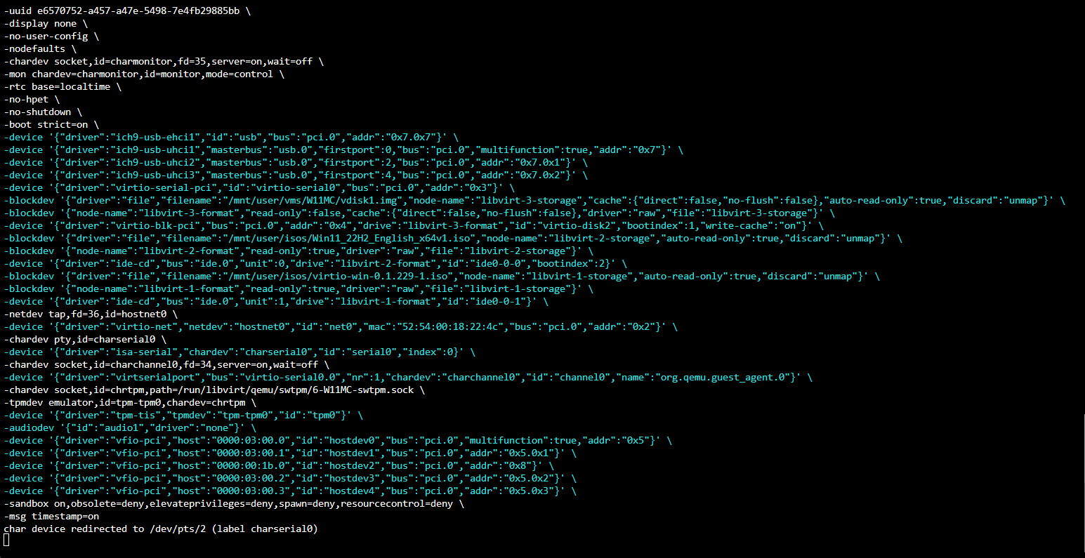

Attempting to setup a VM with GPU passthrough. (Done this before on consumer hardware, first time on this workstation/server setup)
When I build a VM with a virtual VNC GPU, it works fine - boots and runs normally. When I pass a GPU through to it, the VM starts and then hangs almost immediately (Log file attached in image). Last line is *always*:
char device redirected to  /dev/pts/6 (label charserial0)
I have done with with the GPU devices (gpu, audio, USB controller) bound to VFIO, I have done it without it bound. I have done it with the BIOS loaded (a bios I used a script in unraid to pull, a bios I pulled from techpowerup, a raw bios I pulled on GPUZ, and a bios I pulled on GPUZ and used a hexeditor to remove the nvidia header)
I have modified the passthrough device pcie slot location to match between all of the GPU devices within the VM as spaceinvaderone recommends in his video.
I have also tried this with both the i440fx-7.1 Machine and the Q35-7.1 machine.
No matter what I do, the VM hangs at the exact same spot
ALSO: I pulled the nvidia GPU and slotted in an AMD Vega 64 instead and repeated all of the above, with the exact symptoms (I have used this exact GPU in pass through on basic consumer hardware with no issue)
I am at a loss for what to try. Any advice helps!  Thanks.

can you post diagnostics

Attach diagnostics with passed vbios, attach vbios.
11 hours ago, Modna said:
Here is diagnostics with vbios attached to VM.
Thanks, I have no solution, everything is correctly, as far as I can see, configured.

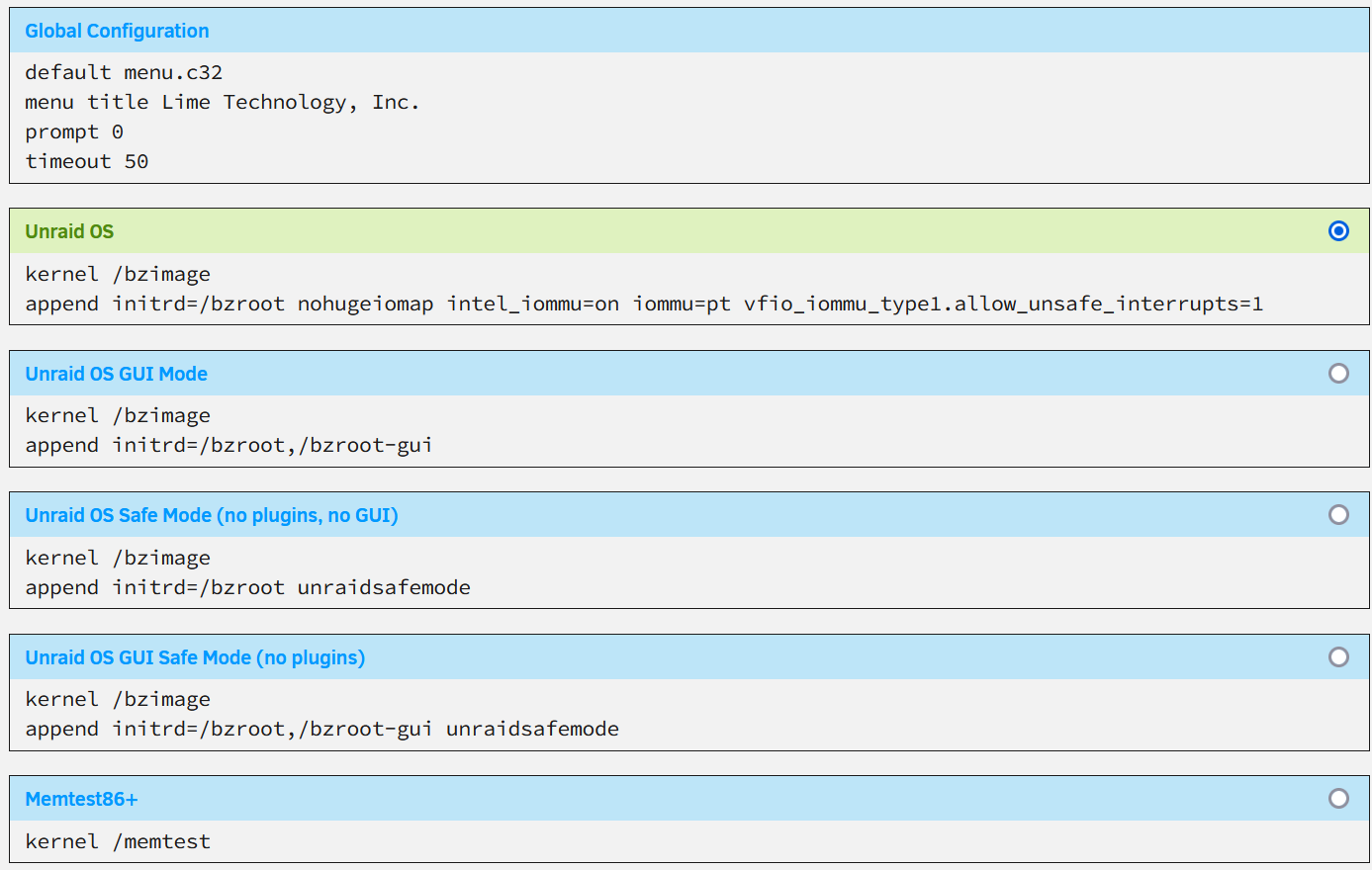

I have never done edits to the syslinux configuration - but I googled around and I don't see "nohugeiomap"
 anywhere on forums or unraid documentation. Want to make sure I actually add/edit the right thing
I found "nohugeiomap" on some archlinux documentation but I am not sure how to actually set that properly (https://lwn.net/Articles/635357/)
EDIT Just changed "append initrd=/bzroot" to "append initrd=/bzroot nohugeiomap" under Unraid OS within the syslinux configuration of the flash drive with no change in symptoms

Add this to your syslinux config (in the block of unRAID OS label): Main - Boot Device - Flash - Syslinux Configuration
label unRAID OS
  menu default
  kernel /bzimage
  append intel_iommu=on iommu=pt vfio_iommu_type1.allow_unsafe_interrupts=1 initrd=/bzroot
Reboot
Then, obviously start unraid without gui
I added those append options under "Unraid OS" within the Syslinux configuration for the flash drive (through the web browser, not manually editing).
I also have "Unraid OS" selected as default boot menu.
Unfortunately no change, exact same symptom (Ignore the "nohugeiomap", I found that recommended somewhere and tried it. No change with or without it using the new append optoins
