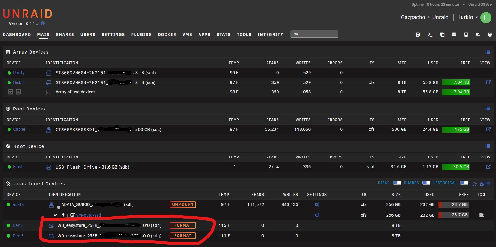

I have the two shucked drives back in their enclosures and the broken sata connector appears to be working for the moment. However, when I attach them to unraid via usb neither of them appear to be the XFS formatted data drive. That seems strange, right? I have done nothing to these besides moved them. They were removed from a working installation, I saw the data drive had the broken connector and set them both aside, deciding instead to replace them and fix the array later if I could.
Sometimes the USB enclosure alters the addressing, causing the partition not to start at the proper spot.
Any way you can hook them up direct to SATA?
Wouldn't hurt to collect diagnostics with them attached and attach the zip to your next post.

In this case, either drive should be mountable, because as long as you used the parity1 slot, the two drives should essentially be a RAID1 mirror.
It's possible only one drive will SHOW as mountable, because the XFS signature would be identical keeping the second drive from mounting.
Since you only had 2 drives, you actually might be ok.
I made a fresh unraid usb drive and booted that with only the old data drive, and it's working. I am transferring the data off and counting myself lucky, this time.
