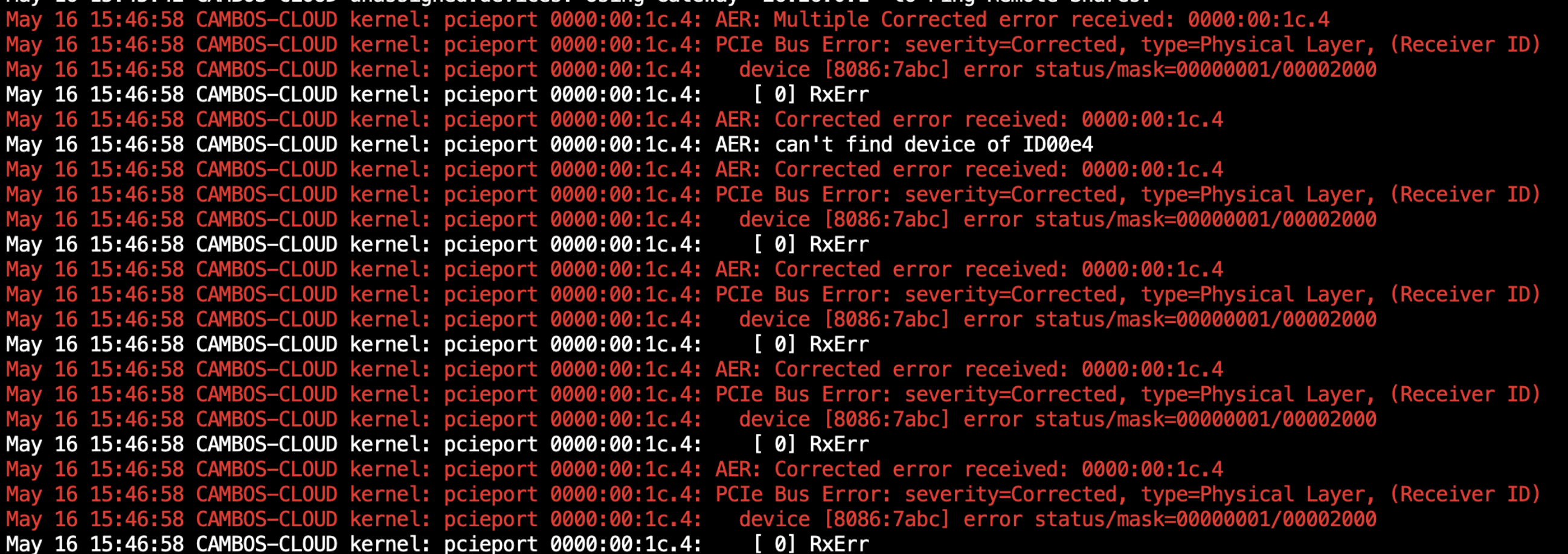

 I started getting these errors in my logs (see picture), but it's being corrected. The only thing I have plugged into a PCIe slot is a LSI HBA and it is attached to all my SAS drives. I had no issues in the past, and all hard drives are working fine. But this is bothering me, seeing this in the logs. Can anyone please tell me what this is and how to fix it? I would greatly appreciate it!

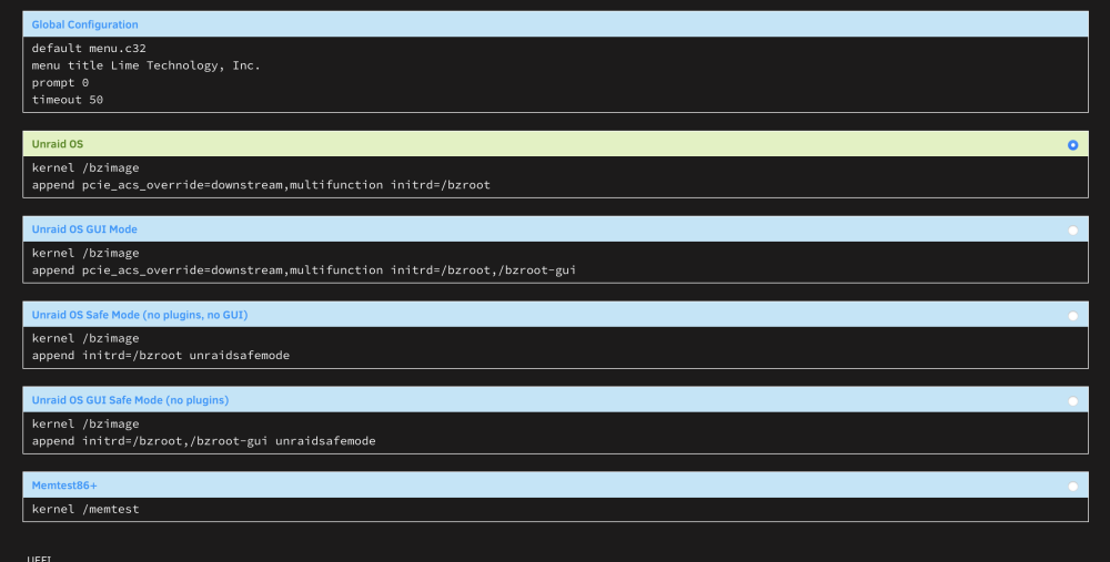

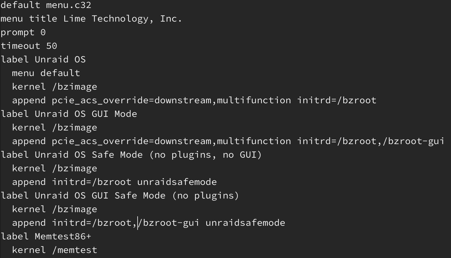

Yes, I used the menu view button and it brought me to the screenshot I posted. I have couple of "append initrd=/bzroot", which one should I use to input "pcie_aspm=off "?
10 minutes ago, JorgeB said:
That's easier

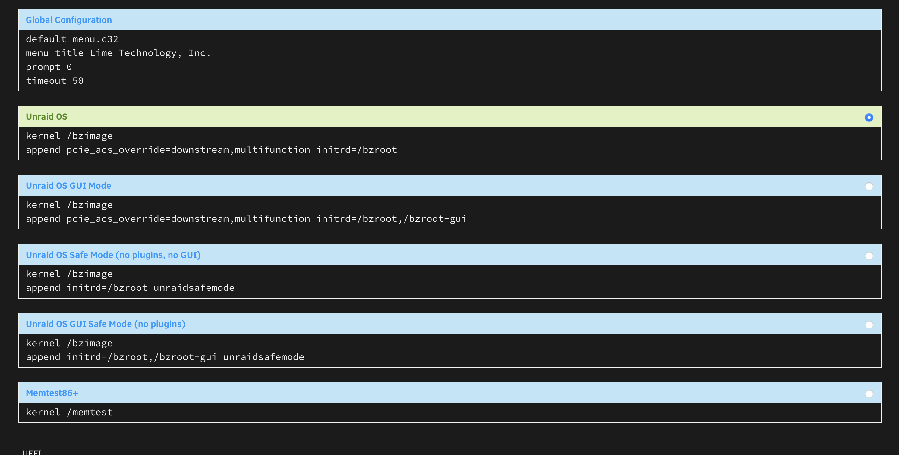

Sorry, I seen the menu view button and click it. I now see what you're talking about. Here's the screenshot, under what which  "append initrd=/bzroot" should I input the new command? Thanks!

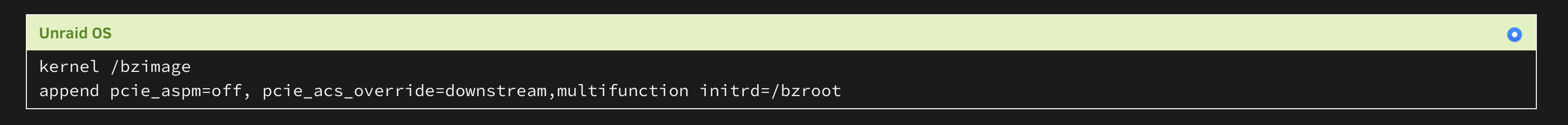

Hello,
I added the "pcie_aspm=off" as instructed and rebooted, done it several times, but the errors are still present. Am I doing something wrong? Thank you for your help.
I am on Version: 6.12.0-rc5.
Edited by CAMBO
To which menu option?
The Unraid OS. My last screenshot shows it. Not sure if I did it correctly. Please let me know. Thank you!
If that one doesn't work try pci=noaer instead, it should at least suppress the errors.
It's been couple of days now, and the "pci=noaer" is working so far. Thank you!!
