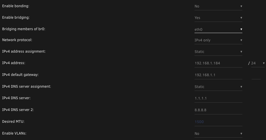

  • Network configuration: Onboard NIC set to the following

I've narrowed the issue down to the IPVlan vs MacVlan setting in Docker. On MacVlan the WAN access from unraid is maintained. On IPVlan the issue persists.
