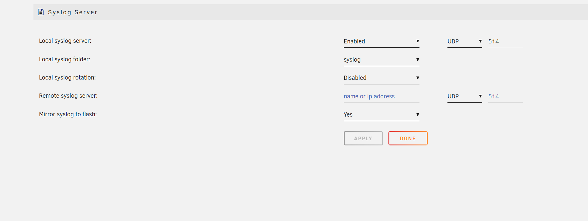

System crashed again over night. There is no log file. The syslog server is running when the machine is up.
Try using the mirror to flash drive option in case the server is not correctly configured, if you then for example just stop and re-start the array something bust be logged.
The settings for saving the log seems pretty simple. What could be misconfigured on my end? I have attached a screenshot of the settings. The syslog from the flashdrive is attached. Thank you for the guidance with this. 489519140_Screenshot2023-05-22071552.thumb.png.6b05c367139f1d48613b2ee1485b0814.png
syslog
Edited by Gnashy
Unfortunately there's nothing relevant logged, this usually points to a hardware issue, one thing you can try is to boot the server in safe mode with all docker/VMs disabled, let it run as a basic NAS for a few days, if it still crashes it's likely a hardware problem, if it doesn't start turning on the other services one by one.
