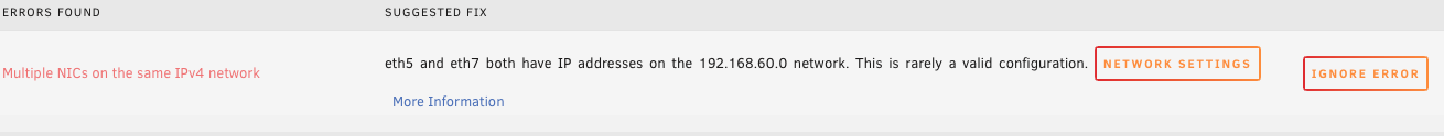

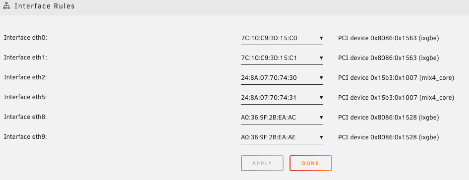

Network issues: Fix common problems refer to Nic not visible.....
I have some issues in my Network, Fix common problems refer to a Nic not visible in the GUI. At the same time I have a lot of stuff in the Routing table, which I can't remove. I tried to reset Network once, but the I had strange behaviour from the Nic, moving setting between onboard Nics and pcie NICs. In the server it is 2 NICs and a pcie card (Intel 540) with 2 NICs.
Hope anyone can share some light on this.

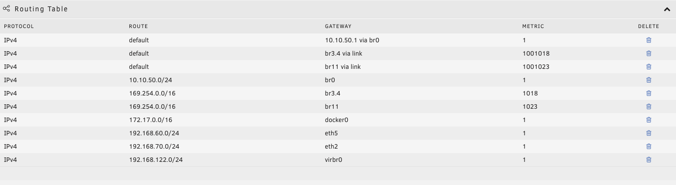

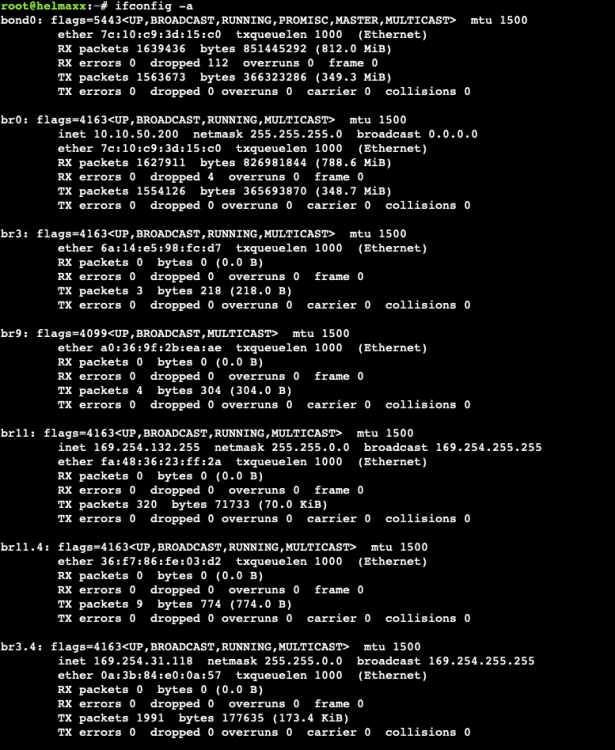

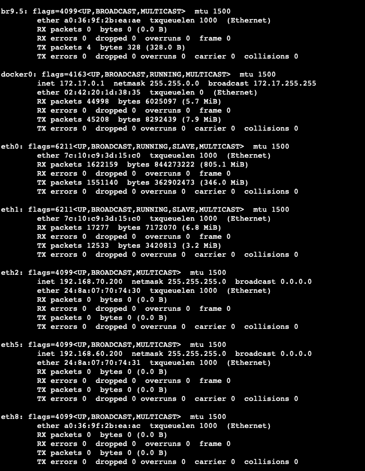

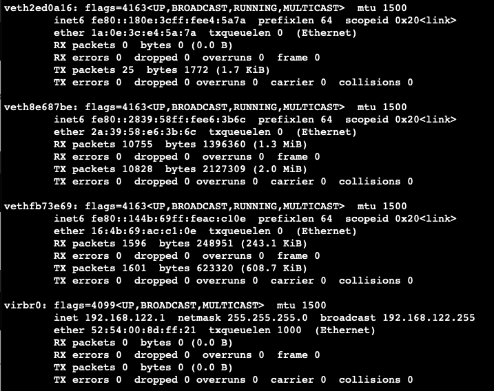

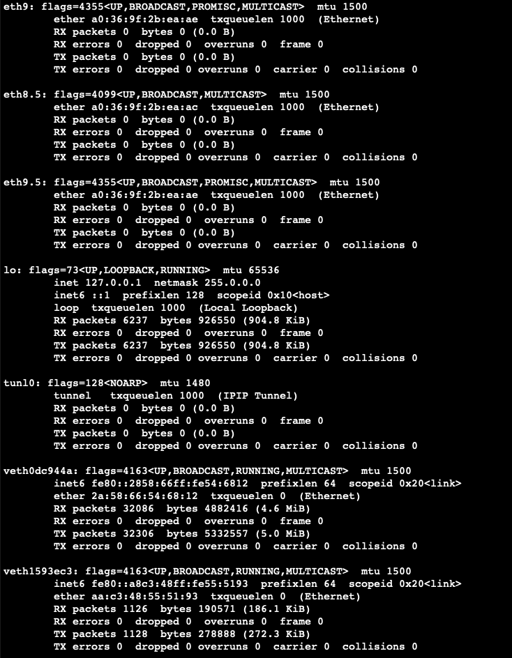

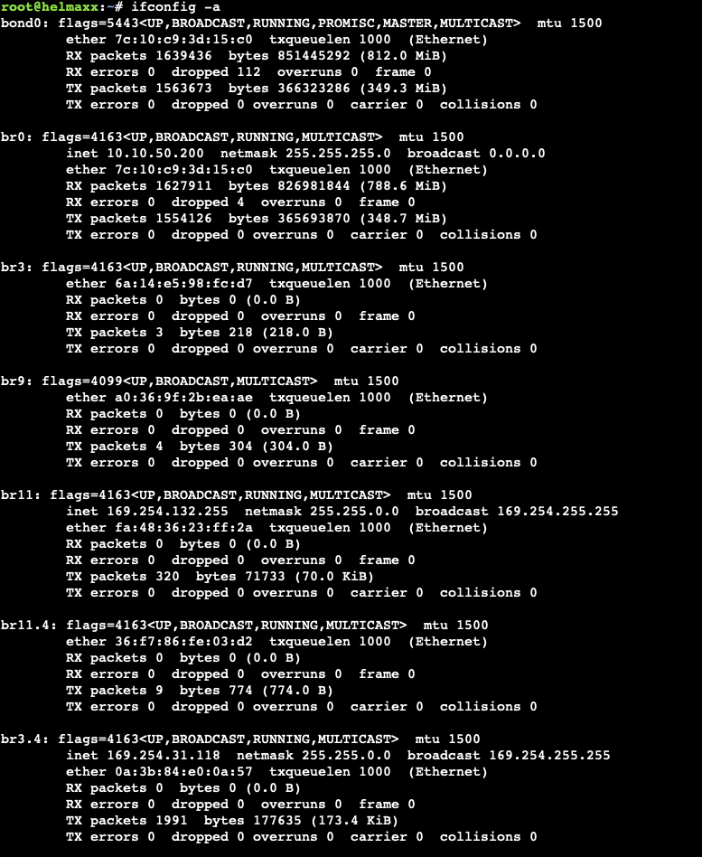

 Here's the list (bunch) of networks:

Ok. How can I delete or disable ethXX which are not in the GUI or not as NICs in the Server?
Make a backup of /config/network.cfg on the flash drive
Then first try making a change (any change) to the bond0 / br0 entries and apply.  If it didn't refresh it to get rid of the extraneous entry,
try to edit it (any editor should work) and delete this section
IFNAME[5]="eth7"
PROTOCOL[5]="ipv4"
USE_DHCP[5]="no"
IPADDR[5]="192.168.60.200"
NETMASK[5]="255.255.255.0"
 and then all the sections after it rename them from [6] to be [5], [7] to be [6] etc.
IFNAME[5]="eth7"
PROTOCOL[5]="ipv4"
USE_DHCP[5]="no"
Thanks. Forst I removed every IFNAME not in the GUI list. Then I could connect to the Server. Then I deleted the "network.cfg" file and restarted. I seems to be ok now.
