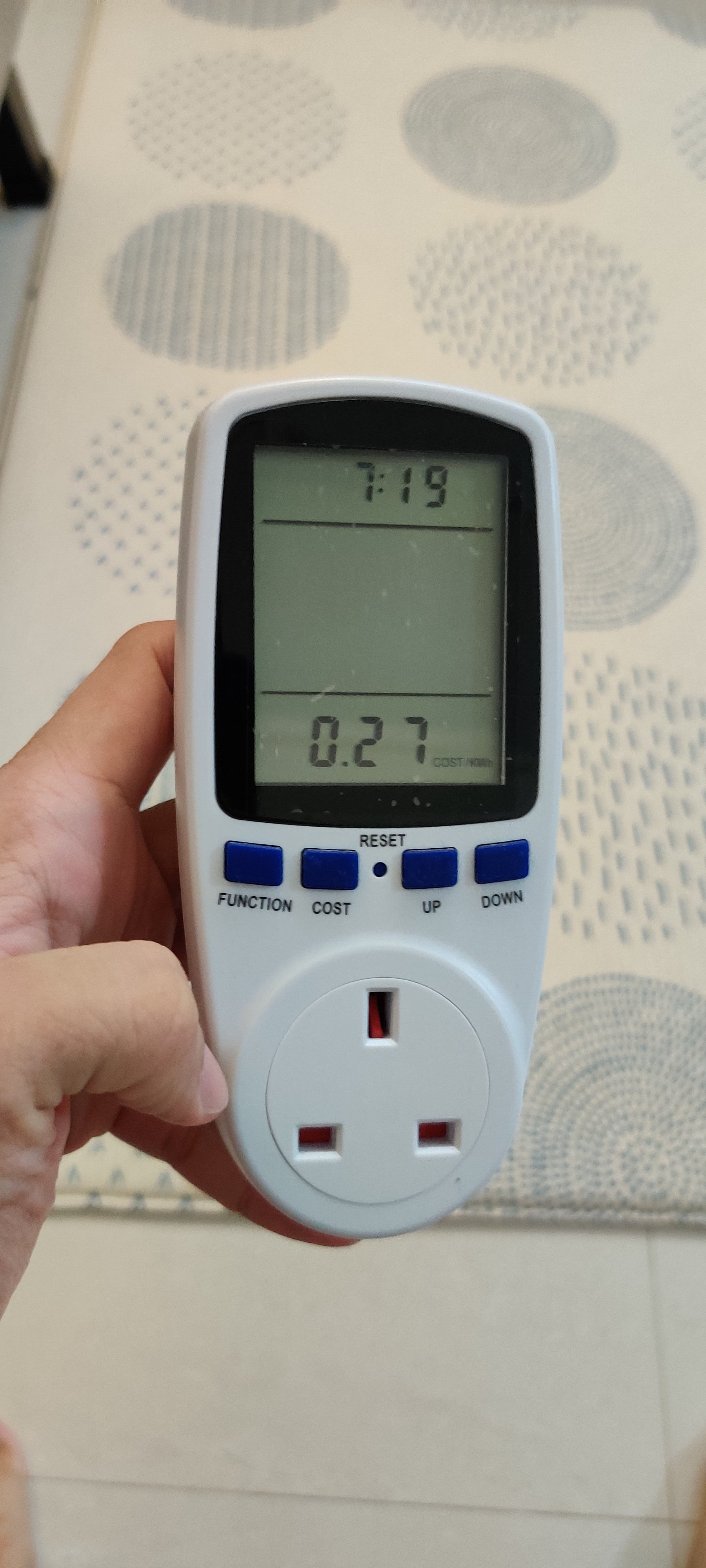

After I fully assembled the server, and turned the server on with a electrical monitor (attached). The server booted. But after I turn off the power and restart the server. The server is unable to boot.

But can I find out if
A electricity monitor can blow a PSU?
Very unlikely. The monitor only take reading and provide switch on off function.
