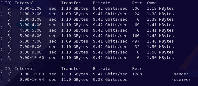

You have many retr, this abnormal.

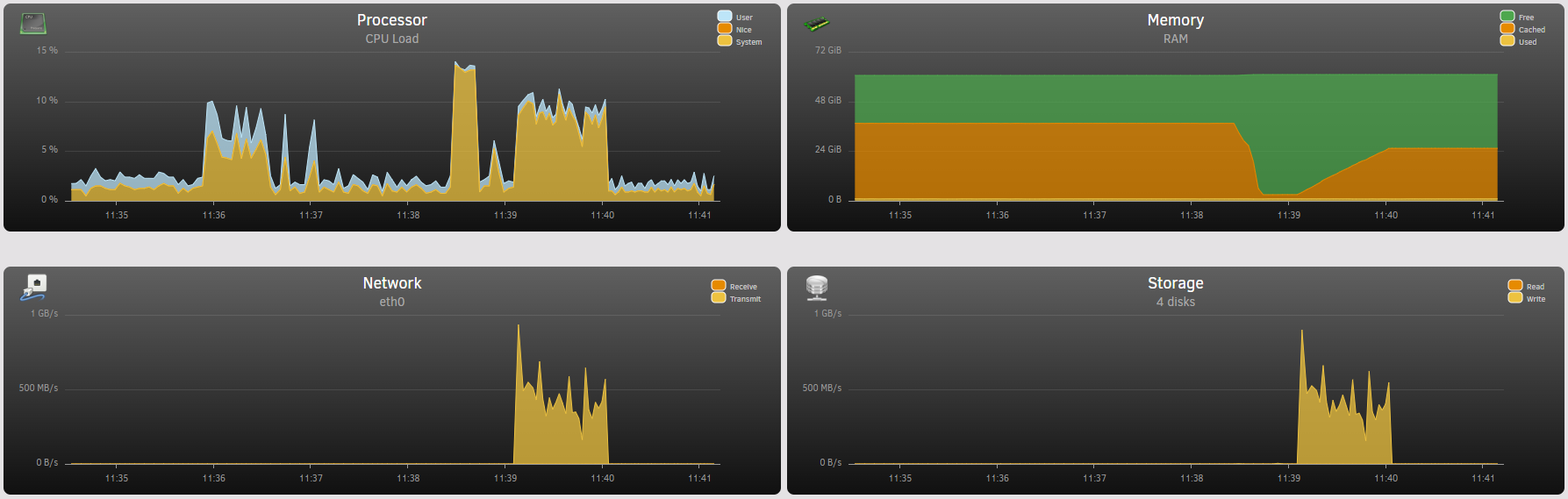

Below are some capture FYR, SMB read and write. on 6.12.rc6 ( NIC 82599 and NVMe SSD, MTU1500 ), if I test on a slow SATA SSD, then throughput less then half.
2nd PIC are flush the RAM cache, real through physical SATA SSD.

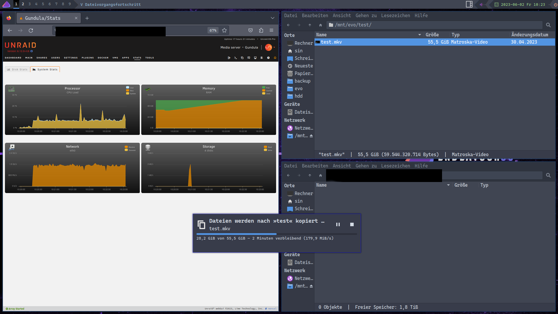

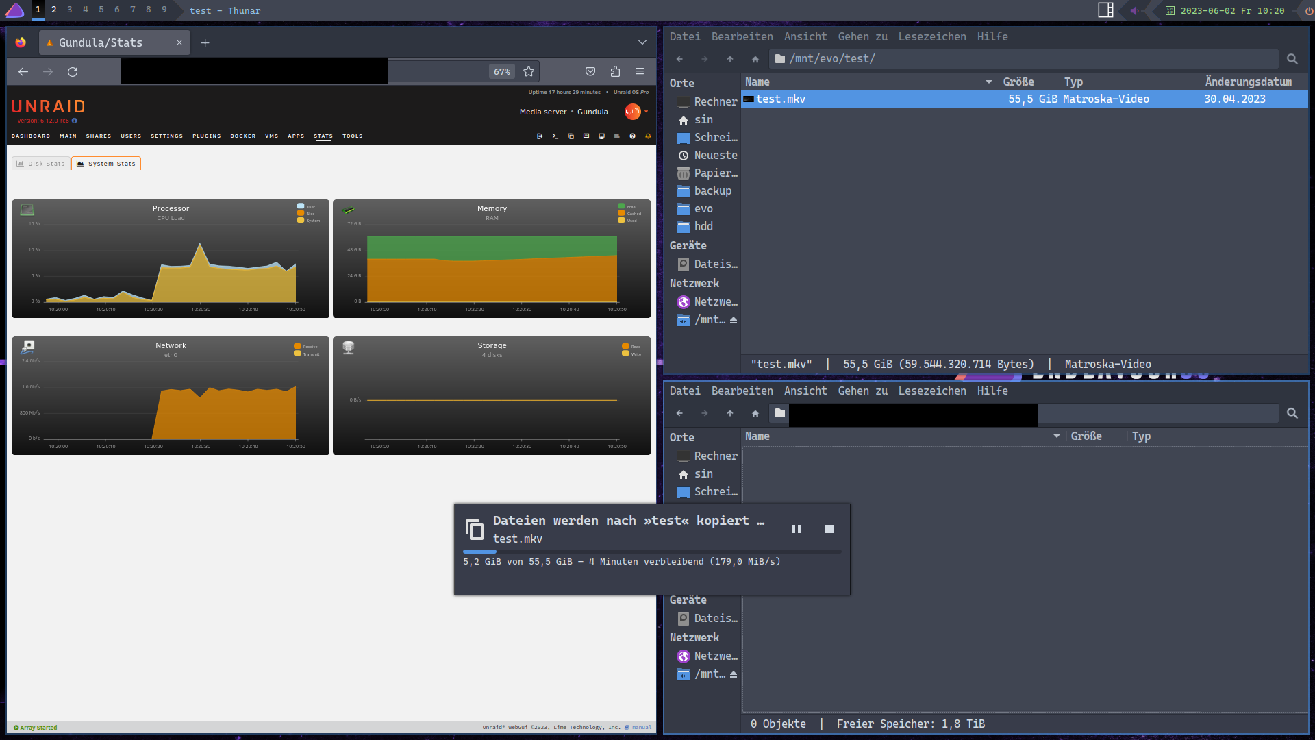

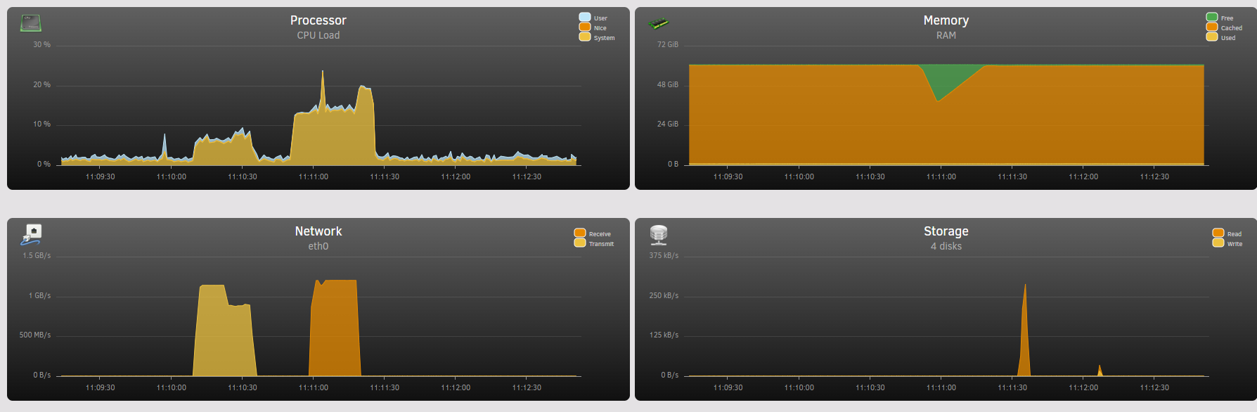

The only Windows PC in the house is unfortunately not mine. Therefore I don't always have access to it. But if Linux is enough for you then I have made a couple of screenshots during a transfer. On the screenshots you can also see the statistics of the Dynamix System Statistics Plugin during the copy.
The diagnostic file was created directly after the transfer.
gundula-diagnostics-20230602-1026.zip
But file transfer bar show that transfer in 180MiB/s, just Unraid show have 1Gb/s network traffic.
