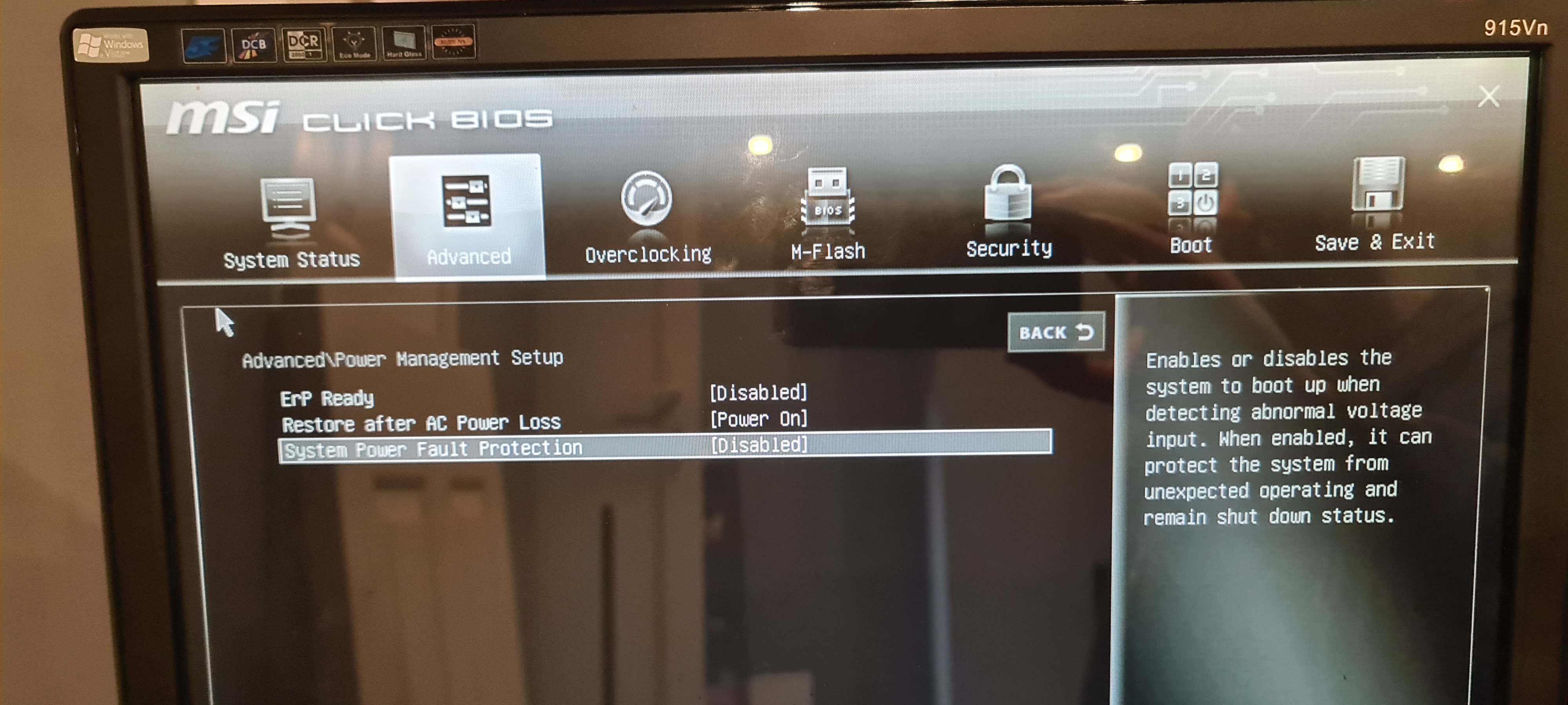

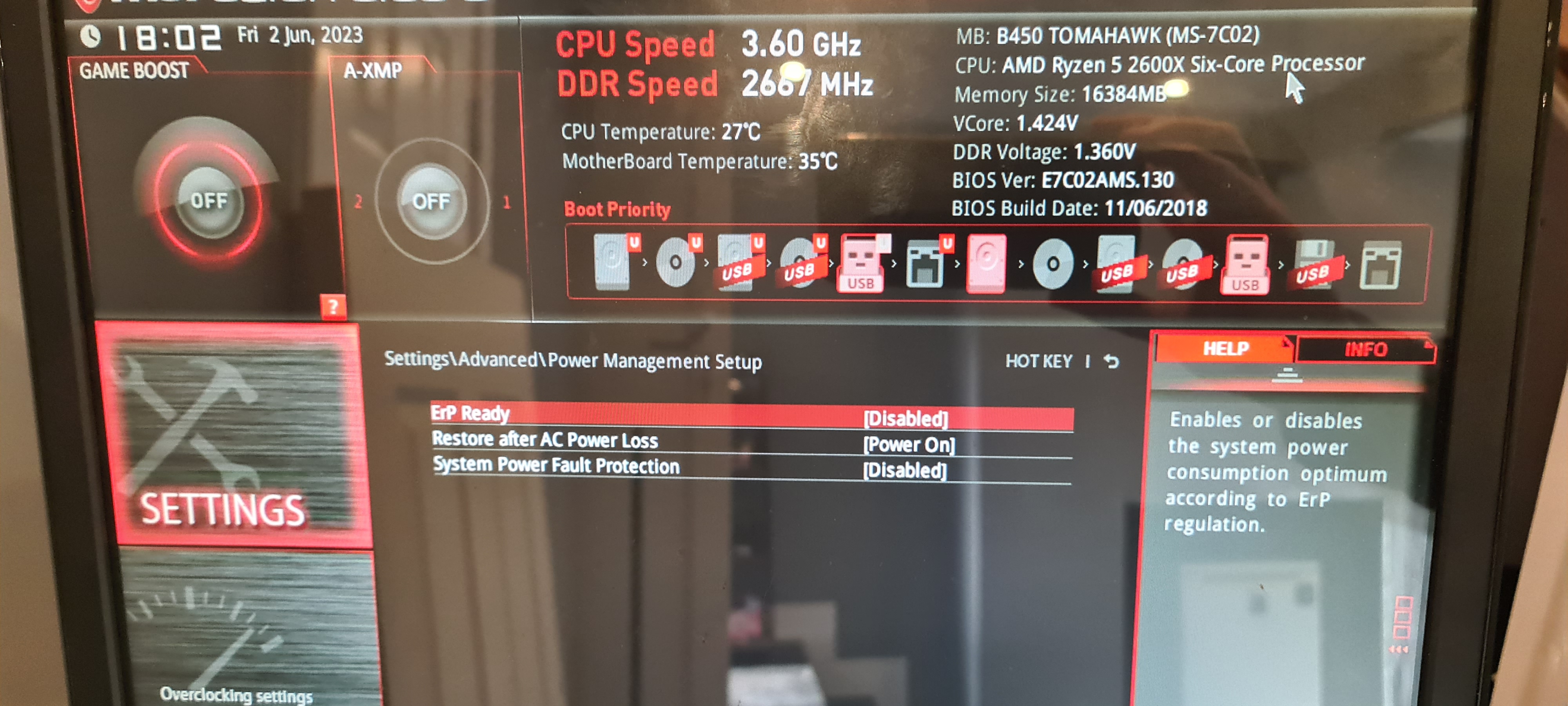

So check under power settings on bios and does not have it. BIOS not updated since 2018 about to update to latest bios

Updated bios and still can't find that setting anywhere

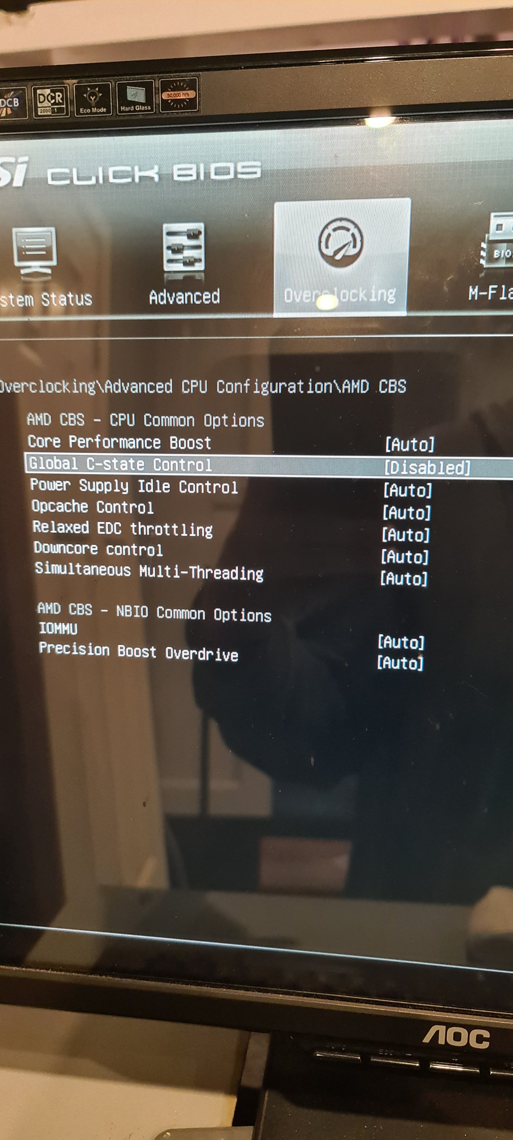

Found global c states and disabled

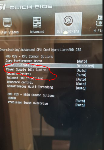

It's right below that setting:
Omg didn't even notice, since i disabled c state the server has been on 13hrs.
Would recommend i change the power supply idle also or leave as is?
