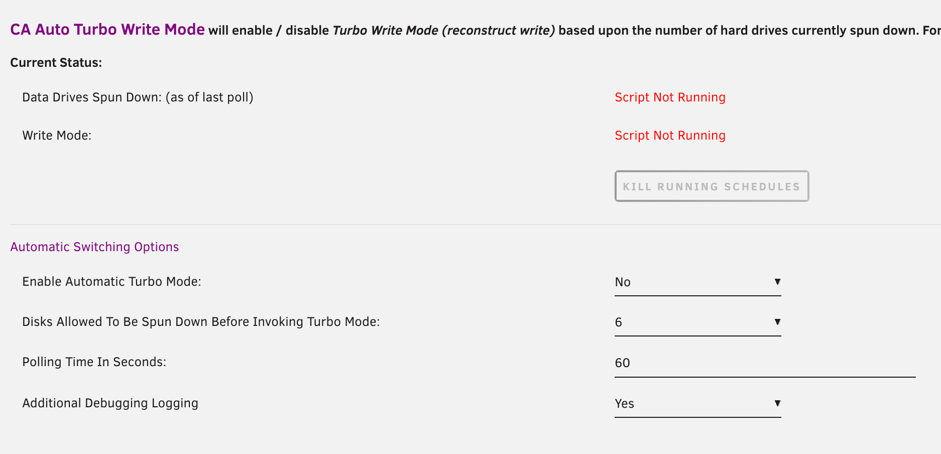

It won't change on its own unless you have the "turbo write" plugin installed, if it is and configured wrong it could flip it back to R/M/W.
I do but: That plugin also claims "reconstructive write" active. I set the number of disks to maximum (so it should never kick in and reduce it). And in order to make sure it does not fiddle with it I disabled it.
The setting under Disk settings does still show
md_write_method = reconstruct write
and the plugin is disabled.
Still believe me: After a while disks are spun down and I do see reads only from the spun up disks. Once I manually spin all disks up things are back to normal. VERY confusing.
