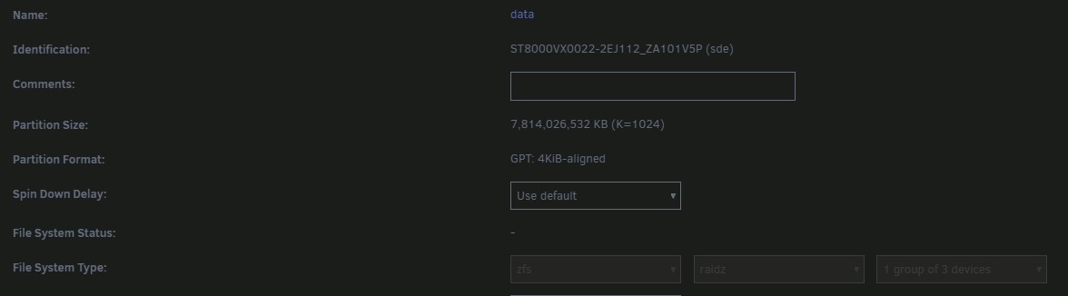

So I have created a pool and formatted that with ZFS (first printscreen).

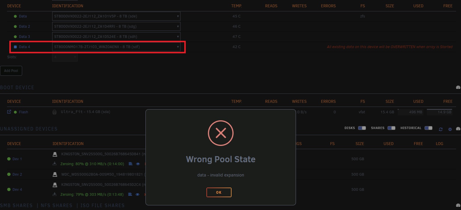

And now I am struggling to extend this pool...
I have no critical data on the drives so i can also start from scratch, but why can I not add a new disk to the pool (error on the second printscreen)?

Assuming you are using using raidz1 for the 3 device pool you can only expand it by adding a new vdev of the same with, so another 3 disks.
With ZFS you need to think more upfront about how you want to end up because ZFS is far stricter about what is allowed when adding additional drives.    This is the big disadvantage it has against using BTRFS pools which can be easily expanded and can have drives of different sizes.

One of the limitations of ZFS is that if you have a pool with a vdev size of 3 drives you can only extend it with another vdev of 3 drives.

Add 3 new disks, or recreate the pool with 4 disks (will need to backup first).

That's how zfs works, like mentioned by Itimpi it's not very flexible, like for example btrfs, either use a different file system or things should be planned for the future.
