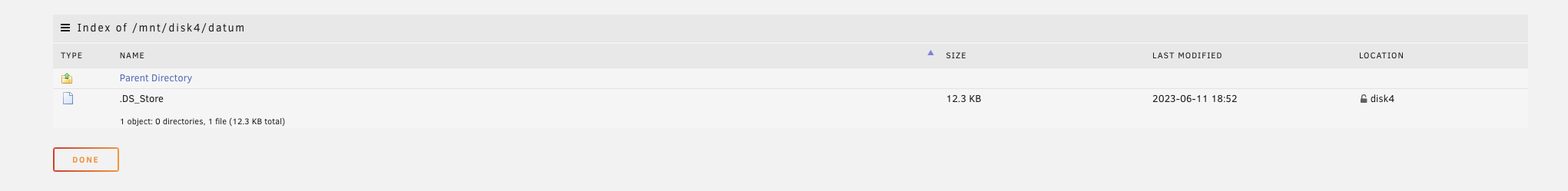

I have a user share called 'datum'. That user share is using a cache-only disk (8TiB). I'm using this disk/share to host torrents that perpetually download and seed.
The cache summary card on Dashboard correctly shows the size of the cache disk as 8TiB. Main tab shows the size of the cache disk correctly. Under the Shares tab, it shows the size of the disk as being 16TiB. How is this possible?
The share is set to use cache-only and it is not set to use any of the disks1-5 in my array.
https://imgur.com/a/KxeGH9V
Solved by JonathanM
To add further curiosity - it seems like under the shares, if I calculate them, then it shows disk 4 (8TiB) is allocated to this share as well. This might explain how I got to 16TiB but I have no idea why. And, you can see that when navigating into disk4, it shows a folder called 'datum'. But it's empty.
Remove the empty folder and the calculation will go back to the single volume size. All root folders on all array drives and pools are part of the share, even if they are empty.
Can you help me understand that better? Did it show the drive size being larger because 'datum' showed up on disk4 and also on seedbox?

Yes.  It includes the sizes of all drives that have the top level folders.
So just by the circumstance that I accidentally created a folder called "datum" in disk4 and I have a share named datum on a cache disk, it thought -- "hmm must be the same; therefore, 2x the size"?
It's not arbitrarily 2x the size, it's the sum of all disks and pools with that share root folder.
If the root folder has the same name, it's contents will be displayed together with all the other same name root folders in the user share tree.
That's a useful bit with user shares, you can have bulk storage and fast access files all displayed in the same tree, and move them as needed. The traditional use was to set a share to cache:yes, that terminology has been replaced with the current 6.12rc series, but the functionality was that new files added to the share would go to the fast cache pool, then overnight the mover would transfer them to the array, which has a much slower write speed. The file still appears in the same path, /mnt/user/sharename/filename regardless of whether the file exists on /mnt/disk1/sharename/filename or /mnt/pool/sharename/filename
