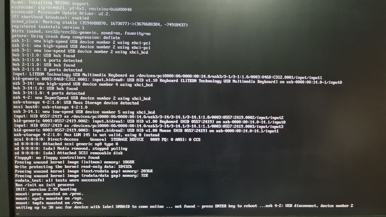

The same happens to me, every time I need to reboot the system it breaks and need to regenerate the USB stick. So annoying. I upload here a picture of the log (IPMI not working properly). Of course nothing has changed, the pen has UNRAID label and the data is as is.let
