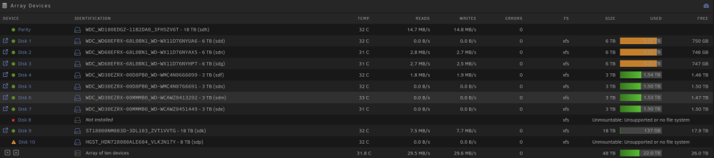

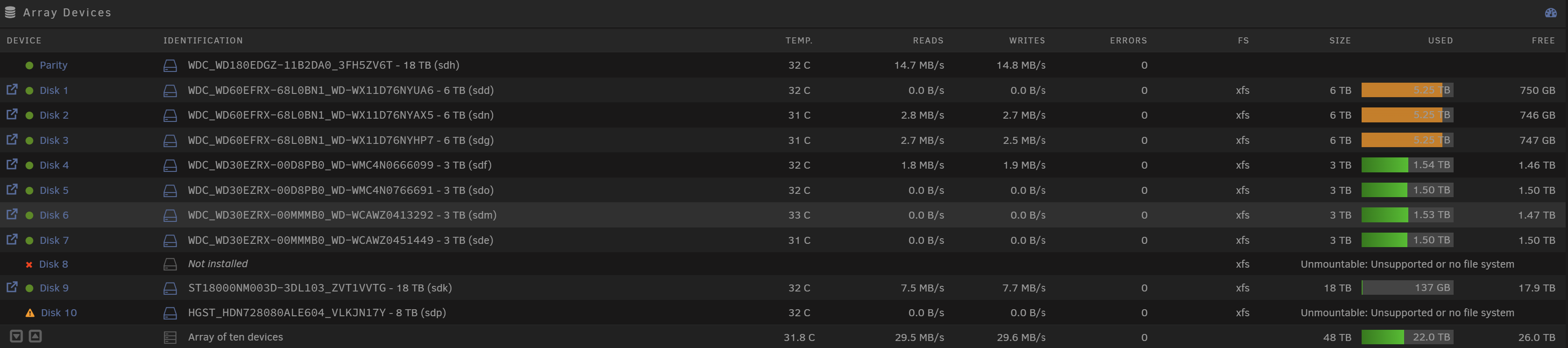

After reassembling, i booted unraid and started the rebuild of disk 10 (as referred in the screenshot).
During this, the connection broke down again. I believe the card is toast and dies when getting too warm (it's pretty warm here the last few days), even with new thermal compound and a directly attached fan.

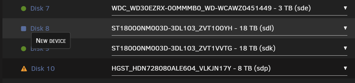

The issue now is, that the rebuild of disk 10 hasn't finished and  disk 8 showed also suddenly as "disabled - content emulated." And this is where I made a mistake I think...

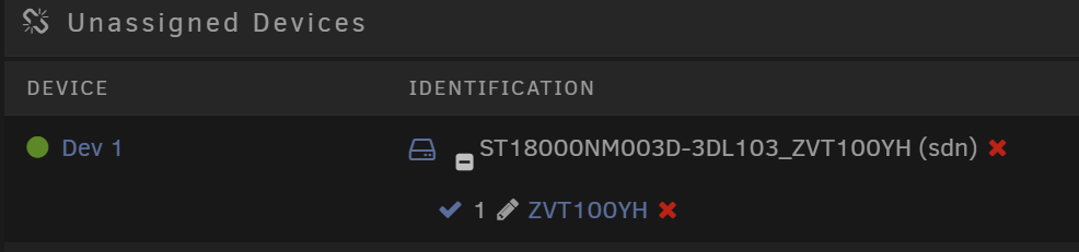

I stopped the array, set the failed disk 8 to "disabled", started the array in maintenance, stopped it again and tried reassigning the disk to slot 8. But now it shows as a new device... I can power up the array only when i set disk 8 to unassigned, otherwise too many disks are missing / changed.
I don't want to carry on with the rebuild of disk 10 with this shot HBA, a new one should arrive tomorrow.
However, will I be able to fix this situation at all and what would be the best course of action? Will I be able to correctly reassign disk 8 after disk 10 has been rebuilt, or is the data on disk 8 gone and I have to add it as a new device?
The partition is still there in unassigned devices and my array is only 30% full, so if I can save the files somehow, that would be great. The files are not irreplacable, but nevertheless would be a hassle to aquire again.

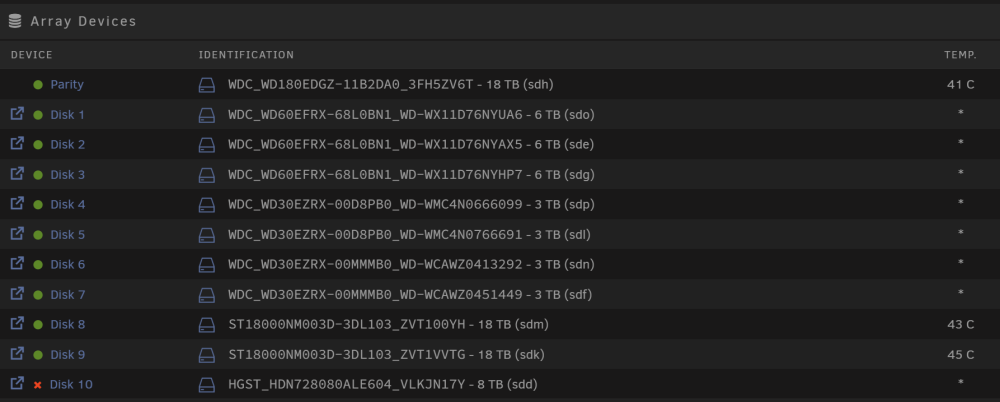

There you are. I've just installed a new HBA, it says Data Rebuild but the two discs affected by the outage show up as unmountable
wonas-diagnostics-20230623-1637.zip
Unraid cannot emulate two disks with single parity, what happened to disk8? It's not even assigned.

It's showing up as new. The data on it is still accessible when mounted through unassigned devices, but I cannot reintroduce it into the array like this. And I also can't check the filesystem, because if i assign both, I cannot start the array due to 2 missing/new disks with single parity.

SMART looks OK, I assume disk8 was the seconds one to get disabled? If yes we can force enable it to try and rebuild disk10, assuming parity is still valid.
Yes, Disk8 suddendly showed up as dead.
How can I force it back into the array? I believe parity should still be valid and the disks should be fine.

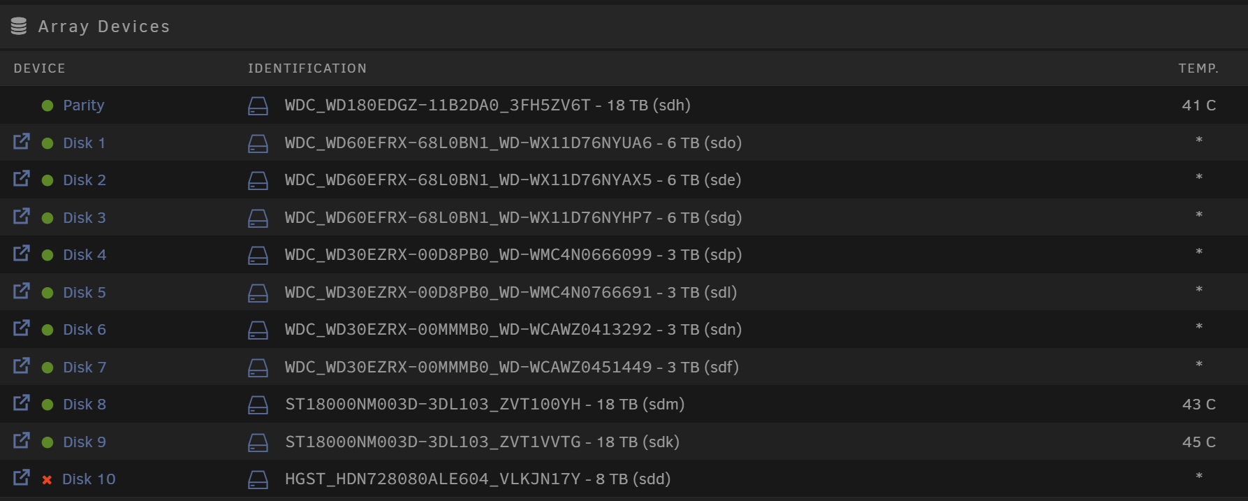

disk 5 had problems negotiating a link, even with new cables. Now after some up and down the array is up. disk 10 reports as being emulated and i only can perform a read check but no rebuild of disk 10...
I think if i will be able to restore the array in full, i immediatly should move all files from these old disks, some from 2011 to the newer 18tb drives...
Can I rebuild disk10 which currently appears empty in the array or should I wipe it and readd it?
