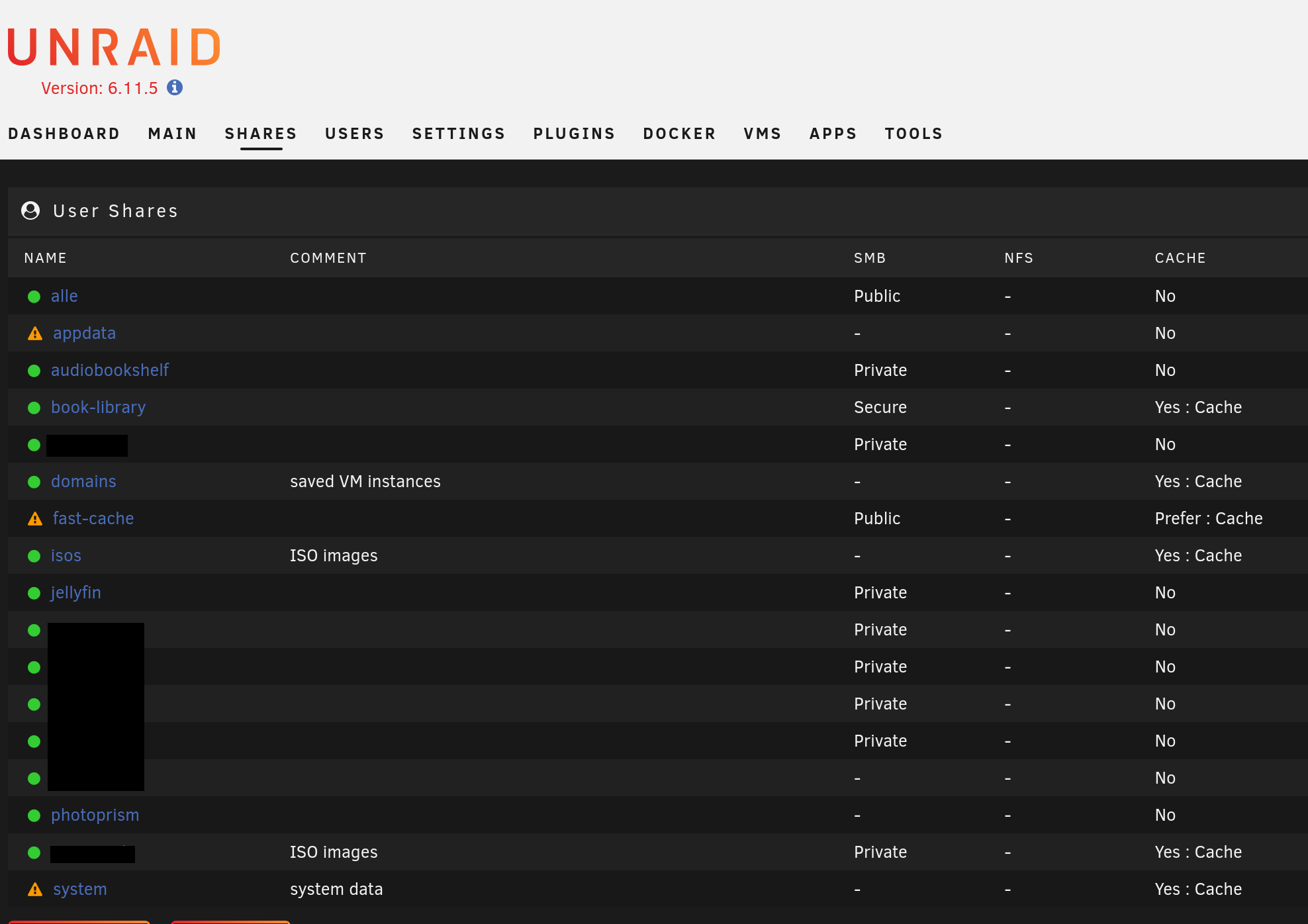

I have attached a screenshot of my share menu. Is there something obviously wrong there maybe?
Edited by J0hn_Lawrence
Unlikely to be a cache device problem, could be RAM, but not seeing any other indications pointing to that for now.
