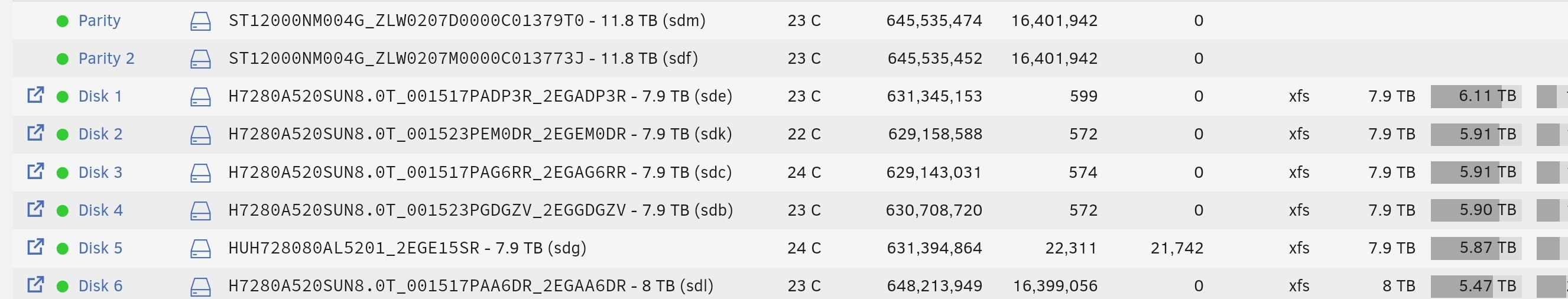

I put the cold spare in and it started rebuilding. During the rebuild process I went to check if plex and other apps needed updates and received an error saying the server couldn't connect to github and an error message saying it couldn't write to a file in the usr/local share. That had happened a few weeks ago and the "fix" or work around was to reboot the server 🙄 unfortunately due to the error the server sees it as an unclean shutdown and stopped the data restore and kicked off a parity check instead (I hope that didn't delete 5 to 6btb of data 🤬)... During the parity check the "spare" drive listed over 1 million errors (very close in number to the number of writes on the disk). I paused the parity check, stopped the array put the replacement drive in the system (removed an unassigned drive) and restarted the array, at this time unraid disabled the "spare drive", I looked at the logs on the replacement drive and it has a bunch of smart errors as well 🤬
I then looked at all the drives, and out of the 9 spinning drives 6 are showing errors in the smart logs, most are delayed read errors, but there are some delayed write and verification errors as well. NONE of the ssds have any errors and 1 12tb and 2 8tb drives show no errors!

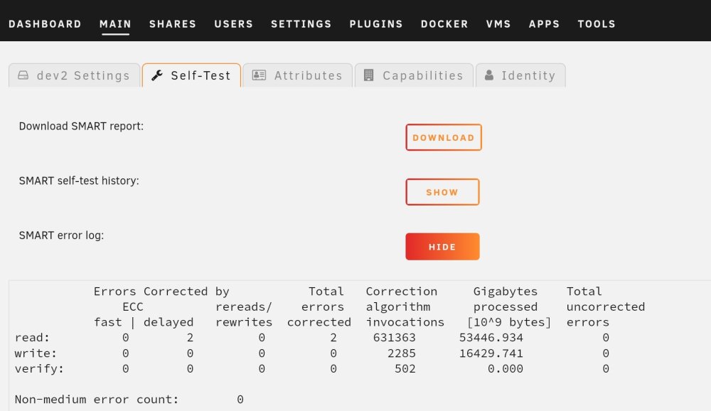

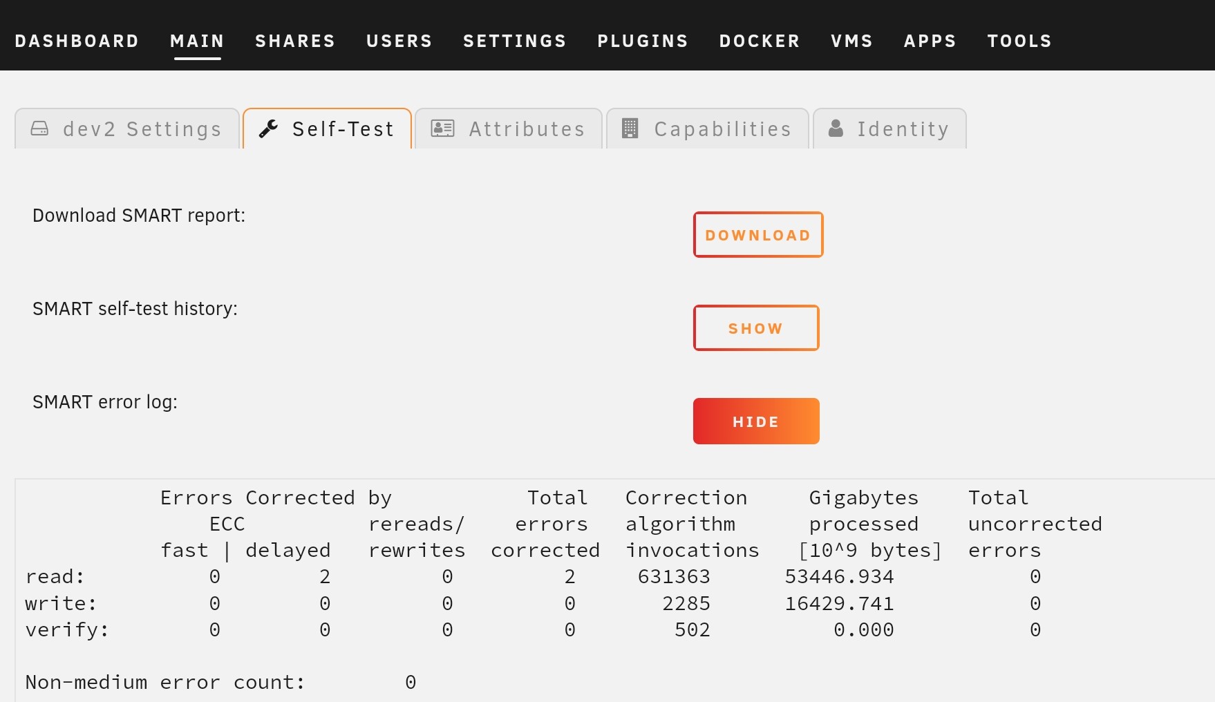

In the smart scan logs, they are all corrected I attached a pic of the logs for the drive unraid disabled, it had somewhere in the 1.5 million errors shown on the main screen while rebuilding the drive. Even though smart onlh shows 2 errors.
Bill
The disk above would have been disk 5 in the diagnosis

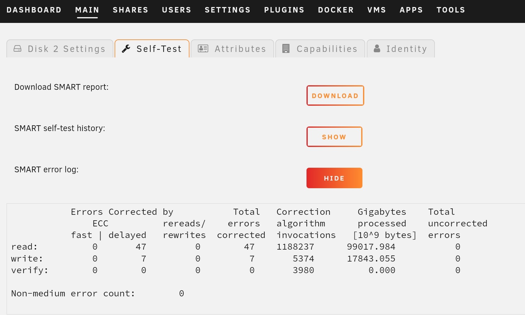

Here is disk 2 with more errors in the log BUT 0 errors showing on the main screen in unraid, and no unraid errors or warnings.
Those are nothing to worry about, a non zero "Total uncorrected errors" will usually indicate a problem.

If these are "nothing to worry about" why did disk 5, with only 2  corrected delayed read errors, throw over 1.5 million errors in unraid while rebuilding data (drive replaced) and unraid disabled the drive?
Sorry not trying to be confrontational just trying to understand why a drive with so few errors that are usually "nothing to worry about" would be toasted by unraid....
While I'm not happy about the drives having errors, I'm more worried about something else happening on the server that I was hoping would have shown in the logs.
