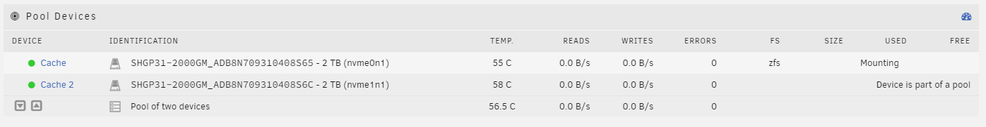

Here is the cache pool stuck at "Mounting"

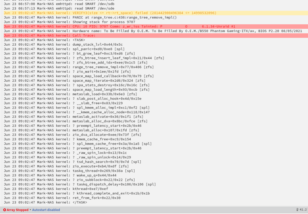

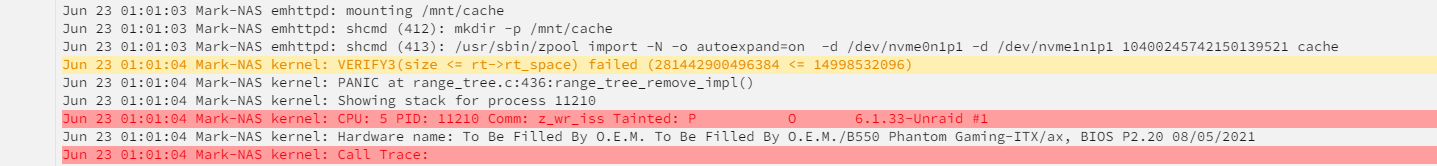

I then checked the System Logs and see this which likely is an issue:
However being a complete noob with ZFS, I'm not sure where to start.  Could someone help point me in the right direction?

Would the diagnostics when the array is stopped be of some use?  I did comb through them and didn't see anything that stood out which is why the screenshot of the system logs looks like the best information I can pull when the array is trying to start.

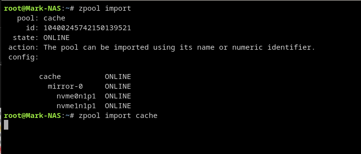

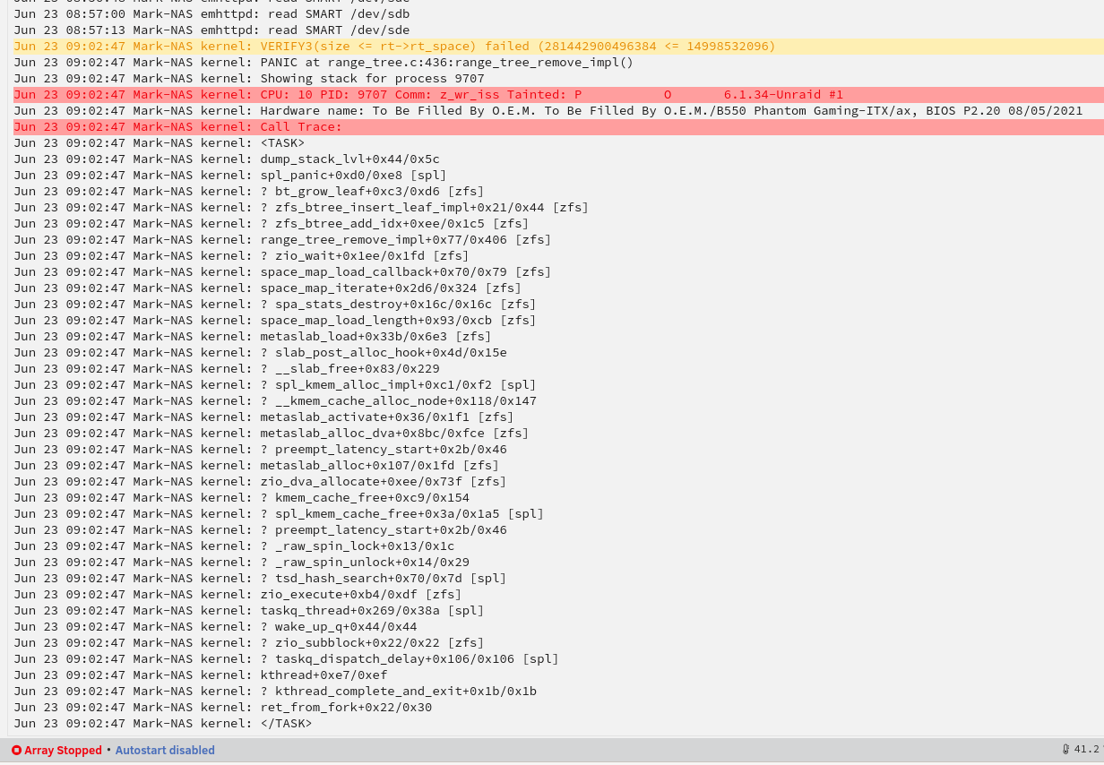

Thanks @JorgeB here's the output of zpool import and diagnostics attached.  I also added a screenshot of the System Logs when I try to run the import.
Looks like it's bumping into the same issue and attempting to generate the diagnostics after I tried to run zpool import gets stuck at the same spot.
That's expected, since it's importing the pool the same way Unraid was trying to, pool corruption can be the result of a RAM issue, it would be a good idea to run a couple of memtest passes before proceding, then you can try importing the pool in read-only mode:
zpool import -o readonly=on cache
If it works backup and re-create the pool
