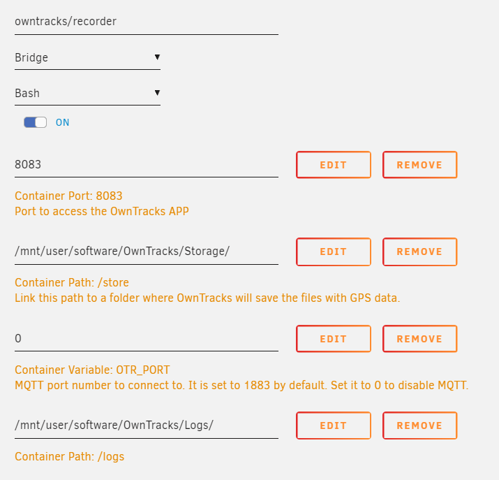

I solved the problem, the docker configuration was wrong. Here there's the right one. The configuration file is not necessary anymore with this simple configuration.
docker run
  -d
  --name='Rec'
  --net='bridge'
  --privileged=true
  -e TZ="Europe/Berlin"
  -e HOST_OS="Unraid"
  -e HOST_CONTAINERNAME="Rec"
  -e 'OTR_PORT'='0'
  -p '8083:8083/tcp'
  -v '/mnt/user/software/OwnTracks/Storage/':'/store':'rw'
  -v '/mnt/user/software/OwnTracks/Logs/':'/log':'rw' 'owntracks/recorder'
Also, on the mobile device all the HTTP request must be submitted to the /pub endpoint.

So I just downloaded and installed the docker, can you elaborate on the settings you show and where I enter in the info? And are you just using you external IP address or using an cname?
Hi thanks for the reply I set it up about the same as you posted it works for a while but then on its own goes into an error :
warnOwnTracks: OwnTracks HTTP response: 408, with error: Unknown Exception.
This show in Hubitat Owntracker and recorder does not connect any longer. it's external IP screen shot of my configuration.
