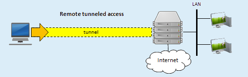

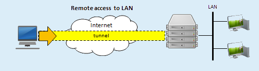

The use case I'm looking for is Laptop Remotely to Internal Network local use.  I believe this is either what WireGuard calls Remote Access to Lan, or if possible and even better, Remote Tunneled Access (this would be preferred, but not required).

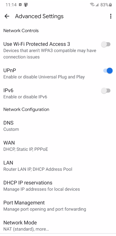

I have tried UPnP set to YES and NO as well, and have not had this help.  UPnP is enable in the router settings.

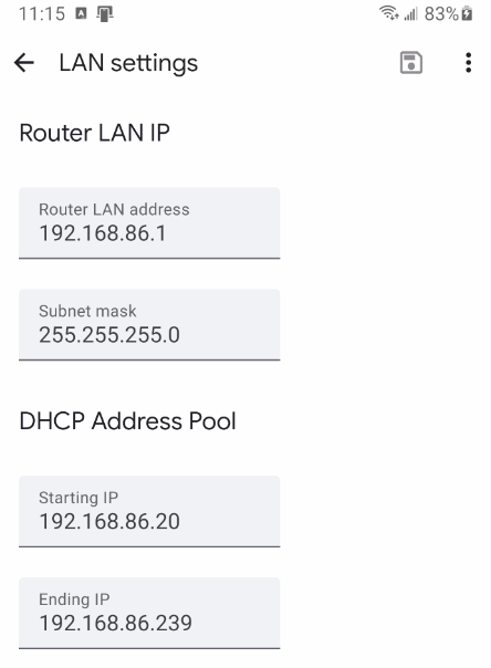

Here are the router Lan settings:

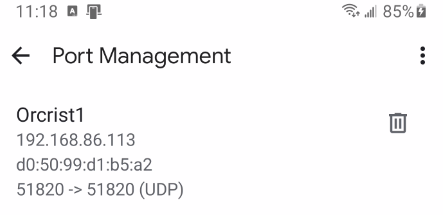

Router Port Forward Settings:

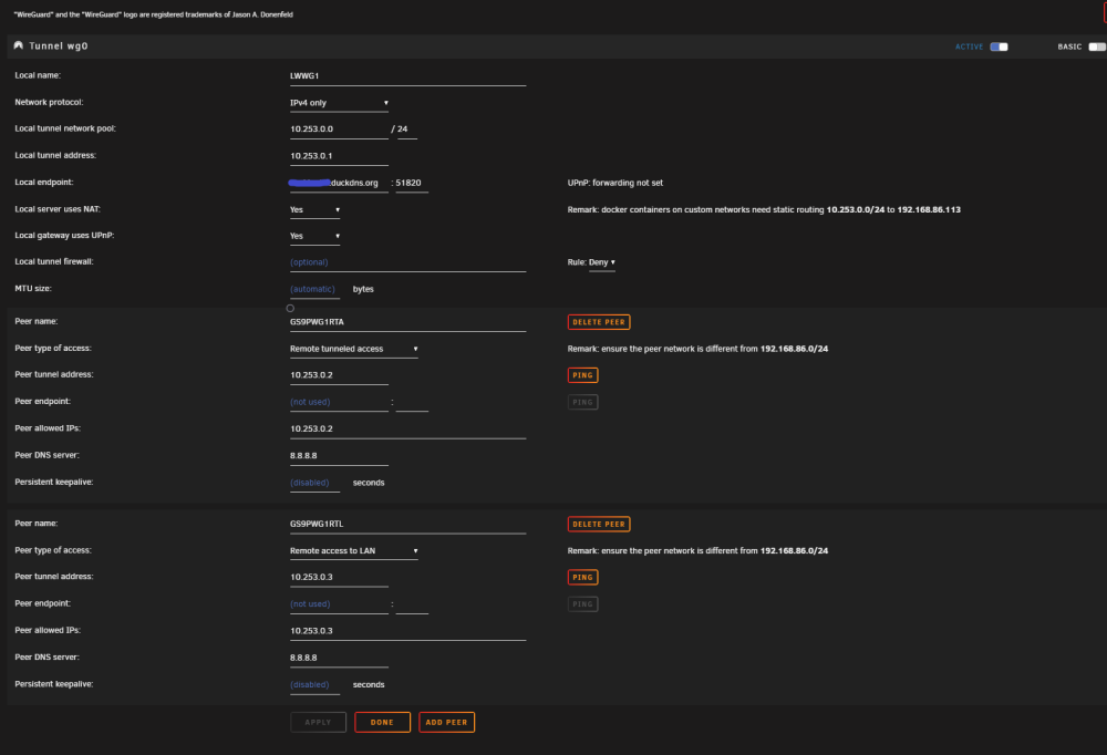

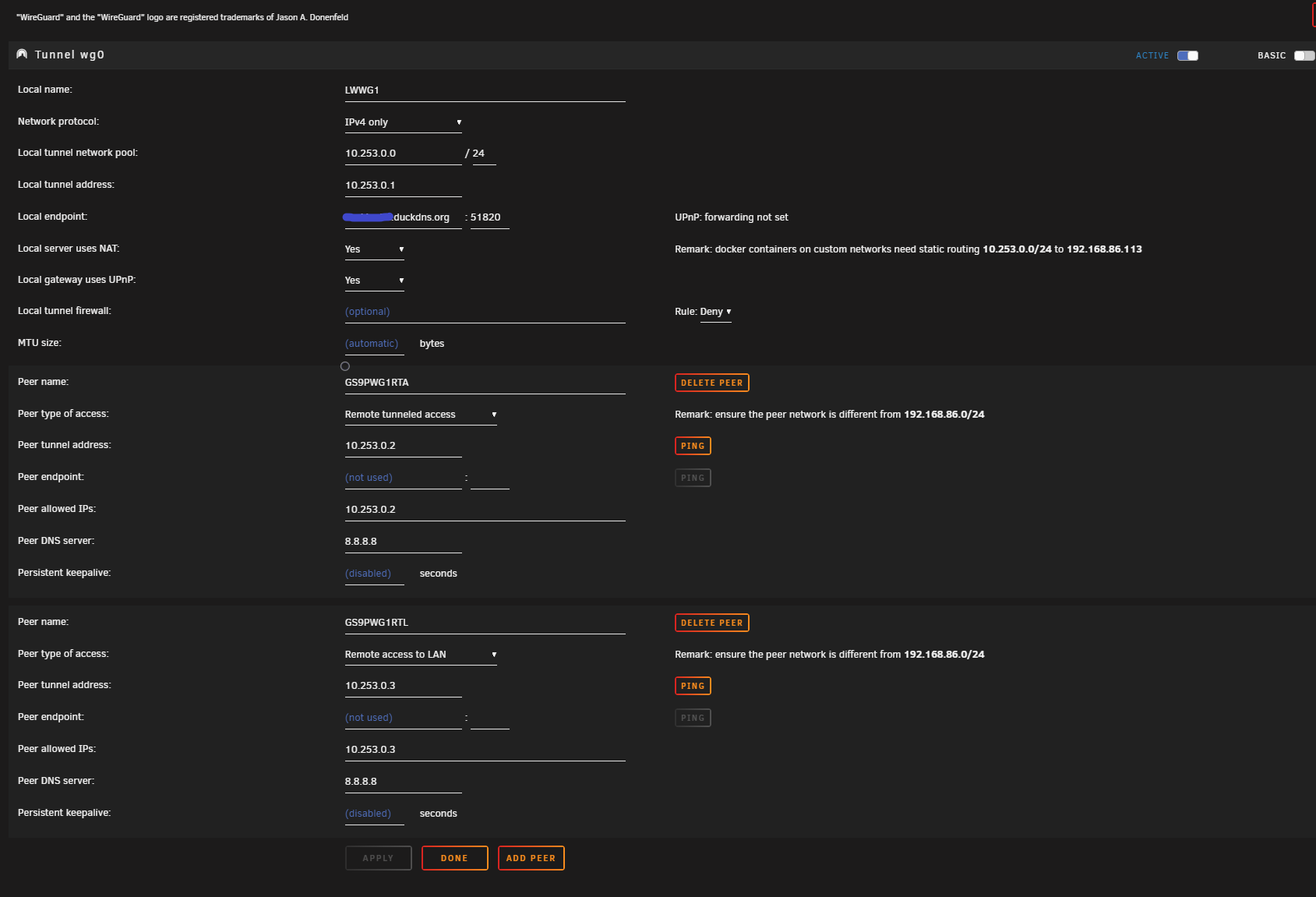

Here are the settings I've tried: (I did confirm the DuckDNS forwarding on their website is correct as well)
Obviously, the 3 comments I'm seeing in the settings page:
UPnP: forwarding not set
Remark: docker containers on custom networks need static routing 10.253.0.0/24 to 192.168.86.113
Remark: ensure the peer network is different from 192.168.86.0/24
-UPnP: I've set it to on, I'm not sure if there is more to do.
-Static Routing: with NAT set to NO and no Dockers with custom networks, this shouldn't be an issue.
-Peer network. I think I have this correct, since LAN is 192.168.86.x and WireGuard Network will be on 10.253.0.x.
It seems worth adding that when testing from WITHIN my local intranet, connecting over WireGuard, that the functionality seems appropriate for both of the above 2 situations, Remote Tunnel Access or Remote to Lan. But when using an outside IP origin I seem to have the problem. The Wireguard app does successfully connects on both Windows and Android, but then I cannot connect to anything on Local Intranet or Internet.
