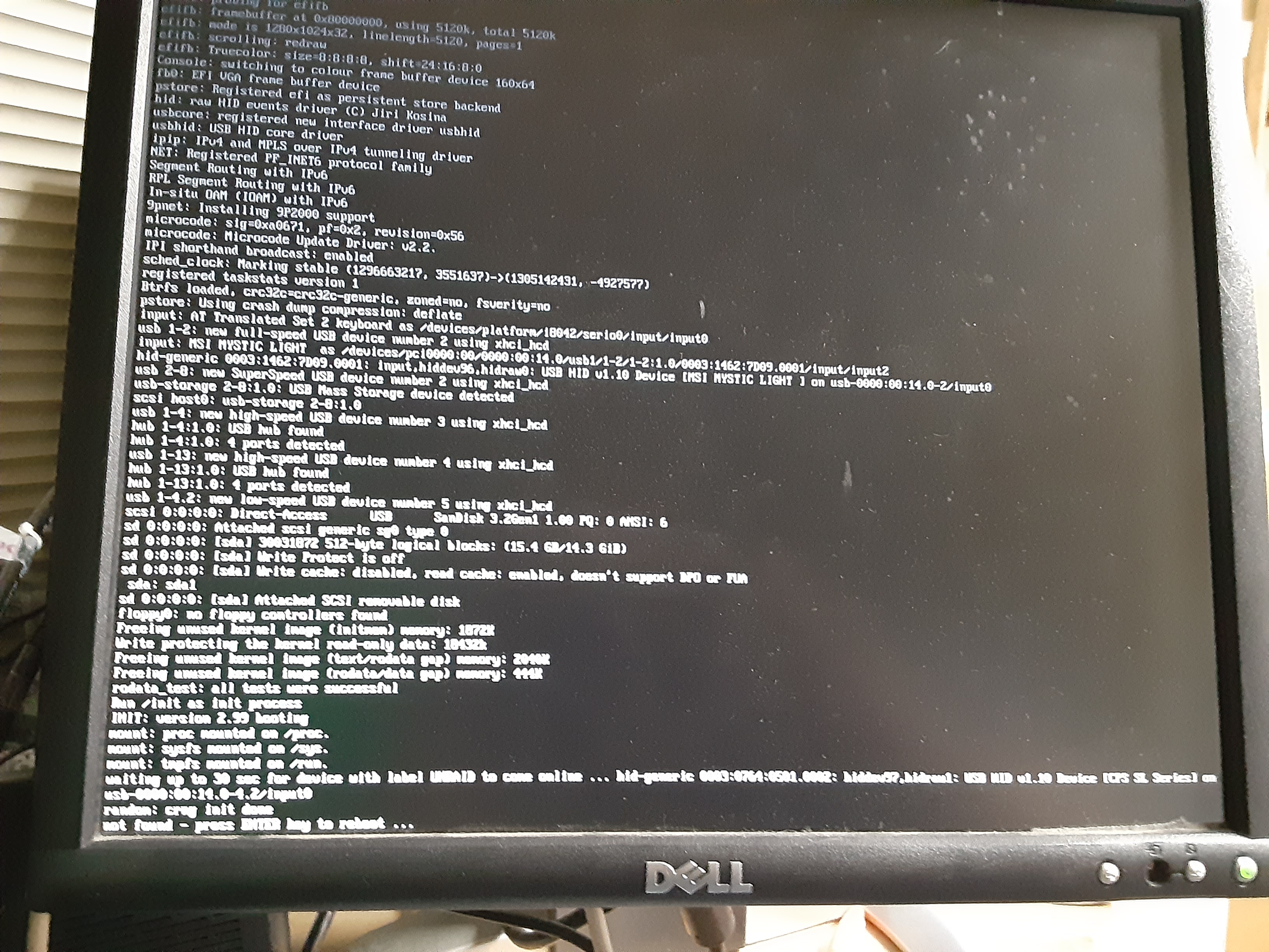

I tried to do upgrade from 6.11.5 to 6.12.2, Same problem
* Tried capturing log to flash drive.
* Upgrade – OK, Boot – OK
* Runs for a while, then just disappears (no GUI access, no data access, not in active IP list).
* Concerning the log on flash – after crash, powered down unRAID, put flash in PC, no SYSLOG file.
* Did “safe to remove” USB from PC
* Put back in unRAID, kept failing in boot (after “waiting up to 30 sec for device with label UNRAID to come online . . .”  or after next line of “random: crug init done” (not sure of spelling))
* Powered down unRAID, put USB back in PC, did quick format and then recovered USB from ZIP backup.
* Booted up to 6.11.5 OK
* Let run for a bit, no issue.
* Set up syslog to FLASH, to a share on this unRAID, and to a share on another unRAID.
* Tried upgrade again: upgrade OK, boot OK
* Ran for a while – eventually noticed on dashboard that CPU cores were intermittently maxing out even though nothing was going on with server.  Eventually it froze/disappeared again.
* Powered down, put USB in PC, SYSLOG file was corrupt (unable to view nor copy), Windows said problem w drive.
* Did Windows scan & repair to USB drive, able to copy SYSLOG.
* Put back in unRAID server – boot failed (same place as earlier).
* Put back in PC, did full format and recovered from ZIP backup.
* Booted up fine to 6.11.5
Attached:
* Syslog-from flash after WIN repair to USB (from flash on problem server)
* Syslog to share on problem server – failed, NO FILE, NO ATTACHMENT.
* Syslog-192.168.50.13 – problem server’s log mirrored to other server
* one image of boot failure - not really worried about this since seems unrelated but attaching in case anyone is curious.
syslog-from flash after WIN repair to USB.txt syslog-192.168.50.13.log
