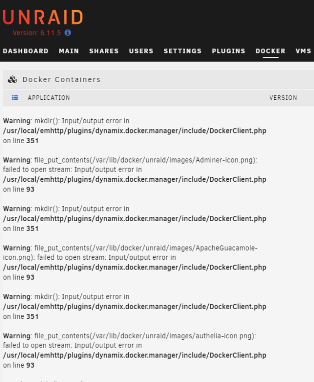

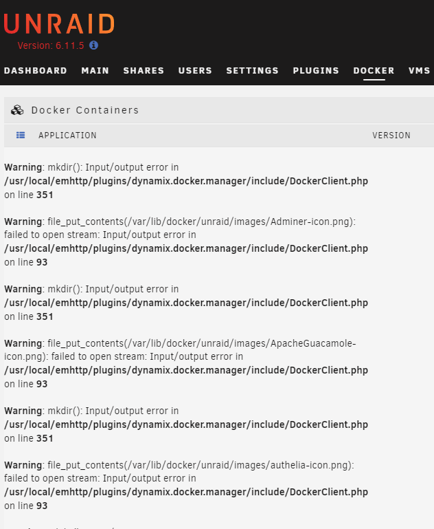

Welp the downgrade did not go well now I'm stuck with a slew of `DockerClient.php` errors on my Docker Page...
And if I try to disable and then re-enable the Docker service I'm greeted with a "Docker Service failed to start" error requiring a reboot . . .
Edited by CajunCoding
