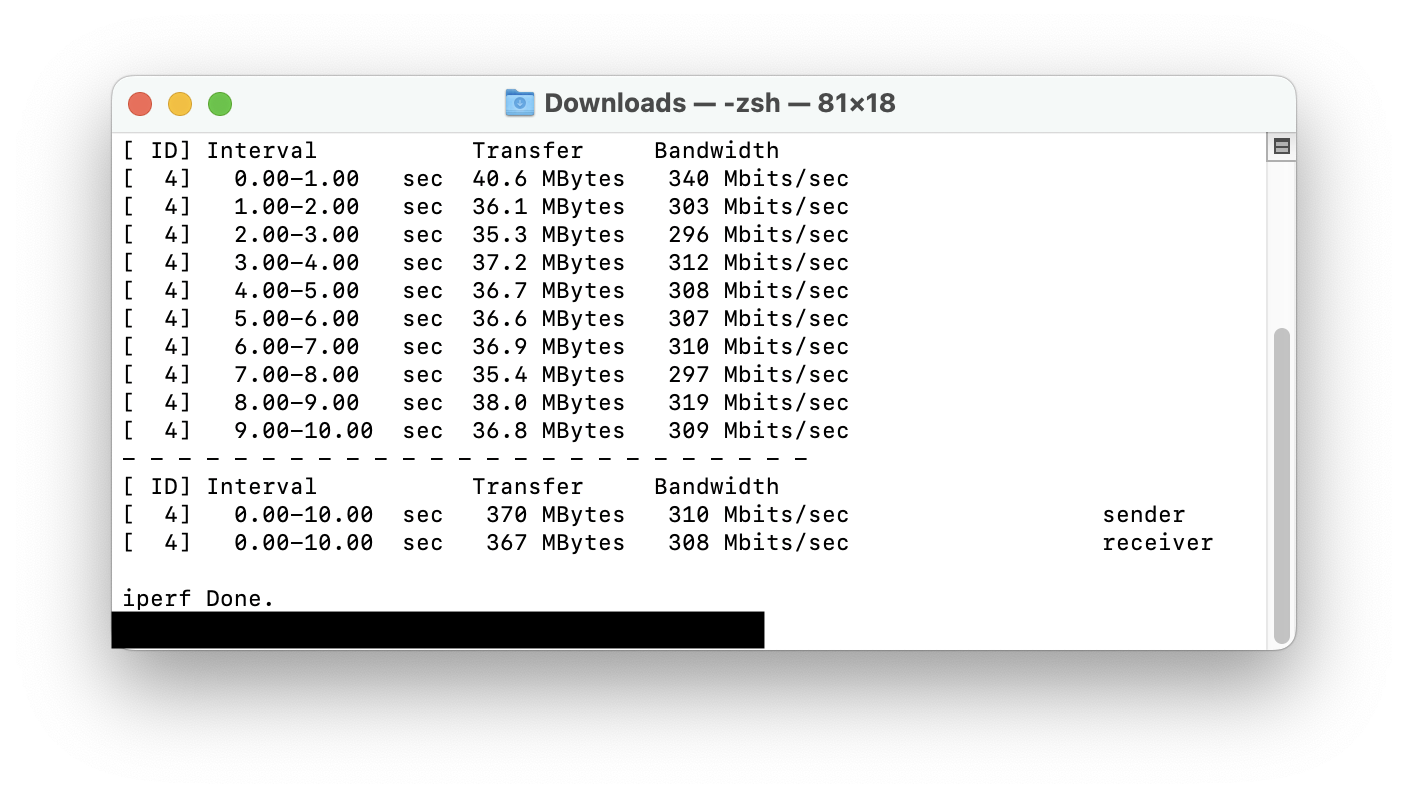

Doing and iperf test it also shows 35-40 MB/s.

Iperf only tests the LAN bandwidth, so you need to fix that first, first thing to try would be redoing the test with a single NIC without any bond, if the same could be NICs (and NIC driver/settings), cables, switch, client PC, etc.
@JorgeB Thank you for your reply.
It seems that it is a network set up issue.
Connecting directly to the managed L2+ switch , I managed to get 110MB/s.

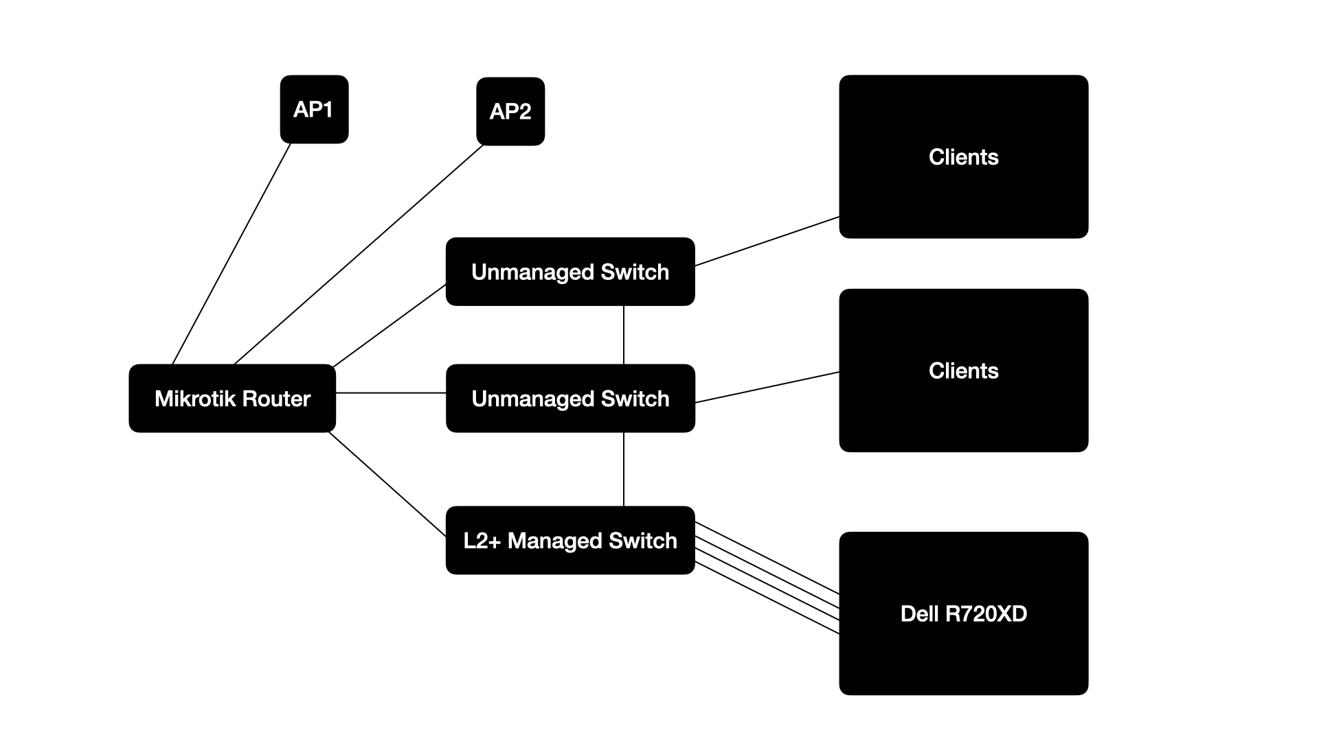

As its a network issue i've included the network setup. If you have any pointers as to where i might be going wrong.
Most of our connections are CAT6 and some CAT5E (Showing as 1000M connection on switch) to the Client computers.
Connections between components are CAT6 and showing as 1000M.

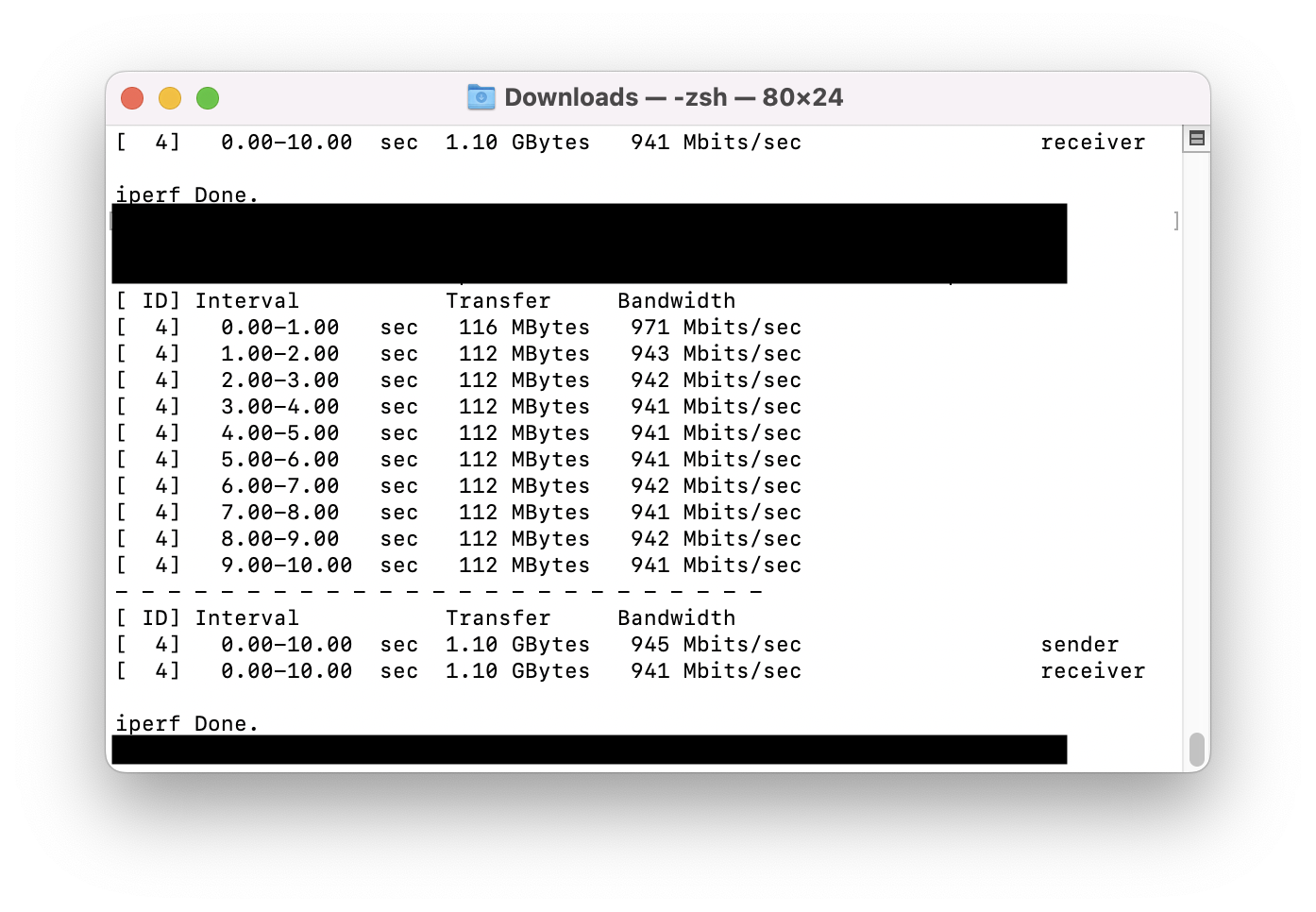

So I found one culprit which is I use my mac with a thunderbolt connection to my monitor which has a LAN port. Although this is a 1000M connection, it seems like the throughput is not as high. Hence the 35-40MB/s speed. Using iperf with the sam LAN cable connected to a thunderbolt dock and then connected to my mac gives the full 118MB/s.
Thank you for all your help.
