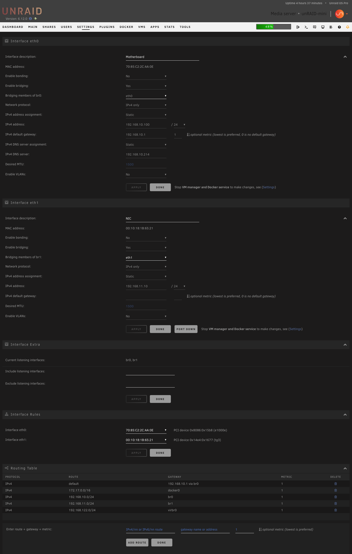

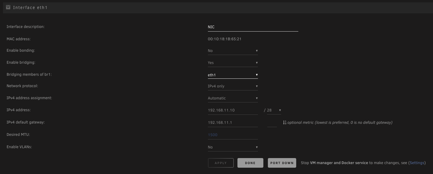

July 3, 20233 yr I've just added a (working) NIC to my server to function at eth1, however after setting up and installing dockers on br1 i realised nothing on the network has internet access. I can ping from outside the network inward and from inside the network to other local IPs, however i am not able to get access out of the network. After a quick google i found results saying i needed to keep the gateway for eth1 blank in network settings, which i thin did, however no luck with outward access. Settings are as below. Would really appreciate some pointers here as i've been at this for hours with no luck. Thanks. Edited July 9, 20233 yr by Rich

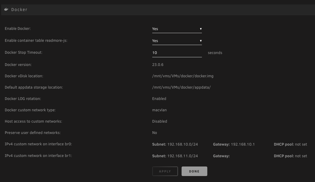

July 3, 20233 yr Author Thanks for the reply. I'm confused at why other posts say the gateway should be empty? Also i have a UDM Pro setup with multiple subnets, the two in question are visible in the screenshots above. I started with the gateway populated and still no internet access for the dockers. I have triple tested that a laptop on the new subnet can access the internet, which it can, so it doesn't appear to be an issue with UDM Pro network settings.
July 4, 20233 yr Author Tried again with and without a gateway for eth1 and still no luck. What am I missing?

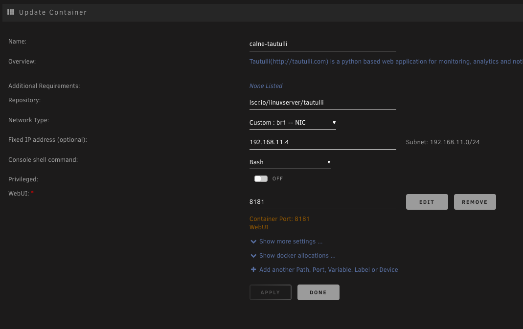

July 4, 20233 yr Author For clarity, what i am trying to do it add a NIC to the server, set it up as eth1 and then set 5ish dockers to use br1 so they can use the NIC to access a separate network and get internet access via the that network / eth1/br1. Is that actually possible? The settings i have currently are as pictured. From the Docker console, for a docker on eth0/br0 i can ping it's gateway and 1.1.1.1. For a docker on eth1/br1, with the pictured settings, i cannot ping it's gateway but can ping 1.1.1.1. Really appreciate any help provided.
July 4, 20233 yr Author Ok, so i can now ping the gateway and 1.1.1.1 from the docker console connected to the NIC. What isn't working is pinging an address, e.g. google.com, which points towards a DNS problem. Is that likely, as i'd read that eth1 should use the DNS settings from eth0?
July 4, 20233 yr Author If i run, docker network ls and then, docker network inspect xxxxxx on the bridge, none of the eth1 dockers appear in the list. Assuming this is why the dockers aren't getting DNS?

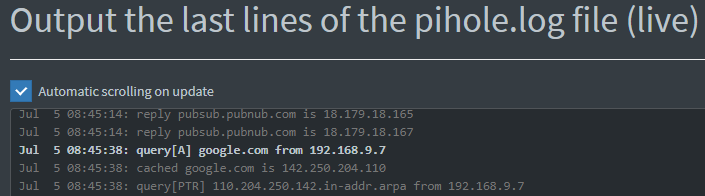

July 4, 20233 yr 6 hours ago, Rich said: Ok, so i can now ping the gateway and 1.1.1.1 from the docker console That's great. 6 hours ago, Rich said: What isn't working is pinging an address, e.g. google.com, which points towards a DNS problem. It should use Unraid setting DNS, so docker at br1 won't reach your DNS 192.168.10.214. For example, one of my Unraid config use local DNS ( Pihole ), check the docker ( 192.168.9.7 ) will use that too. Edited July 5, 20233 yr by Vr2Io
