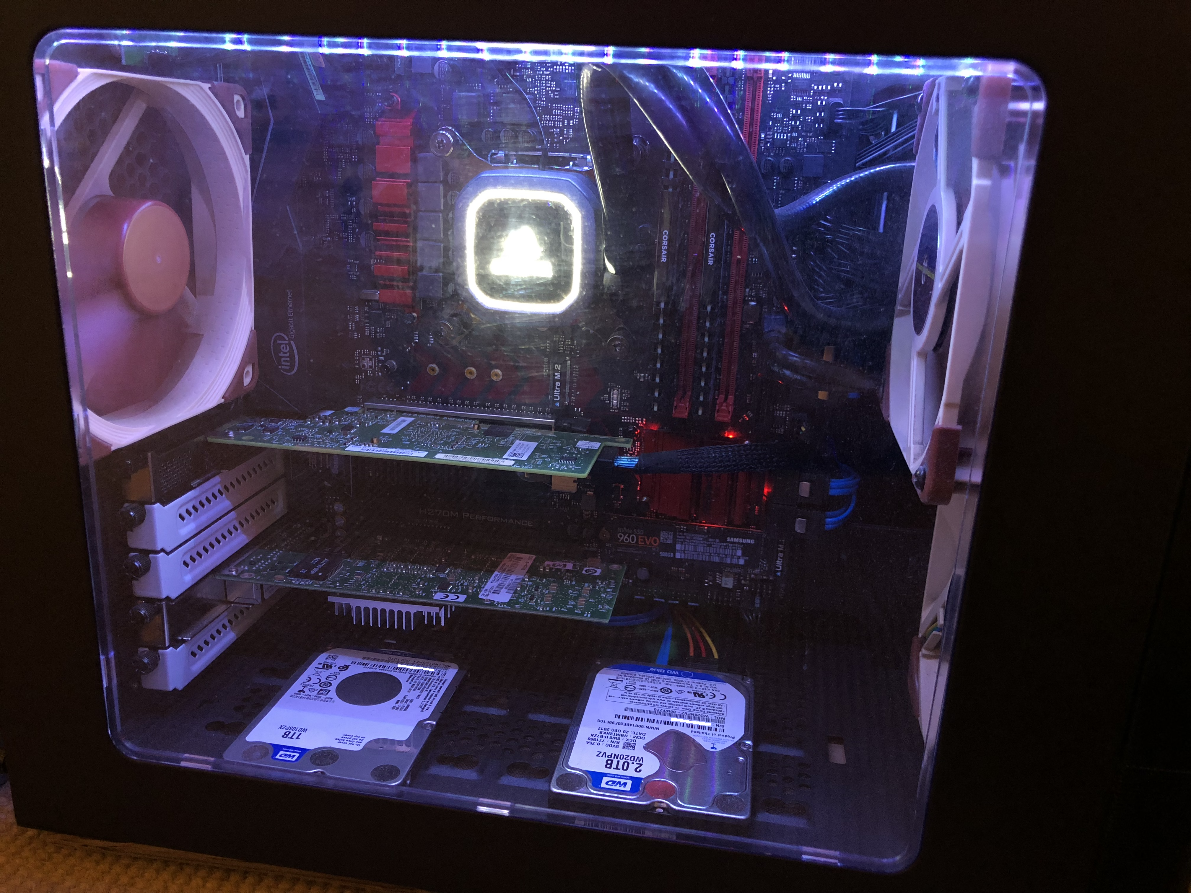

  7. For clarity, what i am trying to do it add a NIC to the server, set it up as eth1 and then set 5ish dockers to use br1 so they can use the NIC to access a separate network and get internet access via the that network / eth1/br1. Is that actually possible? The settings i have currently are as pictured. From the Docker console, for a docker on eth0/br0 i can ping it's gateway and 1.1.1.1. For a docker on eth1/br1, with the pictured settings, i cannot ping it's gateway but can ping 1.1.1.1. Really appreciate any help provided.

  10. I've just added a (working) NIC to my server to function at eth1, however after setting up and installing dockers on br1 i realised nothing on the network has internet access. I can ping from outside the network inward and from inside the network to other local IPs, however i am not able to get access out of the network. After a quick google i found results saying i needed to keep the gateway for eth1 blank in network settings, which i thin did, however no luck with outward access. Settings are as below. Would really appreciate some pointers here as i've been at this for hours with no luck. Thanks.

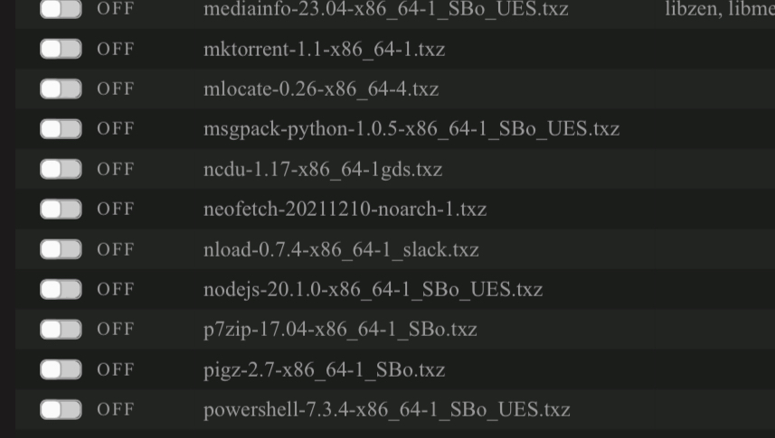

  11. Hi there, is it possible to add netcat to the nerdtools plugin, please?

  13. It doesn’t appear in nerdtools, that’s why I’m installing it via the extra folder, on boot.

  15. Would appreciate some help with this one: I have a bash script that runs, via User Scripts, each time the array is started to turn on a TP-Link smart plug. To get the script working i had to install the netcat pkg, which is now done automatically by placing the txz in flash/extra/. All worked well, however at some point over the last few weeks, the script stopped running and when i manually test i now get this error, nc: error while loading shared libraries: libmd.so.0: cannot open shared object file: No such file or directory I have seen a previous post HERE where a similar issue was fixed, but my understanding of Linux isn't good enough to be able to adapt the fix, if possible? Can anyone give me some pointers? Thank you.
